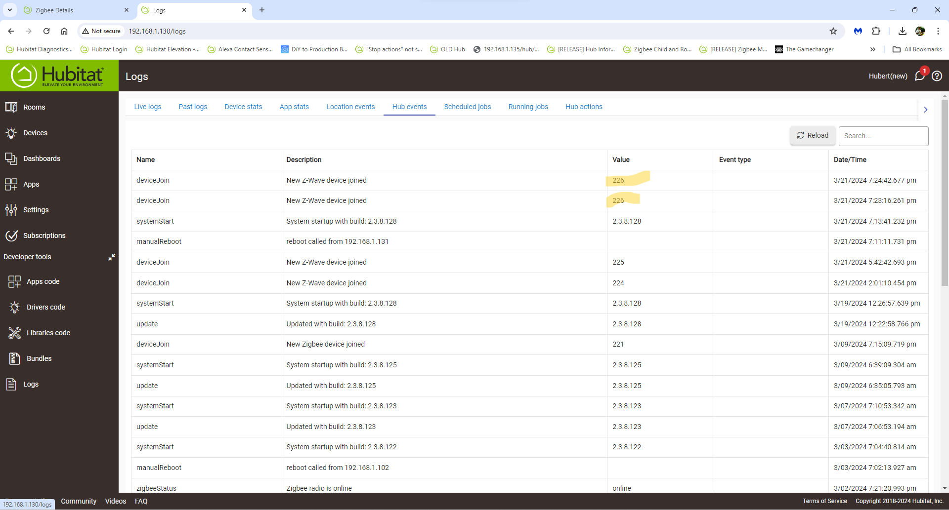

Dont know if maybe I created a ghost. I tried installing at a building appx 80' from my house and did not appear to join so I moved in closer and did again. Everything is working.

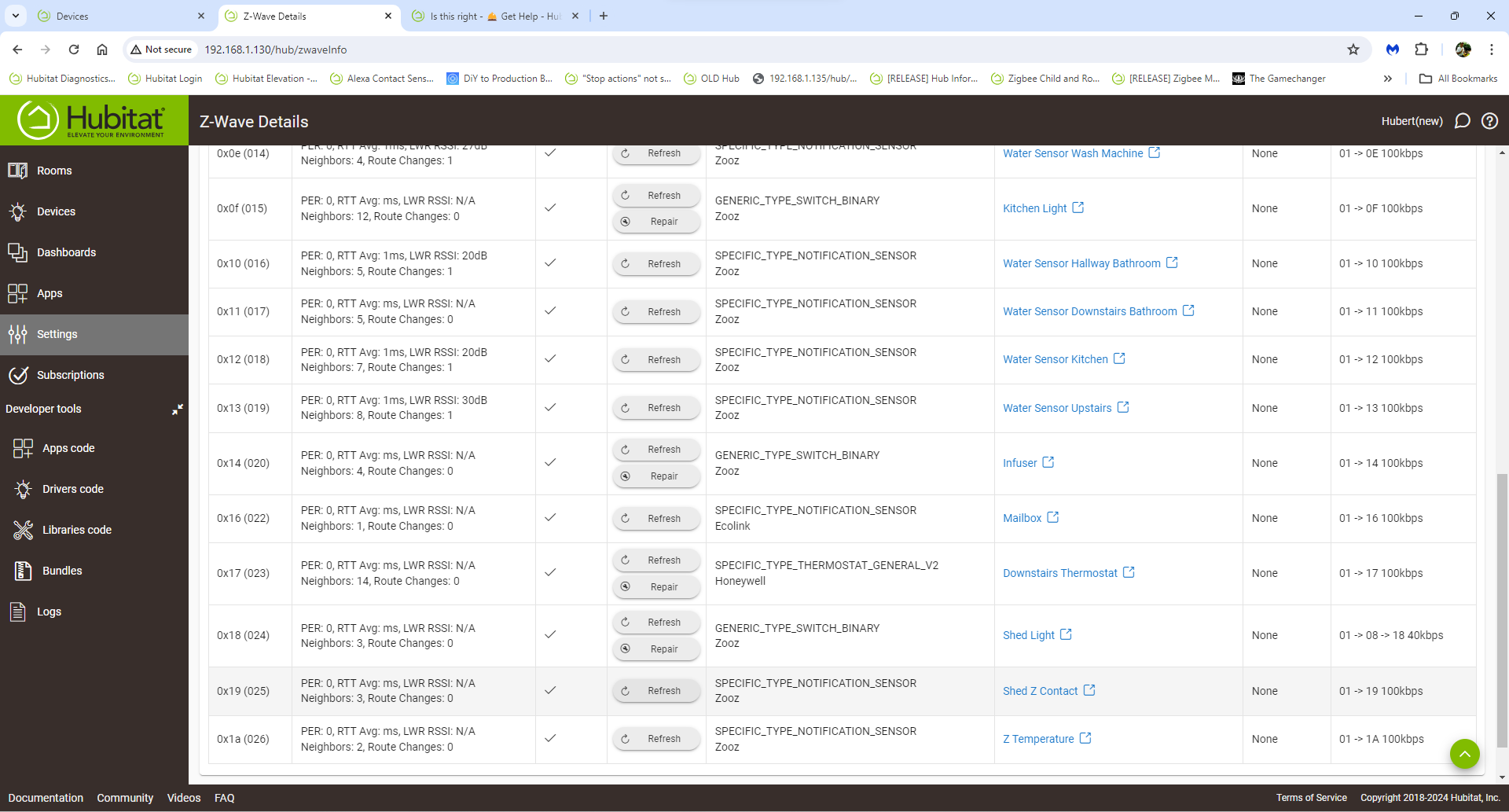

What does your ZWave Details page look like?
It looks OK @thebearmay
Don’t see anything that looks suspicious so you are probably alright.
According to the scrollbar in that shot, that only appears to be about half of your ZW table, but if the part we can't see looks like that too (basically no blank fields), then you're probably OK.
That said, any new stuff should be at the bottom of that table anyway. But still verifying the entire table looks good doesn't hurt.
Thanks. I did capture the bottom cause I knew that was where the new stuff was and the top looks the same.
Sometimes a ghost won't show up right away. You might need to reboot and then check your z-wave details page again. If there are blank boxes next to devices, you might have a ghost.
My experience is they mostly only show up after a reboot.
Probably OK, that screenshot is right after update 2.3.8.133 installed this morning
