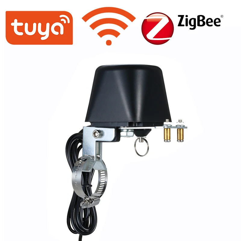

I used this shutoff valve. Zigbee
May I ask what driver you use for this. Very good price.

I use the driver linked below, however it is no longer maintained as the developer is no longer active in the Hubitat community. It may not work if you order one as the chinese mfgs seem to like to change minor details with successive production runs of their devices (IMO to lock you into their hub) . Physically it looks identical but the zigbee firmware could be slightly different enough to render it incompatible with this driver. YMMV
https://raw.githubusercontent.com/markus-li/Hubitat/release/drivers/expanded/zigbee-tuya-valve-expanded.groovy
There is a HE user @kkossev who has been creating drivers for many of the Tuya devices. If you decide to order a valve one and find it doesn't work with the above driver, he may create a driver for you. There are less expensive vendors on Aliexpress for the same product if you do a little searching.
Here is another thread related to the Tuya valves. https://community.hubitat.com/t/tuya-zigbee-water-gas-valve/
I did not use the pipe clamp style mount that came with the valve, it was to flimsy. I opted to install a wooden block & "L" brackets to mount the valve.
