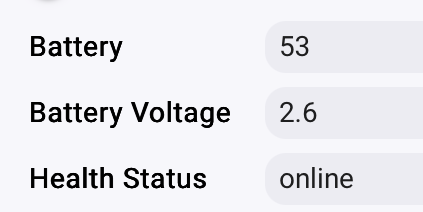

I have just recently started replacing the standard batteries in my sensors with rechargeables and have no real experience with their length of service or the way they warn before they die.
Edit: I do have an eWeLink MS01 motion sensor that has one I replaced a while back that’s still working fine and reporting:
Thanks! I'll be very interested if you can remember to share info on when you have to swap in fresh batteries on the rechargeable 2450s. I don't like having to discard a bunch of used batteries.
