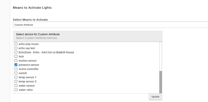

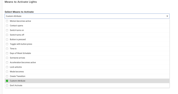

@JBrown's method is a lot simpler but can also use the Room Lighting app. Under "means to activate lights" you can select "custom attribute"
Then select your presence sensor

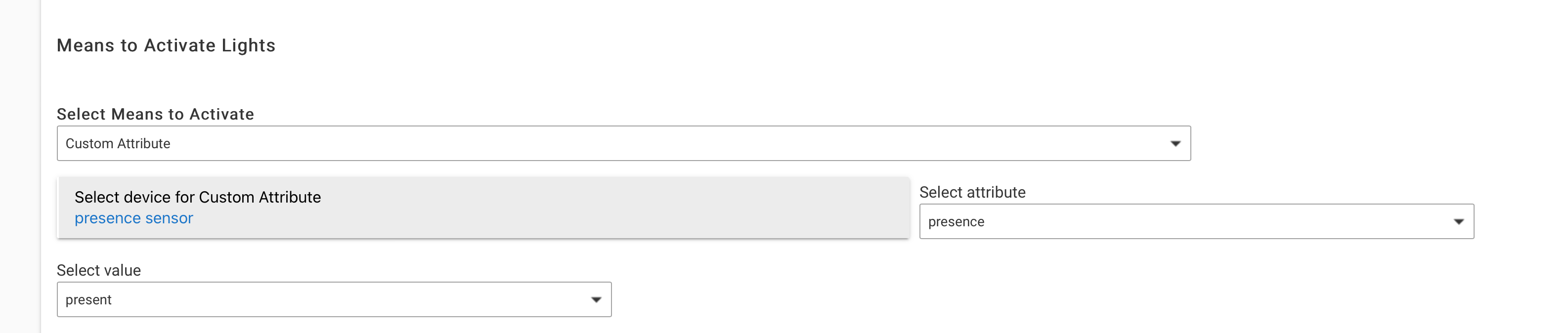

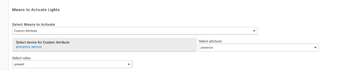

Then select the presence attribute and "present" as the value.
You'll need to do that for turning off the lights too.
