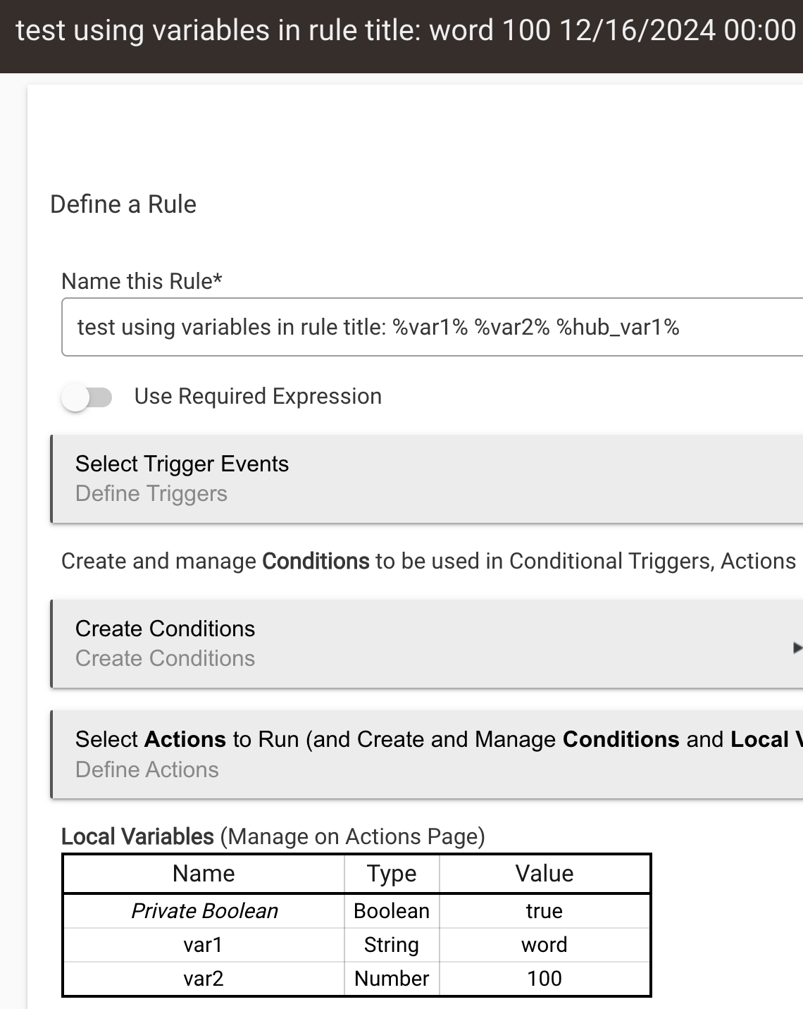

I've done it reasonably often, usually to use the same rule across different hubs. Hub variables are replaceable at import time, just like devices. Combined with judicious use of local variables, rules are pretty easy to recycle/reuse... Little known fact, you can interpolate variables in the rule name to customize it.
I didn’t understand this statement, could you please explain further? Possibly post an example?
I haven't had my second cup of coffee yet... so the permutations of this are coming slow.
Would this mean the Rule name could actually change every time the rule ran if you are changing those within the rule, or even better....be changing AS the rule is running/waiting/delaying etc.
So like this could be a quick way to know a rule is running, or hung, where it's at (cycles, repeats etc.), and basically present a "checkpoint" status if you so desired.
But you'd have to refresh the Rule list to see right?

Interesting… Didn’t know that. I can already see value in this. Thank you for highlighting this!
