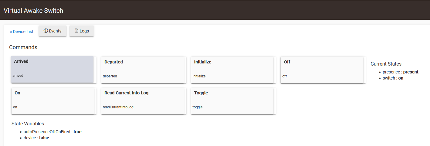

Hubitat has a built in Virtual Presence with Switch driver. You can use that in a dashboard as a switch.
Thats the ticket! This keeps me from having to create separate virtual switches. Thanks!

I modified the virtual presence switch driver and link the on off correctly to the arrived/departed - that solved my need for the same feature.
