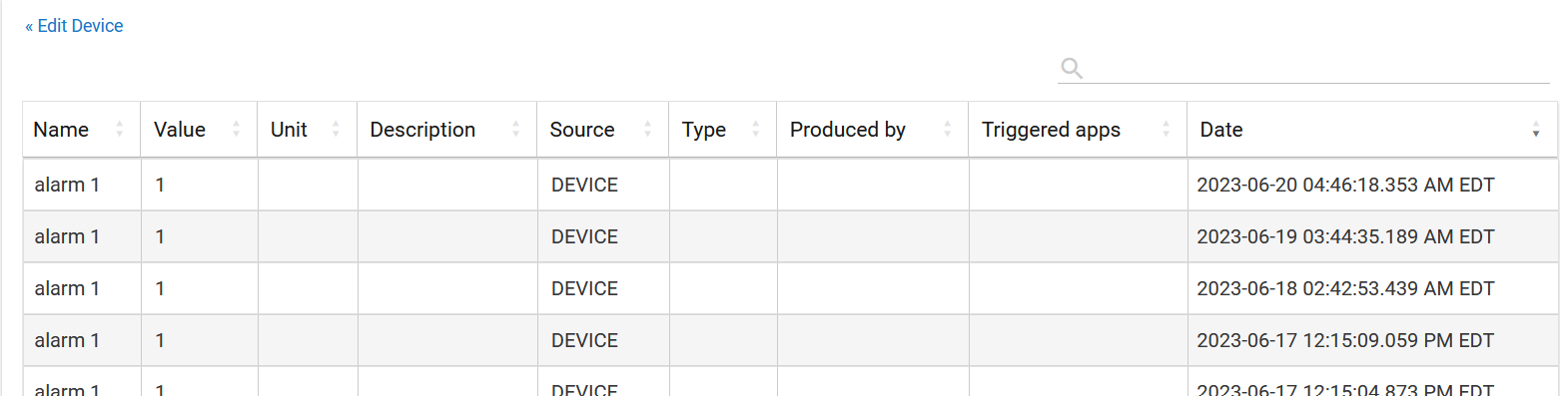

The leak detectors report battery % very poorly, but I noticed a red led blinking and then the alarm on Device Events, so that would be head and shoulders above the lame battery % on that device.

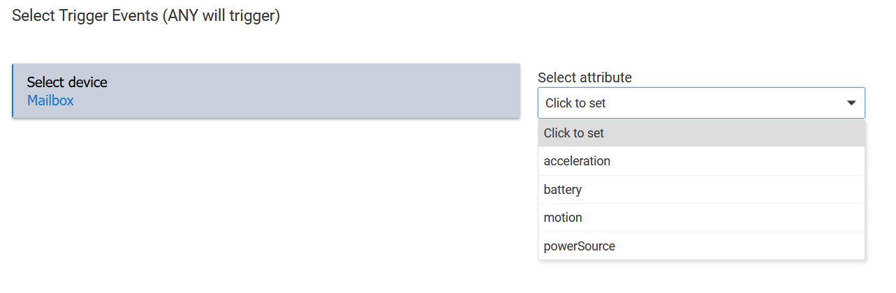

I would have expected an Event to register the attribute on the lft hand side of your screenshot, but that could be the event name vs the attribute name...

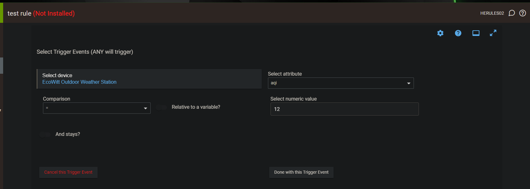

By trigger, I was wondering if you could trigger from a change in the attribute... Let me check what I'm suggesting
This is the kind of thing I was thinking of, assuming AQI is not part of any capability defined in HE and you would replace with your Alarm 1 attribute:
The way I look at it, the Events also include events direct from the device, vs any driver intervention. Question is, how to access this, except for a revised driver?

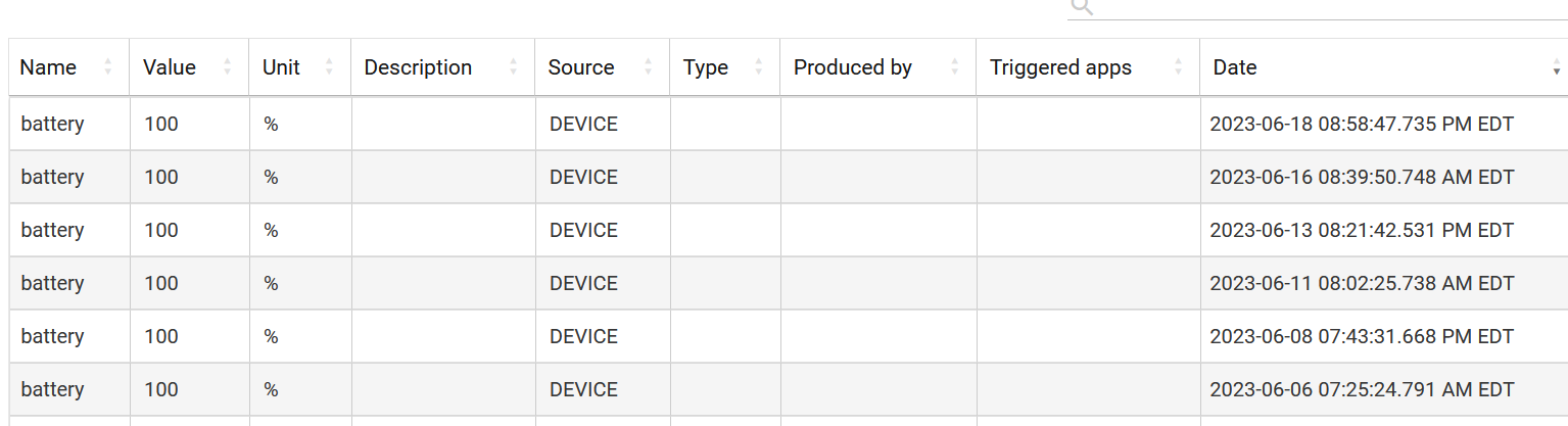

If I go to a similar device that's not alarming yet, I get this. Battery % is available as an attribute, but Alarm 1 isn't. I think it's a matter of the generic device driver not having the capability.
Well close.... I expect, but I could be wrong.... I expect one of the generic capabilities opens up all the attributes, but other capabilities are more specific about the attributes they make available (if that makes any sense).
Yep. I'll come back to that in a minute. I expect you need to make some kind of request to the developer of the driver, either Hubitat or Community, can't say I have paid attention to who you may need to speak to.... Hopefully I'm on the mark with my assessment, but every chance I am wrong...
