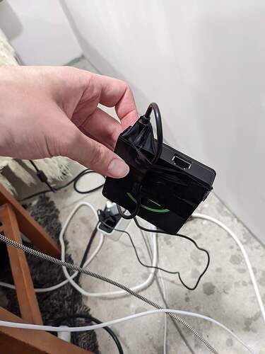

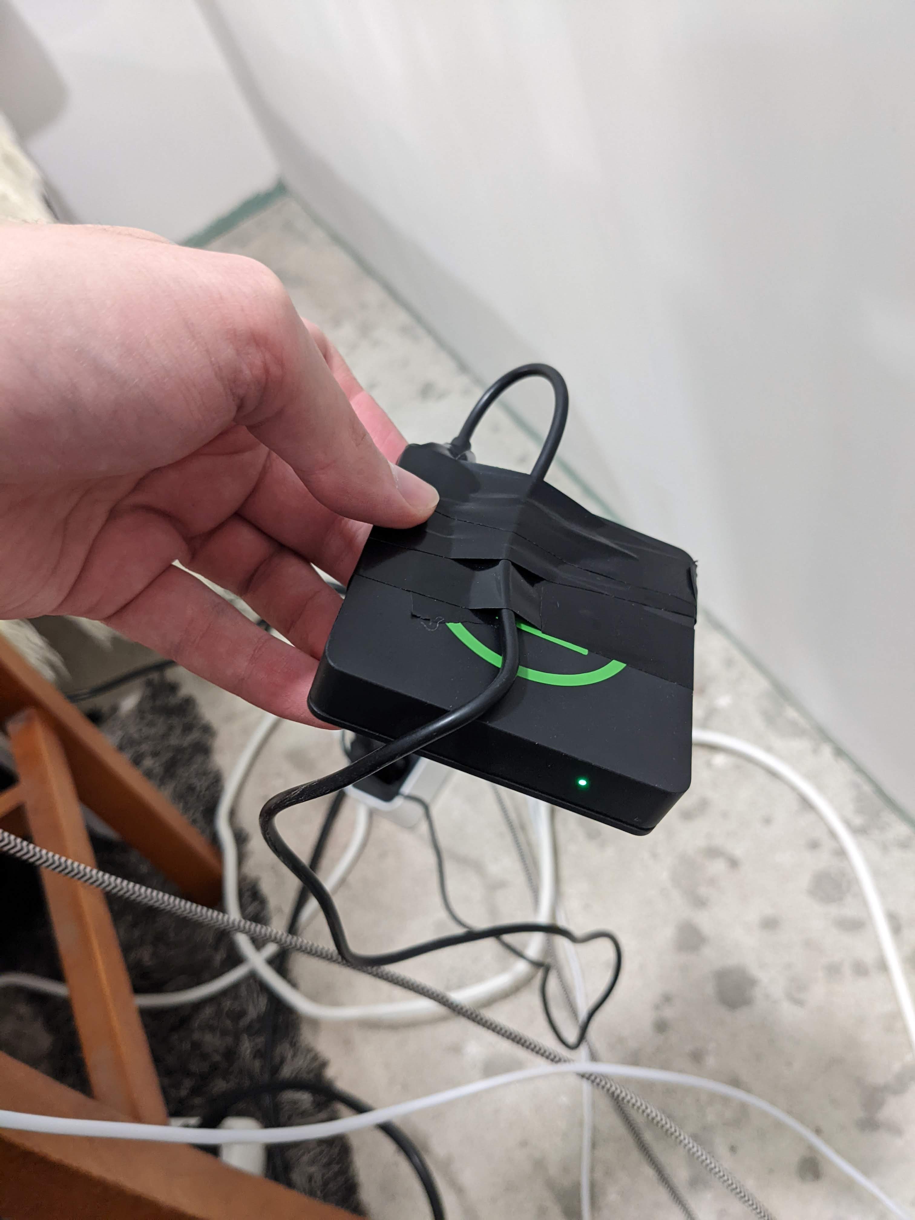

Guys, after reading through the thread again and reading a chat with fellow Bulgarian @kkossev, I decided to do a final desperate try to power on the hub. @kkossev told me in a DM that the hub actually takes a few seconds to boot before the light turns on. I've taken the original power source and cable and decided to give it a shot.
Here is the result:
I don't have Hub Protect, but I assume it will be a good idea to activate the subscription now, backup all of my drivers and apps, and claim the extended warranty, since I don't know for how long the hub will work. Do you reckon that I should do anything else?

Does anyone think, based on the fact that the hub is working under specific cable placement, the problem is in the charging port? If so, is that repairable?
A local backup will do exactly that.
If you have good soldering skills, it is probably repairable.
