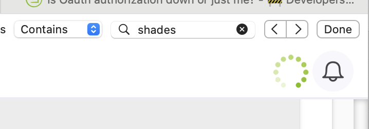

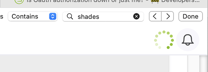

This might have something to do with it? It seems like the devices are showing up slowly. Interestingly I was deleting devices from the connection - so reducing the amount of devices. Anything I can do to avoid this? Thanks.

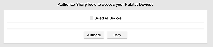

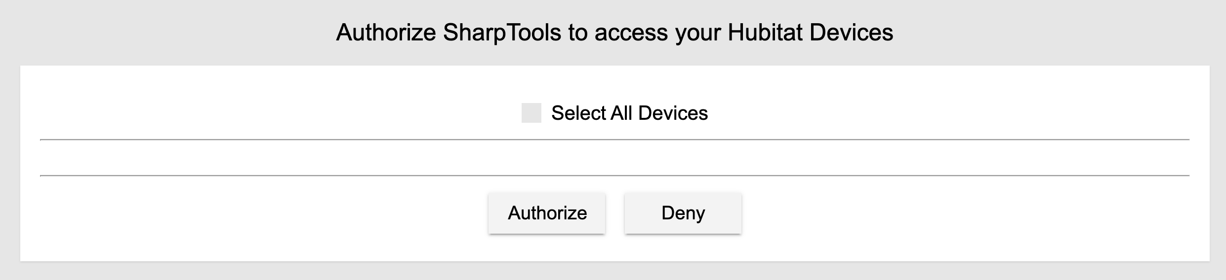

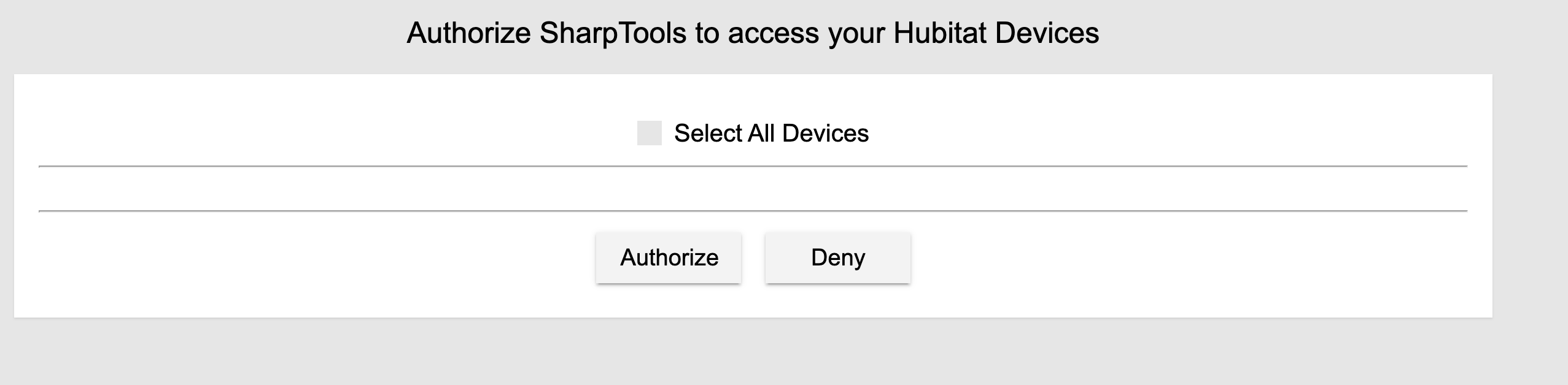

What’s more concerning to me is what you reported in the SharpTools community that when you proceed through the (OAuth) authorization flow, you don’t see the categories or list of devices with checkboxes to authorize.
I have maybe 3-4 similar reports that have come through in the recent week about the OAuth screen being empty with no categories/devices and thus the authorization failing or synchronizing across 0 devices. But I don’t have enough details from these reports yet to see any common patterns between them.
What else has changed recently with your configuration? New hub software version? Hub migration? Major app / driver changes? Etc?
I’m not able to reproduce it on my Hubitat hubs running 2.4.1.177 and 2.4.1.146 and it’s not clear to me if it’s a hub software version or some combination or hardware and software or what is causing the issue.
Do you have other Hubitat hubs and are you able to reproduce it on ALL of the hubs? If not, it might be helpful to note significant differences between them.

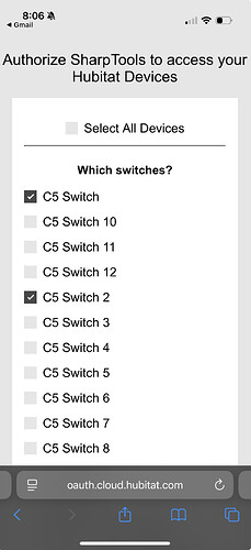

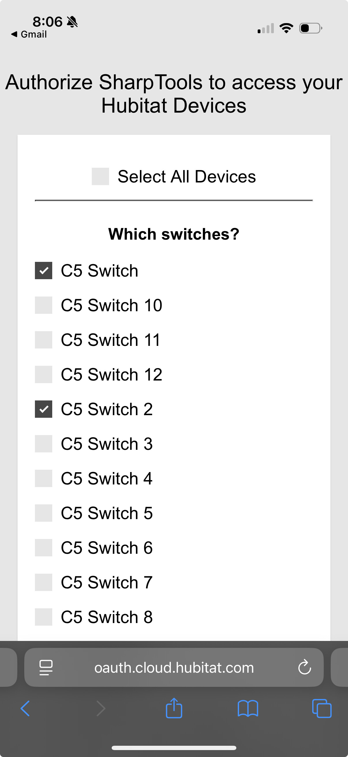

Good (mine):
Bad (yours):

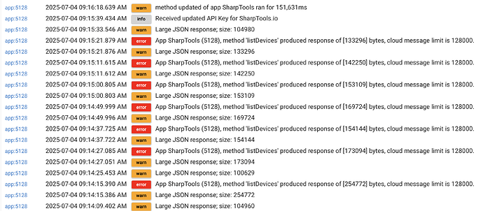

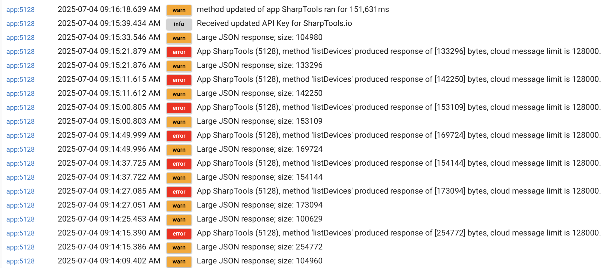

This morning I ran a test and changed a few devices in the Sharptools app on my main Hubitat. I got this. Now this could have been going on for some time and I just didn't notice it.

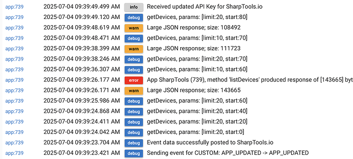

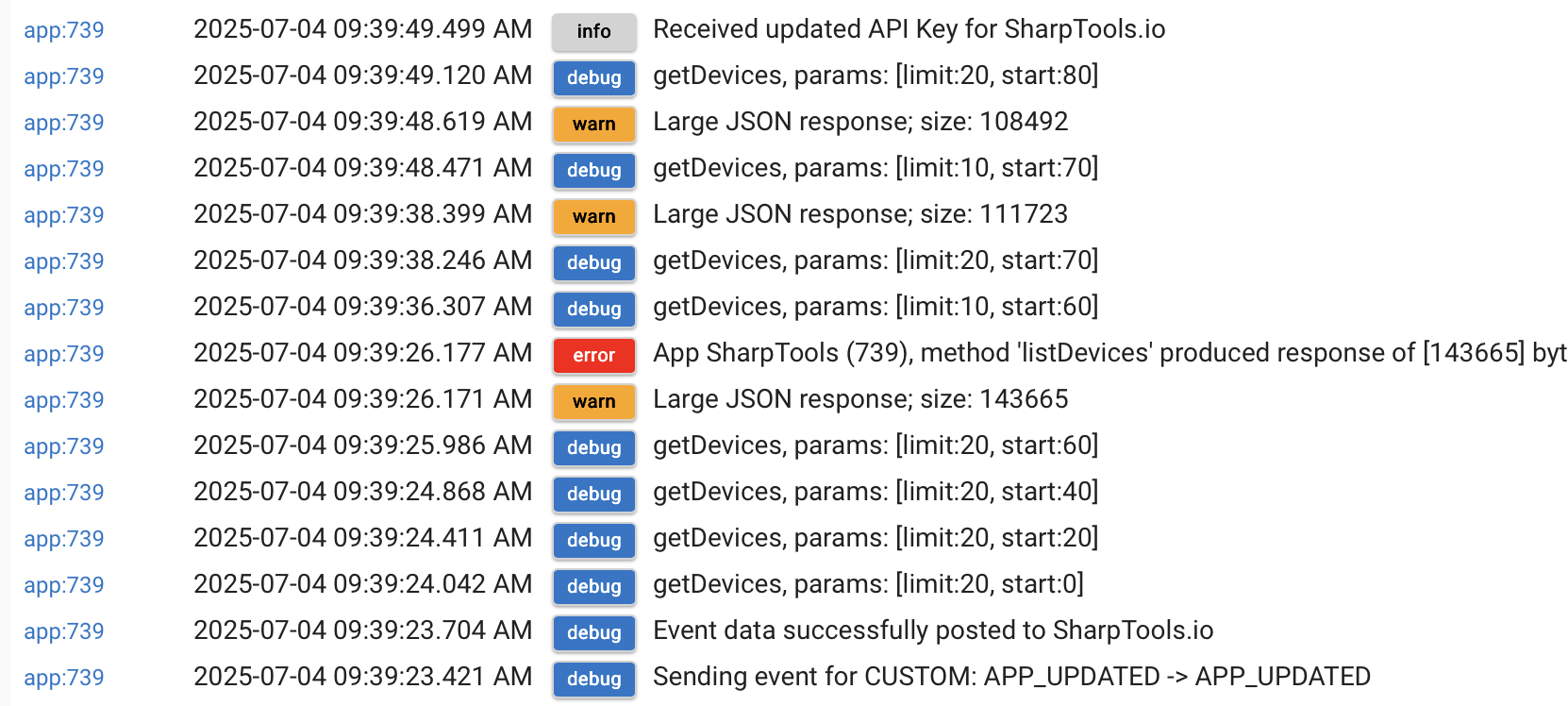

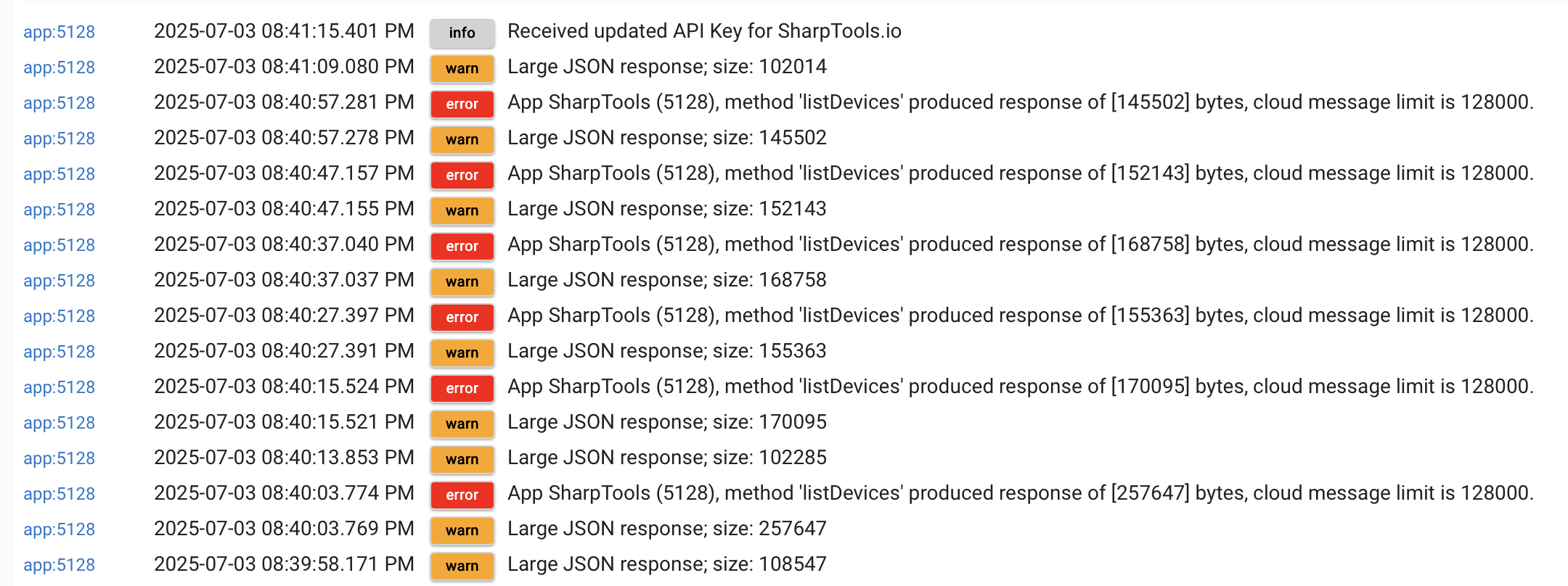

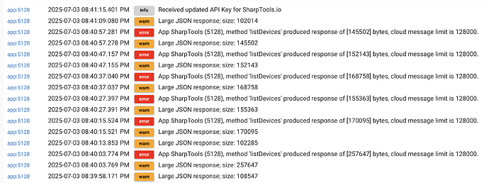

Then I went to the hub with only about 25 devices being shared and turned on logging and got this:

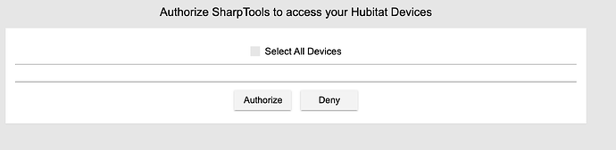

Both hubs are showing this in Sharptools:
Yet the devices are working in Sharptools.

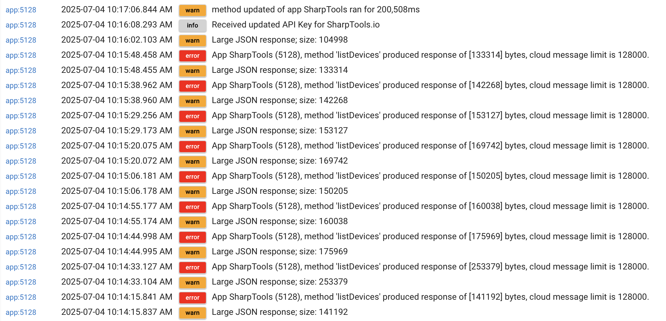

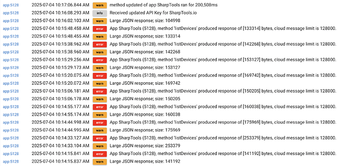

I am continuing to test it. I just added and deleted some new devices. The Sharptools app has been working on it for several minutes now:
Apparently it took about 3 minutes:
Devices updated and are working. Still showing nothing under Manage Connections.
When you get to this screen on either hub, are you just proceeding with the Authorize button or are you going back to the SharpTools App on your Hubitat hub and updating your device selections there?
I'm wondering if this particular issue more of a Hubitat OAuth rendering issue and if you already had the devices selected, then even though the device categories and checkboxes for devices aren't showing up, they're still selected behind the scenes so it's keeping them selected when you tap Authorize to complete the process.

Device Sync: Large JSON / byte size response
The Large JSON response isn't a major concern for me and you can see what it's doing in your screenshot where you enabled the additional logging.
Device Sync Explanation (tap to expand)
During the device sync process, SharpTools gets the details of your devices in batches. From the bottom up, you can see that it:
  • First request at 0 and asks for 20 devices
  • Then the next sets of 20 starting at position 20, then position 40, then position 60
  • At position 60 the app logs a warning that the JSON response might be too big
    • And Hubitat logs its own error showing that it was too big.
  • It retries position 60 with 10 devices instead of 20 as an attempt to get a smaller response and it succeeds
  • So then it continues on starting from position 70 with 20 devices, fails, then retries at position 70 with 10 devices and succeeds
  • It looks like it finishes around position 80 with the final set of 20 devices
The retrying during a device sync isn't a major concern since it's able to recover automatically. The most common cause of this is using a community driver that stores a significant amount of data in the device 'state'.
You could try to narrow down which devices are contributing to the issue through some trial-and-error of unchecking big blocks of devices (perhaps with similar drivers) and see if you still get the warnings and errors about JSON / byte size.
If it's your custom Bond drivers, you could try reducing the verbosity of the attribute state in the driver and try storing that information elsewhere to avoid bloating the device state.
The device sync process will retry the batches all the way down to a batch size of 1 device and if it's a single device that is too big to sync across, it will ultimately skip that device. Of course, having to retry the batches during the sync will slow the process down but it sounds like it's still ultimately completing for you.

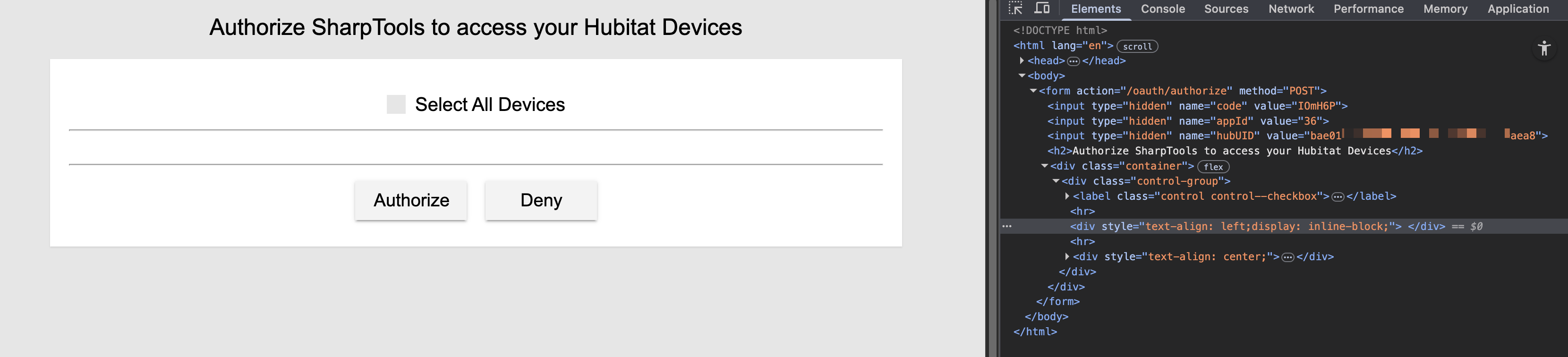

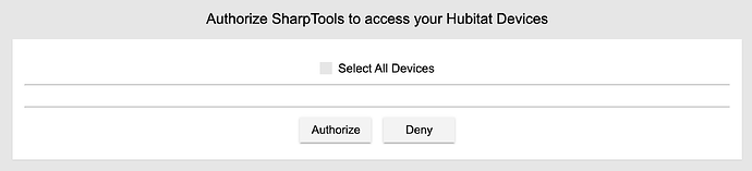

After upgrading from 2.4.1.146 to 2.4.2.126, I am able to reproduce the issue:
There doesn't seem to be anything logged in the browser console and based on the network requests and a comparison against my other working test hub, it looks like the content of this page is rendered server-side... so hopefully Victor or Bobby from Hubitat are able to pull some logs or share some insights.
Edit: Interestingly, this does not seem to impact the OAuth flow for IFTTT, Google Home, or Alexa which just use a single generic Which Devices? / Select Devices category.
