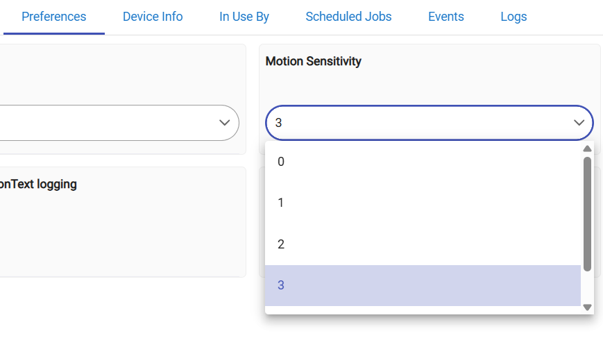

I have two Ring motion sensors outside. I'm trying to determine the values of the motion sensitivity by changing it in preferences, then monitoring the events. But with numerous false alarms this gets tedious.
Is it possible to view the device driver code for this motion sensor, in hopes of determining the motion sensitivity values?

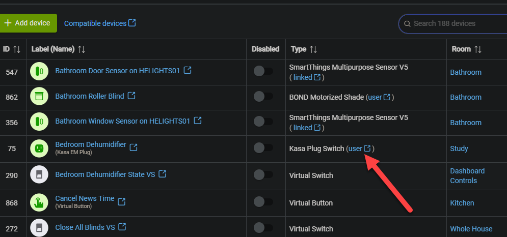

There are also a couple of ways to see if a device is user (Community) developed or part of the platform, one is on the device listing page, devices using user developed drivers will have this link next to them to the driver code, whereas those like the virtual switches do not.

It adjusts parameter 8 with the literal values 0-4 that you can select. Apparently it's unclear what this actually does, as there is a mismatch between the published device manual and the data the Z-Wave Alliance has:
