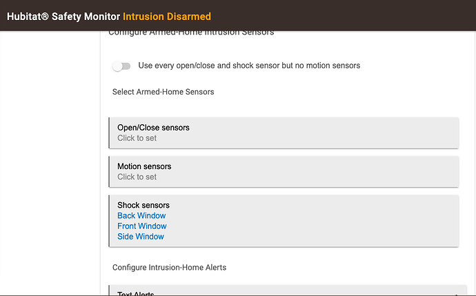

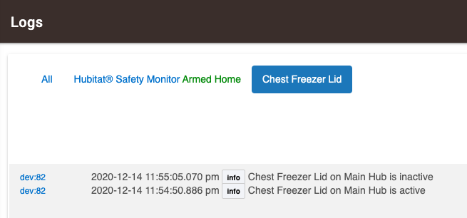

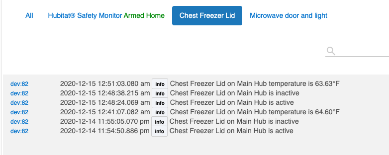

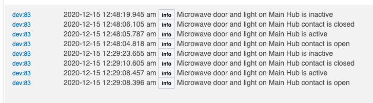

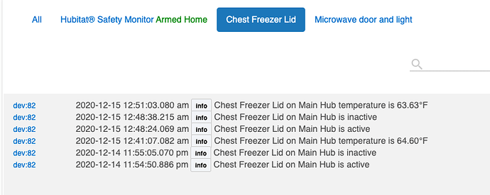

Unless I'm misunderstanding something, you can do this pretty easily. The biggest issue might just be false alarms from any vibration. I tested this by banging on the chest freezer lid that has a ST v5 multisensor on it. Worked fine.

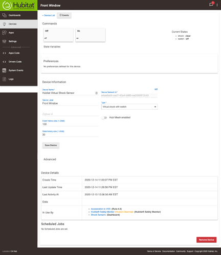

I use this simple bit of code all the time and just change the device capability for what I need. Switch changes, the device changes and vice versa.
metadata {
	definition (name: "Virtual shock with switch", namespace: "logname", author: "smarthomeprimer") {
		capability "Sensor"
		capability "ShockSensor"
        capability "Switch"
def on() {
    sendEvent(name: "shock", value: "detected")
    sendEvent(name: "switch", value: "on")
//    runIn(10, off)
def off() {
    sendEvent(name: "shock", value: "clear")
    sendEvent(name: "switch", value: "off")
def installed() {

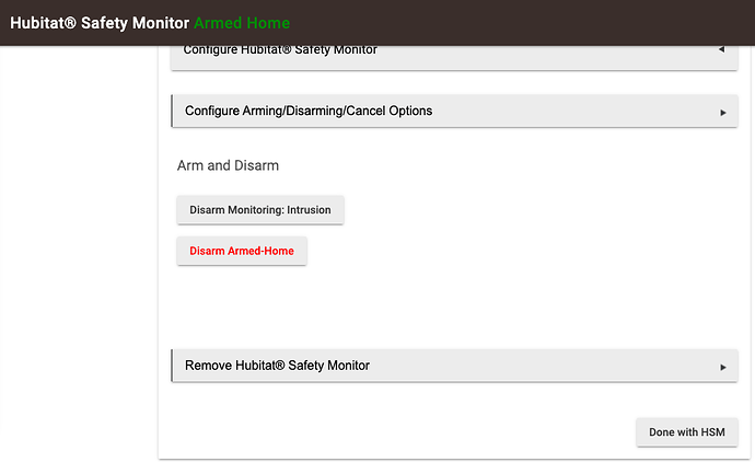

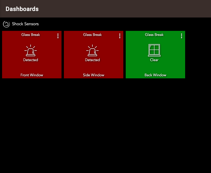

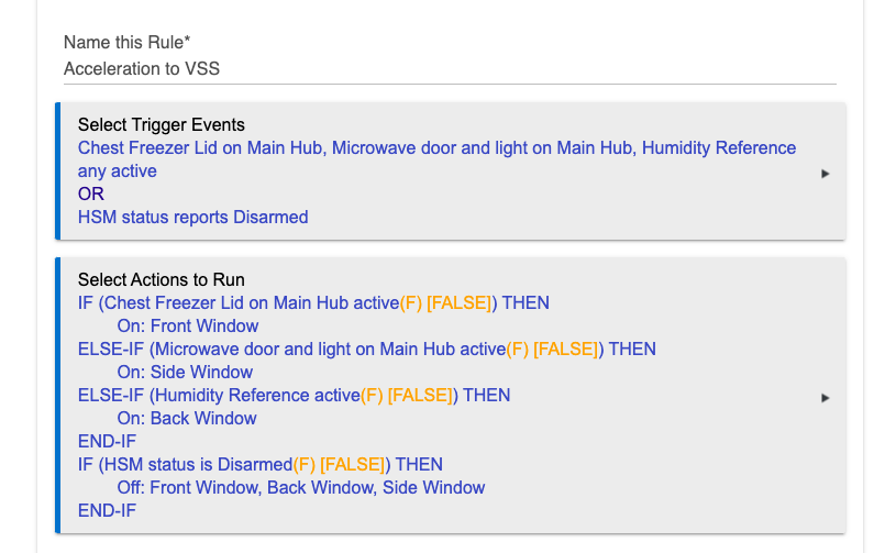

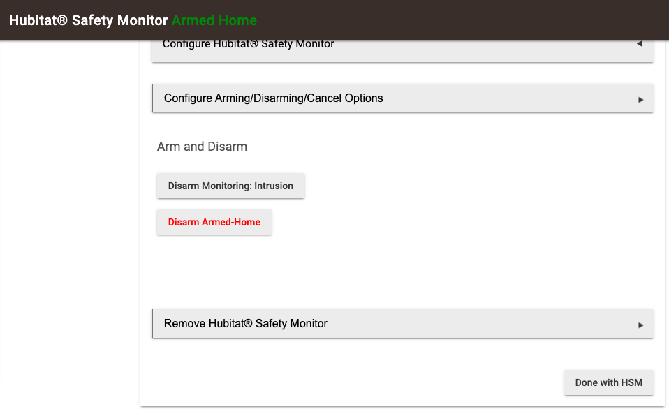

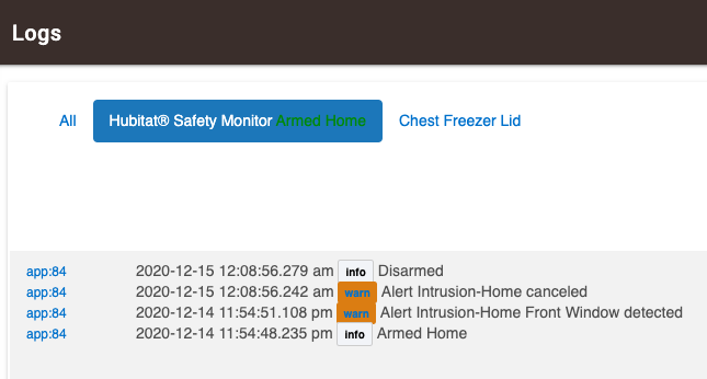

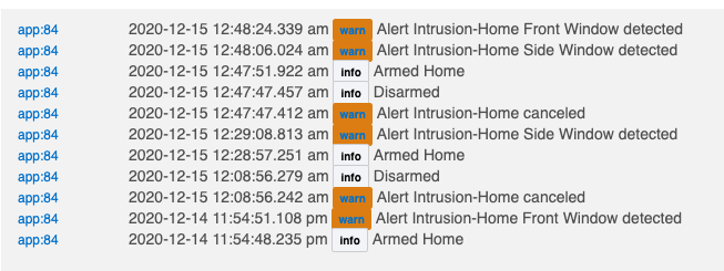

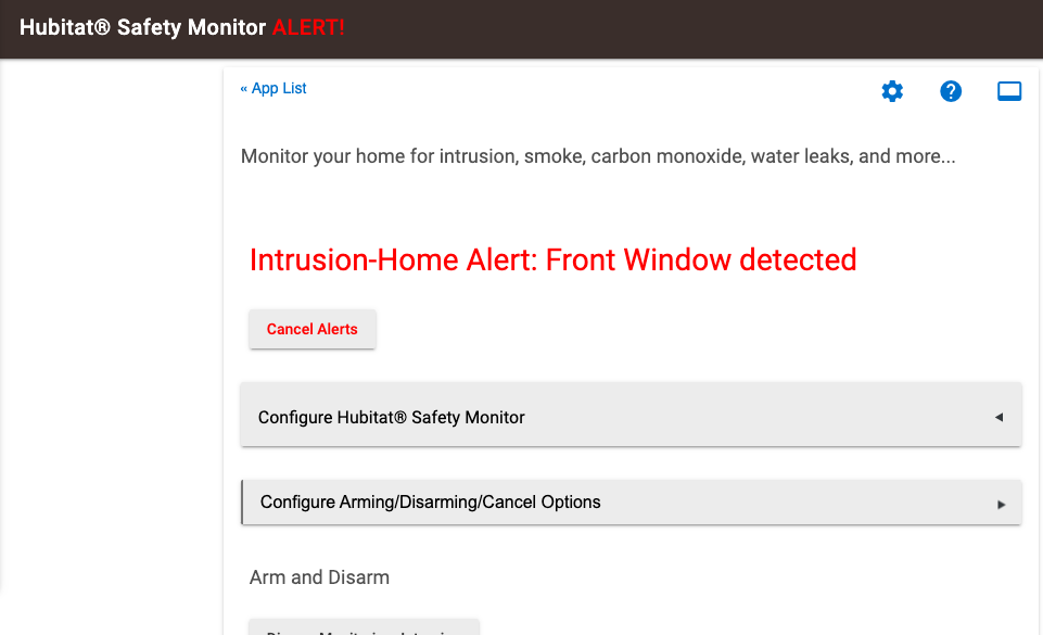

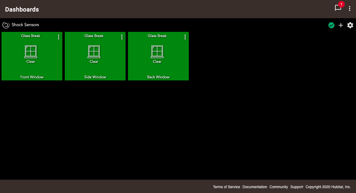

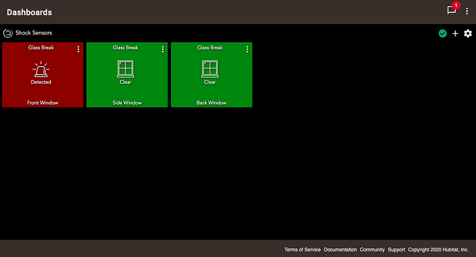

You just need to create one virtual device for each acceleration sensor. One rule will handle it. Disarming HSM resets the virtual sensors.
Screen Shot 2020-12-15 at 12.15.14 AM Screen Shot 2020-12-15 at 12.15.02 AM

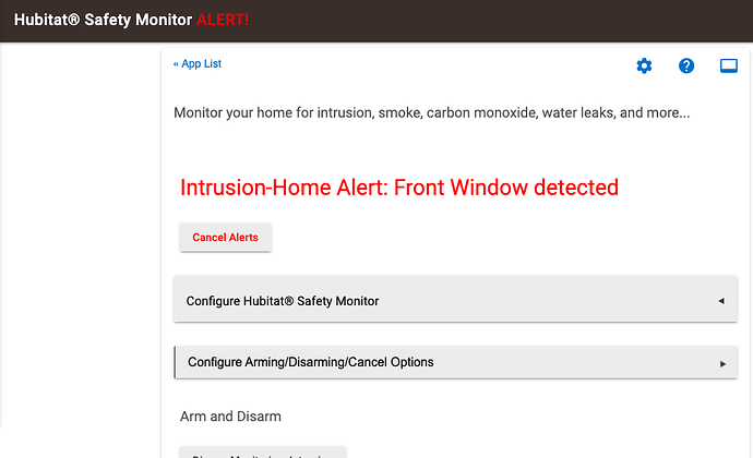

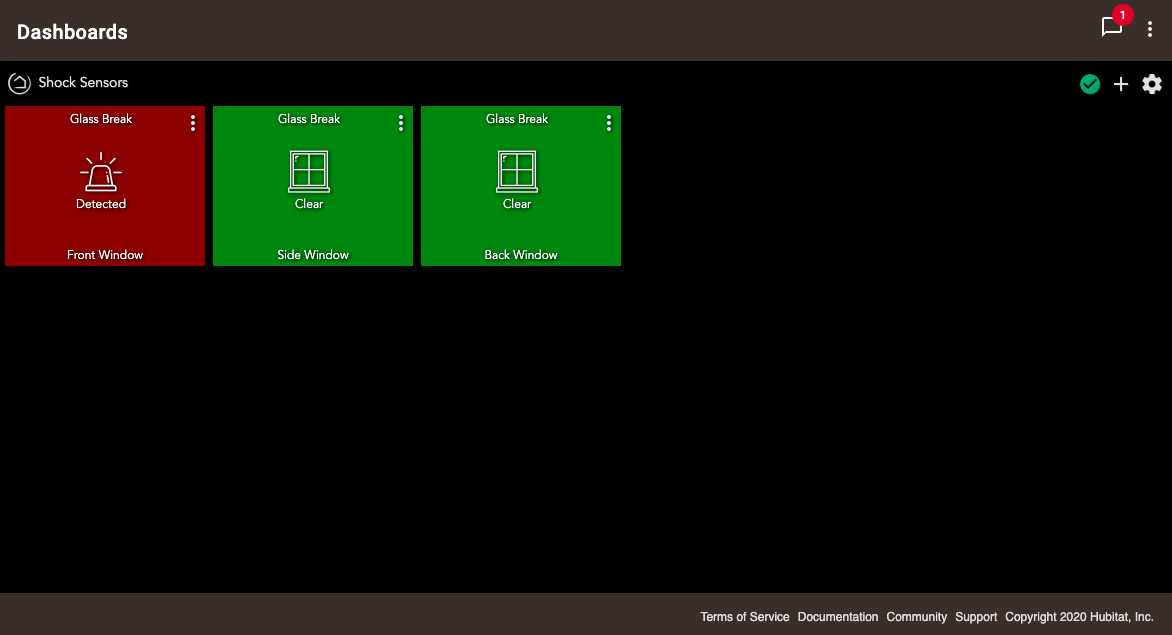

For the life of me, I cannot figure out how that would be important, other than to see later (which you will in the logs, but you could easily add logging to the rule). However, as long as HSM is armed, it will trigger any of them. Doesn't matter if one was triggered already.
Screen Shot 2020-12-15 at 12.52.46 AM
