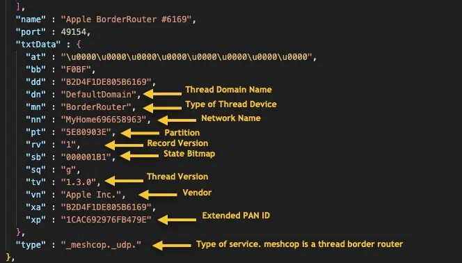

Both my Echo Show 10 and AppleTV are at tv=v1.3.0. I never added my Matter devices to the Echo device, so I did that now. I guess it's "wait and see" if they negotiate to the same "nn".
EDIT: Ohwait... strike that. I just read the post above mentioning that amazon does not play nicely (or at all) with others at this time...
Not a concern. Ignore the fact that the nn= label references "nest" -- it doesn't really tell you which OTBR is in control (its just that the nest label was the one that stuck after the merge). The border routers dynamically select which one has the best connection and will adjust over time

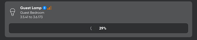

Just finished updating my three bulbs.
Other than the Nanoleaf app not indicating that the bulbs were already "Connected to Matter", it went smoothly.
Now just have to wait and see if my one bulb that is farthest from my TBR will behave better.
I believe TBR V1.3 is a necessary, but NOT entirely sufficient requirement for things to join the same Thread fabic - Even having all TBRs @ V1.3, doesn't resolve the credential sharing issues, as I understand it. - Specifically, see: Why Thread is Matter’s biggest problem right now - The Verge
From this article:
  1. To form this shared mesh, border routers have to be using the [Thread 1.3.0](Thread 1.3.0 makes Thread border routers Matter-ready - The Verge) specification. As of today, most are (Excluding Amazon).
  2. Next, these border routers have to share credentials with each other — similar to using a password to join a Wi-Fi network
The #2 is the problem part, and an CAN work, if you run the device inclusion from a IOS device, with both Google Home installed, as both TBR can (and do) access the same IOS keychain for the credentials, but I don't think this works from an Android device, as there is not Apple Home application that doesn't run on IOS - From the same article:
*Google’s tells me that “Apple and Google Thread border routers can share the same Thread network by leveraging the iOS Thread network APIs.” So, you could have a Google Nest Hub Max and an Apple TV join a single Thread network if you set them both up using an iOS device. *
However, the same is not true in reverse because an Android phone can’t access the iOS keychain, and there is no Android app that will set up a HomePod or Apple TV (and probably will never be).
My matter network (including HE) is all using the Apple _meshcop._udp nn= entry (the TBR is a HomePod mini - Seems to work fine from HomeKit and Hubitat) - I'm going to try and "force" my Google Nest Hub to join (which I've never really used with matter yet), by loading the Google Home app on an IOS device that's part of the matter network - I've just never tried to factor the Google Nest hub into this, and it's clearly off on it's on TBR fabic at this point (per the mDNS entries for the Google Hub and Apple HomePod mini - Both are showing up as TBRs under _meshcop._udp, but they have different nn= entries (and have both been active for months - So waiting a day, didn't solve this)
Bottom line, I think Thread V1.3 requirement is part of it, and Amazon is clearly totally out of this with V1.1 - But as I understand it, V1.3 doesn't completely resolve credential sharing, and it's still being worked on, given all the combination of different TBRs (SmartThings, NanoLeaf, etc.)
Again, @jvm33 thanks for the great mDNS pointers to "Discovery" and "Flame"
And I know this has been referenced before, and it's somewhat HA focused, but see the sections on Multicast and Discovery for what some of the JSON elements of the DNS TXT record actually mean, and how to understand the various IP6 addressing that's going on:
Part three of his documents goes into mDNS and Ubiquity network tips and suggestions (along with lots of HA stuff which doesn't likely mean much to this audience)
All are updated and seem to be working well and stable. Thank you for the tip~ One thing I have noticed (and it is entirely possible it been happening since I'm not in the Nanoloeaf app often), is my devices seem to oscillate between thread and Bluetooth.
Do you know will using the app for scenes still tends to cause the bulb to drop out of HomeKit? We did like using the Blaze scene in our bedroom at night. I see the scene imported to HomeKit, but if you sect one, they all select and it doesnt actually do anything at the bulb.

I've been searching for this comment for a while to thank you! That March update did indeed dramatically improve these bulbs. No longer randomly dropping offline, etc. I had to replace one bulb that just dies the other day, and I noticed after I commissioned it, not only did it have the usual firmware update, but the other existing bulbs also picked up a new update. Seems there must have been something else released since the March update.
All my Nanoleaf essential bulbs are on firmware 3.6.173 which I think is the latest (I'm also subscribed to the Beta channel for Nanoleaf and nothing more shows up). But agree - they do work much better under 3.6.173 / Matter 1.2.
I'll have to look when i get home. I had updated the older bulbs when you posted above, it made a world of difference. When i got the new bulb this week it had an update. When I did that update, then the other two triggered for a new update.
They sent me an email about joining the Beta program. I said I wanted to and filled out the questionnaire, but never heard anything else since.
I think there 2 different beta programs.
The first one is where they send you a survey is for completely new devices, and you may or may not be added to that after doing the survey (I completed it, but no further response).
The second "beta" is a simpler sign-up for beta firmware, not entirely new products. You access that through the Nanoleaf cloud portal: Nanoleaf Developers Forum , and go to your "My Account" -> "My Devices" section and you should see a list of devices, and can then enroll for beta firmware updates. But, again, 3.6.173 is the latest and that is already public.
Getting another firmware update for the essentials bulbs this morning.
