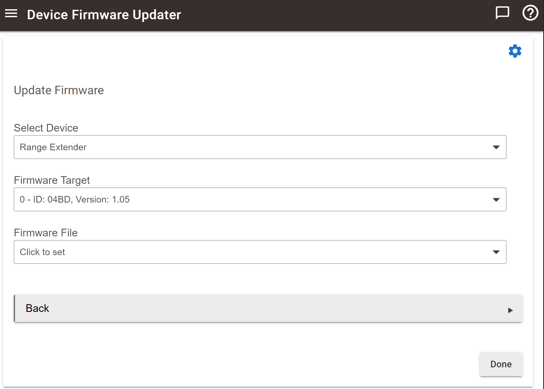

If you use the "Device Firmware Updater" from the "Add Built-in Apps". Select the Aeotec Range Extender 7 device (you can do this before uploading any firmware) and choose the target from the pull-down. This will show the firmware verson on the device. See attached picture where my device shows version 1.05.
I am running 2.3.0.124 and I have never successfully been able to use OTA update with any device paired with S2 security. To update the RE7, I unpaired it and repaired it with no security. After the OTA update, I unpaired it and repaired it with S2.
If you attempt OTA update with S2 security, the update will fail with: โ€œERROR: The
transferred image does not match the Firmware Targetโ€. You can try with S2, but this is the error you will get.... not just on RE7 devices. I filed a ticket with support on 12/20/21.
