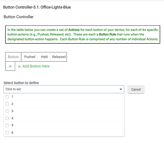

Is Button Controller 5.1 limited to only 6 buttons?
I have been testing the Inovelli Blue mmWave switch and just like their red series z-wave devices button events are generated via paddle actions taping up generates button press events and presses down generates button held events. The also generate a event for the config button which is a press on button 8.
When adding this switch to the button controller and started to map my button actions I notice the drop down for button number only goes to 6. Is button controller hard coded not to go higher than 6?
I tested with rule machine and put in a simple rule for button press 8 from the switch and it responded to it.
Here is the drop down in Button Controller:
BC offers up to 14 for my Blue 2-1s (14 matches the highest # in Inovelli's button map), so BC definitely can go higher than 6.

Those aren't related to your Button Controller problem. That can only be caused by the "numberOfButtons" attribute not being set correctly. Likely, something you did in between (a save or configure?) updated that.

Does it show the expected value for "numberOfButtons" when you have this problem? If not, there is definitely a problem with the driver. An app, like Button Controller, will only know what the device reports this way. I'm not sure where you believe the problem is, so additional information, including this, should help narrow it down!
If you're seeing 14 instead of 28, this typo on line 656 of their driver is a likely cause:
sendEvent(name: "numberOfButtons", value: settings.parmeter23?28:14)
But I don't see anywhere where "23" is actually used in this driver, so maybe 14 is supposed to be it? Are you seeing something else entirely?
Could the misspelling in line 656 there (parmeter) possibly be an issue?
As someone who couldn't code my way out of a wet paper bag, I have no idea :sweat_smile:
Since that setting wouldn't exist, it should evaluate to Groovy false, making the value always 14. (There could be other places in the code that set this too, but this is all I found from a quick look.)
I am seeing 14 as the number of buttons after dong the "save" on the device preference tab. Before I do that it's only 6. If there is 23 don't know where they map to I am just leveraging multi-taps, held, release of the paddle switch and a single press of the config button. All which seems to be account for in the the "14".
14 would jive with the 2-1 driver, as well as Inovelli's own button-mapping outline for (presumably all) Gen3 switches/dimmers.
Do you see any errors in Logs when you add one of these devices? Or does changing line 651 (or wherever this in in your current code) from def configure(option) { to def configure(option=null) { help for new installs? It looks like they are trying to set this value in this method, which should be called on device install -- but they have a mandatory parameter, which is not the standard Hubitat signature, and my guess is that it throws an error. Then, when you do it later from the device detail page, their custom override of this command works from the UI.
In any case, something must be wrong with the driver. This is a possible explanation. Logs should tell you for sure if you can still go back; if not, seeing if the above modification helps is something you could try in the future. But otherwise, a manual "Configure" on any device looks like it should work, too.
