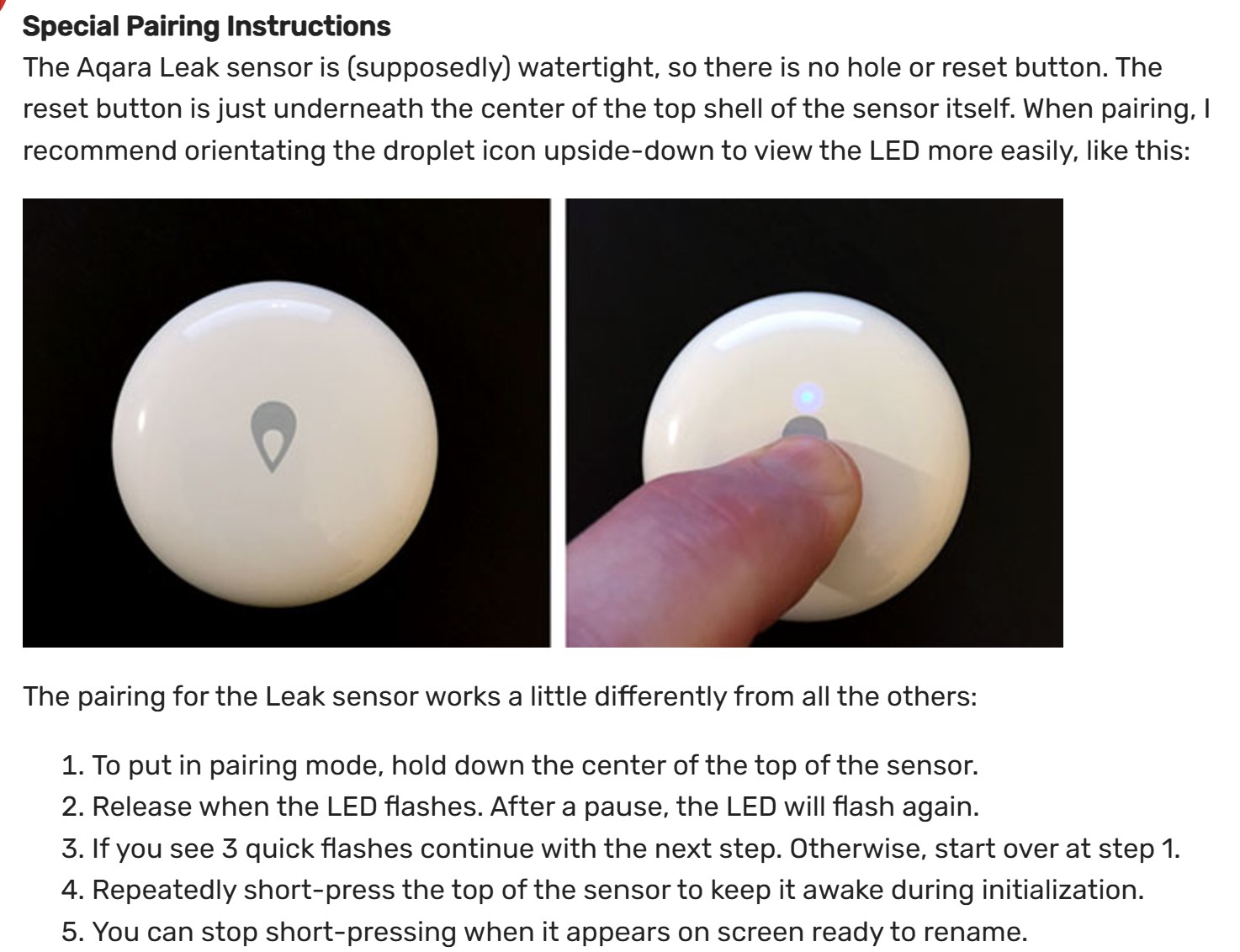

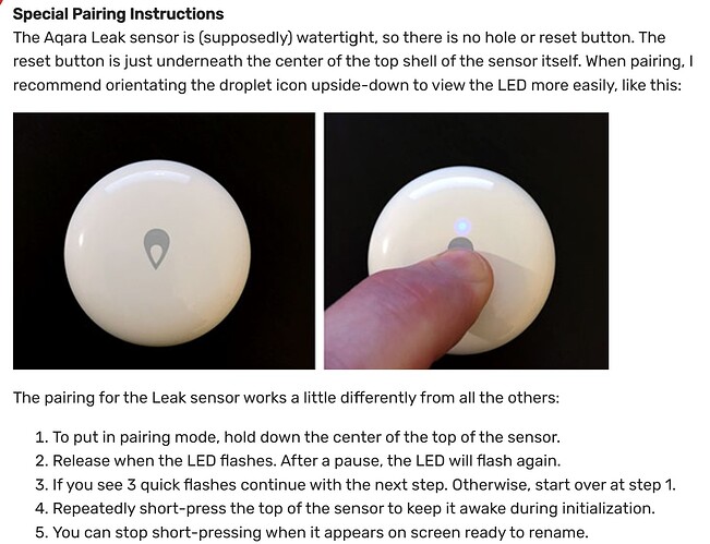

I use 3 of these with a C7 and have not had any problems with them . They report as they should using the "Xiaomi Aqara Mijia Sensors and Switches (w/ healthStatus)" driver that I found here https://community.hubitat.com/t/release-xiaomi-aqara-mijia-sensors-and-switches-driver/61630
I copied this pic of the pairing instructions from somewhere on this site (possibly from the same thread) that I followed, and all went well.
Give them a try,

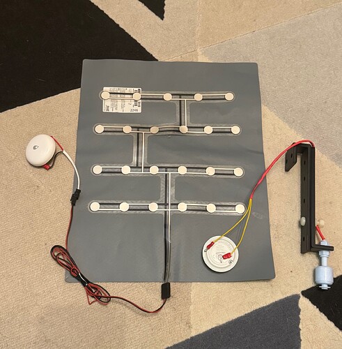

I have two of the Aqara Water Leak sensors as pictured above connected directly to my HE C8 Pro. I used them in a makeshift setup as a reporting device for a bed sensor but that should make no difference. I also use the same driver as above. For the most part I have nothing bad to say about them. I did have each of them fall off the network once and a simple rejoin done the trick. However, this has not happened again in the past year of use.
I would say give them a try as I have them and Third Reality. The Aqara is better looking and easier to place as the Third Reality is much larger.
The driver does show "present" and "not present" as a status of the sensor. If it connected of course it is present and if fallen off the network or some type of connection issue it will say "not present". You can set the time the hub will check the device. If you are going to use as a true water leak sensor where you won't interact with the sensors for long periods between I would suggest writing a rule to notify you if any of the sensors show "not present". Just a little extra security to make sure they will work if you need them.

I'm happy with how performant they've been for my 2 use cases: pressure sensing & water tank level monitoring serving as triggers, counters, etc.

Interesting application. Where did you get the pressure and water level devices?
AliExpress for the pressure sensor - https://www.aliexpress.us/item/3256804566558673.html?spm=a2g0o.order_list.order_list_main.155.728c18029oKwcd&gatewayAdapt=glo2usa
Amazon for the level sensors - Anndason 6 Pieces Plastic PP Float Switch Fish Tank Liquid Water Level Sensor,Model: DP5200: Amazon.com: Industrial & Scientific
