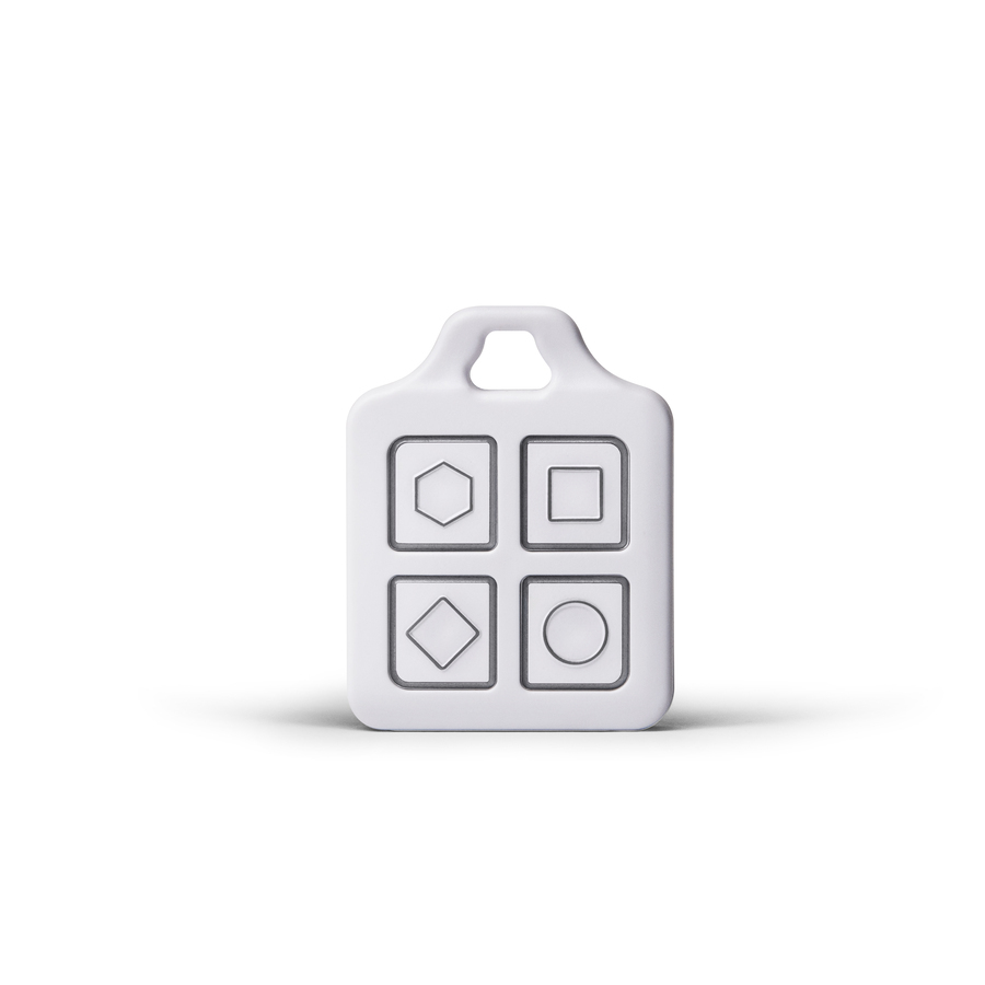

I have two Iris V2 Smart Fobs, model # 3450-L. These have been solid performers, both for the four buttons and for presence detection, at least until the past two days.

I'm not aware of any changes that would have caused this. Can you post a picture of the device in question?, I may have one that I can test with.
It is the Iris 3450-L Smart Fob.
I have one I can send you if you need to experiment. All I know is that I was having nothing but problems with the 2.4.x firmware and reverting to 2.3.8.140 appears to have fixed it as since I reverted, presence is working and the buttons are responding. To add to this, phone presence was also a bit flaky with the 2.4.2.129 where my wife's phone would show as not present even though it had not moved from the house. I will be observing over the next few days and will report here if the 2.3.8.40 firmware keeps working.
