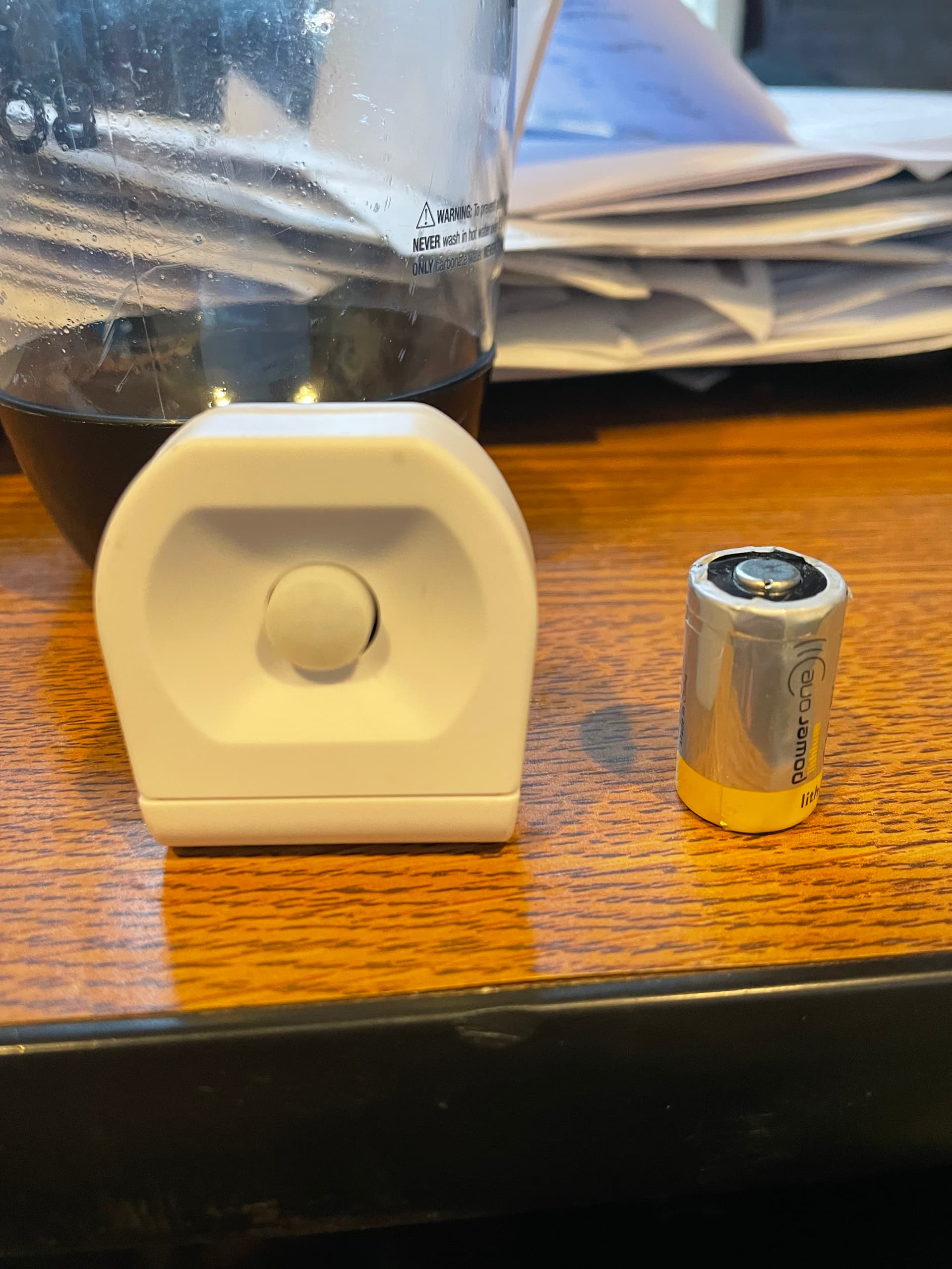

Just hardwire it!
6e4b979ee7dc194f4ce43e823086e64d0d4a138d_2_374x500
Note: this is an older pic - buck converter is in the battery case, there are newer ones with the converter in the usb socket.."battery eliminator" style.
If you get a chance someday could you take a pic of the guts of that hack.
Would love to see more info on this newer hack.
Best motion sensor ever...have a bunch of them bought back in the day and more recently when I could find them on eBay or from users here.
@PunchCardPgmr / @danabw - here you go! Hopefully I've been able to hide the poor soldering job..
This is with a buck converter in the battery compartment. I clipped the battery terminals for additional room and soldered closer to the sensors circuit board. Also used a dab of hot glue to hold things into place. Just used the red and black wires in an old usb cable for the bucks inputs and wired the outputs to the battery terminal stubs.
Here is a sensor using the battery saver wiring.. all I had to do was clip the clips and solder the wires directly onto the terminals:
In both cases just drilled a small hole in the back of the sensor to run the wires through..
