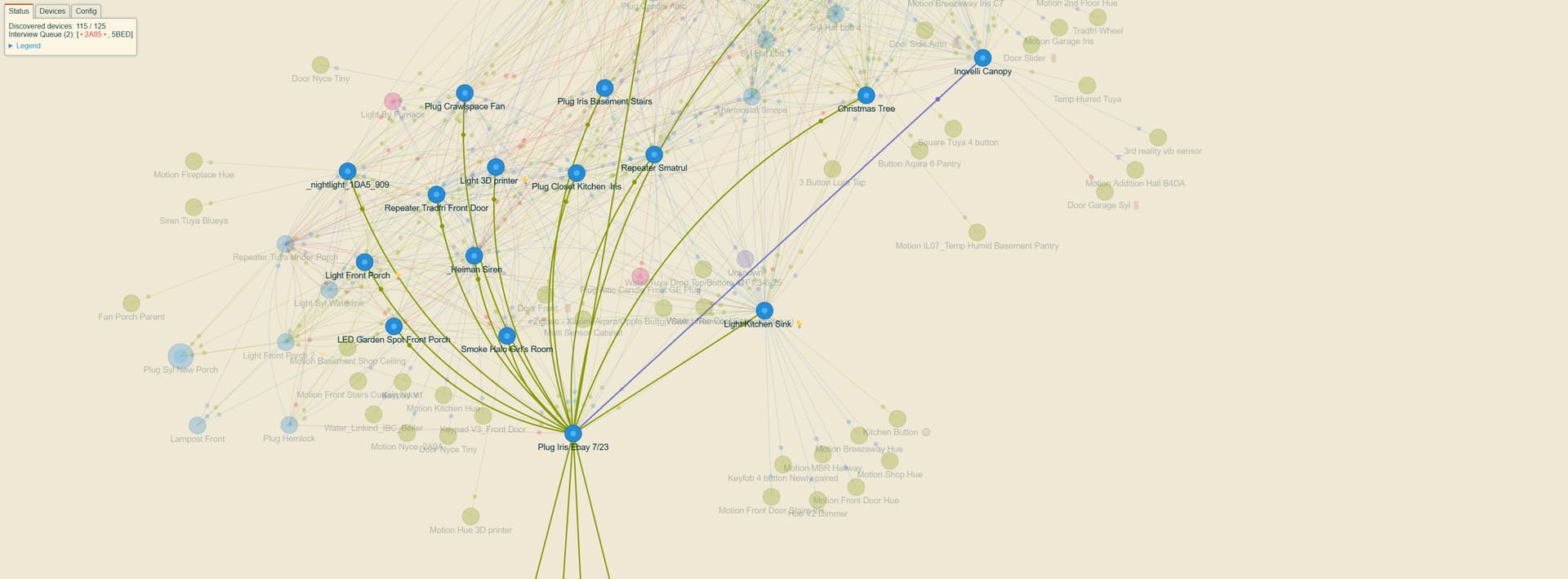

I have 2 of these and they are super repeaters. In the Zigbee map app they have all very solid connections. I don't really like/use the plug function, because they are huge & ugly but keep them in attic & basement as super signal repeaters.
