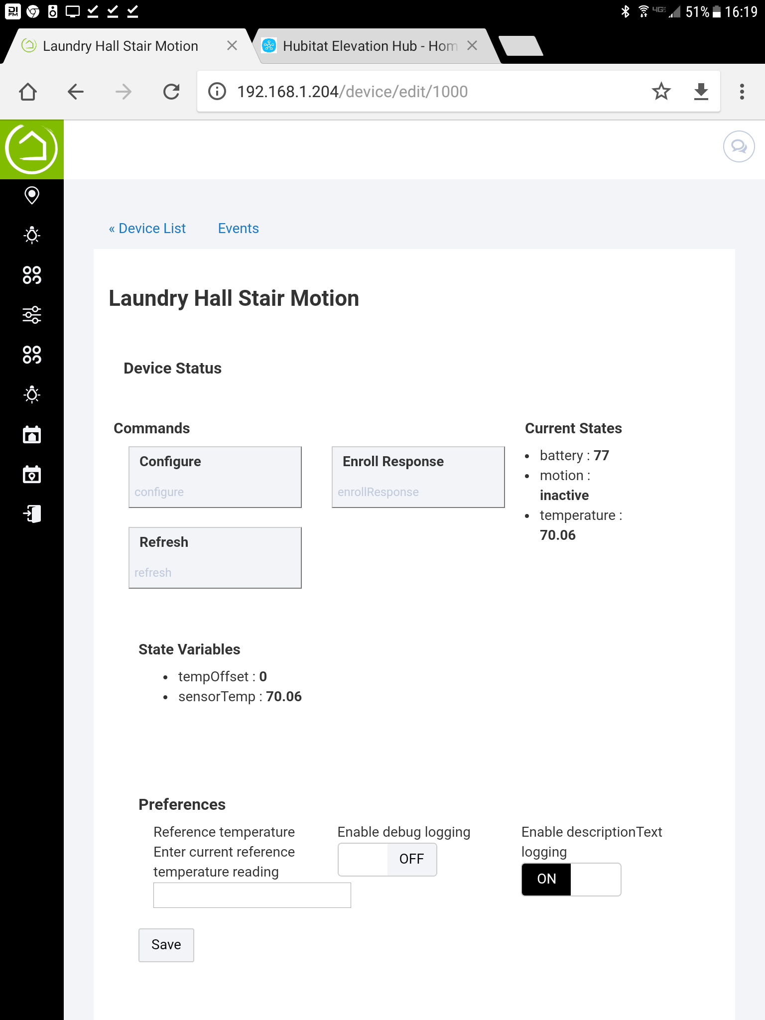

I was able to install the sensor. But only get motion. No temperature. Does anyone have a better driver.
Nothing wrong with the driver...
Might be a mesh issue, or might be an incomplete pairing. Try excluding, resetting and pairing again, close to the hub if possible.
Did you click on the Configure and Refresh buttons?
This worked. Thanks!
