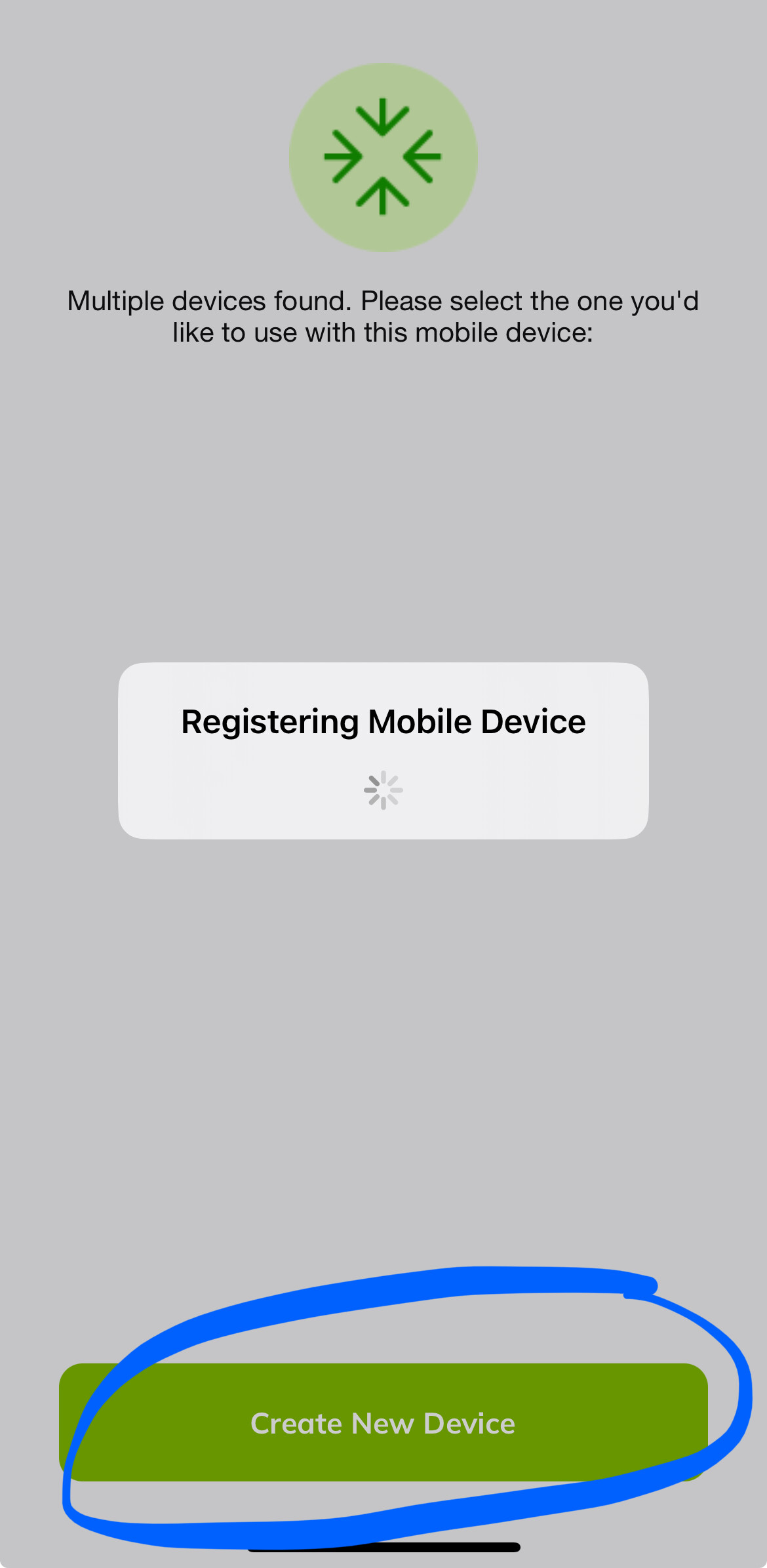

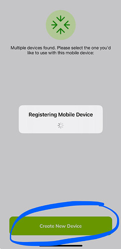

Do you see anything like this when asked to select the device? (Ignore the fact that mine doesn't show a list and is already "registering"--I've already associated this device and couldn't get the screenshot in time...)
On my iphone I do see this screen with create new device..but the same screen you show with "Registering Mobile Device" grabs the Ipad even though I'm clicking on "Create new Device"
