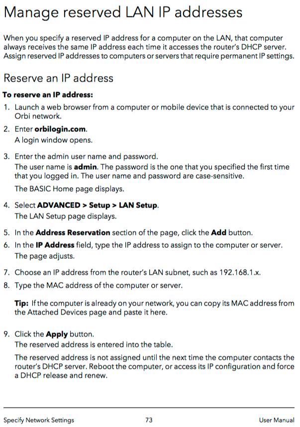

The Lutron bridge and the Hubitat both use DHCP to set their IP addresses. That isn't the issue. The issue is that your router is giving them new addresses upon receiving a new request.
The solution is to set up DHCP address reservation for both the Lutron bridge and the Hubitat on the router.
Edit: Here's the relevant page from the Netgear Orbi manual -
Yup, as @aaiyar said, your router needs to make a DHCP reservation, which is configured in the router’s settings menu.
Just because it’s using DHCP to assign addresses doesn’t mean the IP address of an individual device will never change.
A DHCP reservation assigns a consistent IP address based on a device’s MAC address.
Check your router’s manual, probably in the section on LAN settings.
Edit: @aaiyar’s a much more helpful guy than me, he went and found the relevant manual page for you :wink:.
