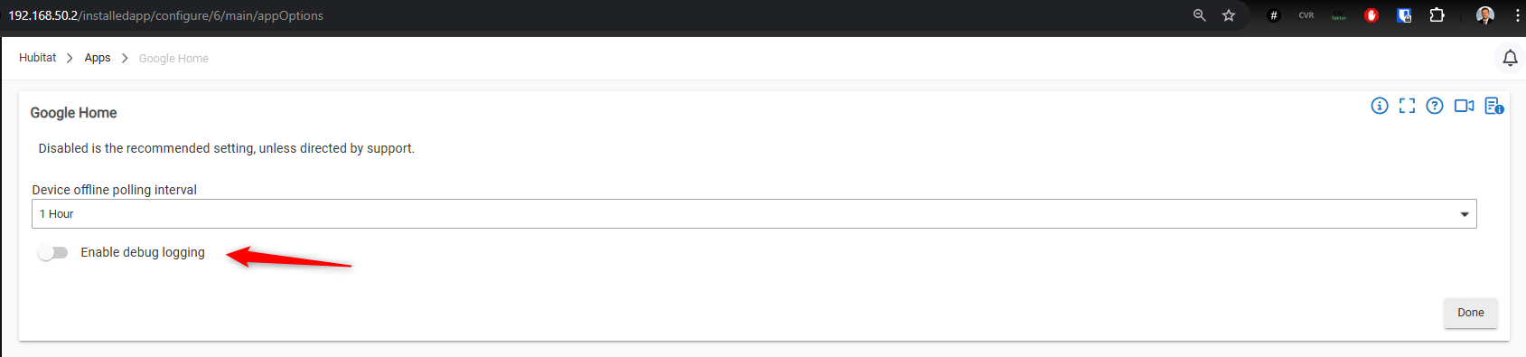

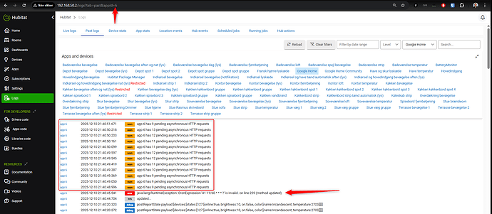

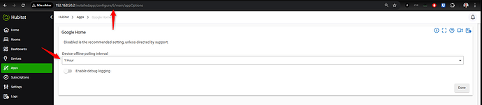

I seams like the Google Home app has an invalid value for '1 Hour' and requests are pilling up.
Google Home is my app #6:
Log entries for app #6:

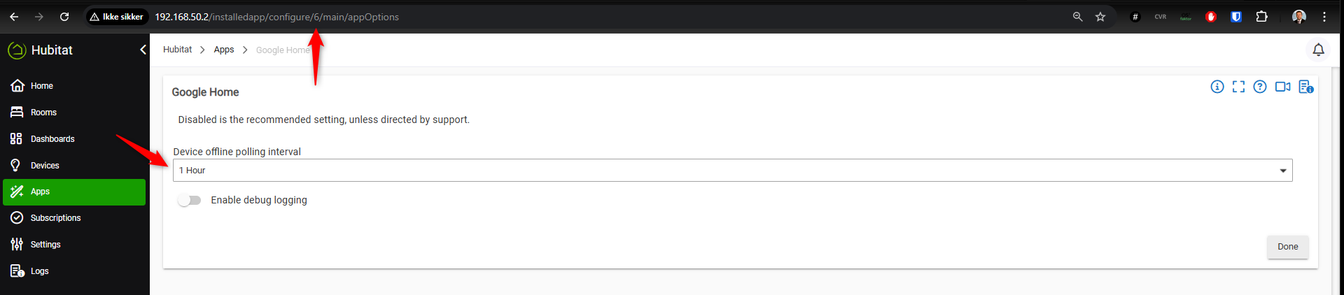

I haven't tested the other options for polling interval.

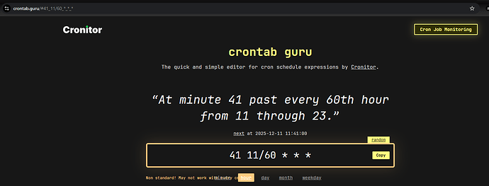

Testing with '41 11/60 * * ' gives a very odd result at Crontab.guru - The cron schedule expression generator':
How about '0 * * * '? = "At minute 0.” ?
The method updated() runs when you press Done in the app.
That isn't a true Unix cron, it is Quartz Scheduler cron expression.
That schedule fires every hour, or every 60 minutes (60)
The schedule starts at 11 minutes after the next hour (11)
It fires at second 41 of that minute (11 after the hour)
It looks valid to me... maybe I am missing something.

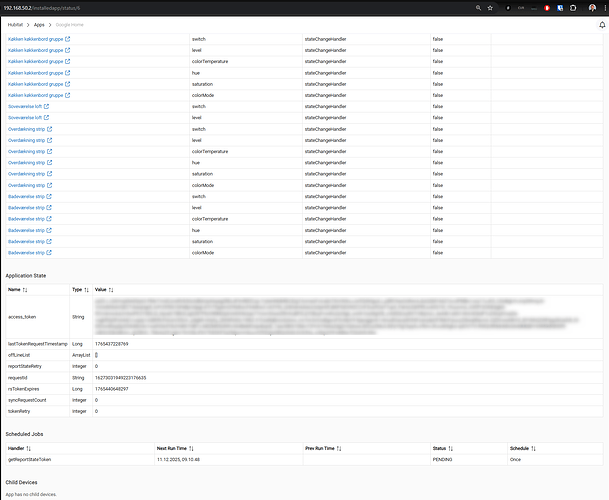

Anyway, you can press the info button for the app, and look for a scheduled job at the bottom of the page for the schedule it was trying to create. If it isn't there I guess it did fail, if it is there you are good. If it is not there it will not poll on the hour schedule you tried to set.

I can see that a scheduler is registered and no more pending requests are logged:
The time that the exception is thrown could be right when I upgraded the unit, so that might be the reason?
Logging
I'm not able to go that long back in time in log entries because the debug log logs to much :frowning:
It surprises me that the app is debug logging, because the setting is and has always been set to false:
It doesn't look like this setting is being honored :frowning:

You didn't mention if you checked the scheduled job to see if it got scheduled or not. It looks like the exception came from Quartz Scheduler itself.
Thanks for getting back on this.

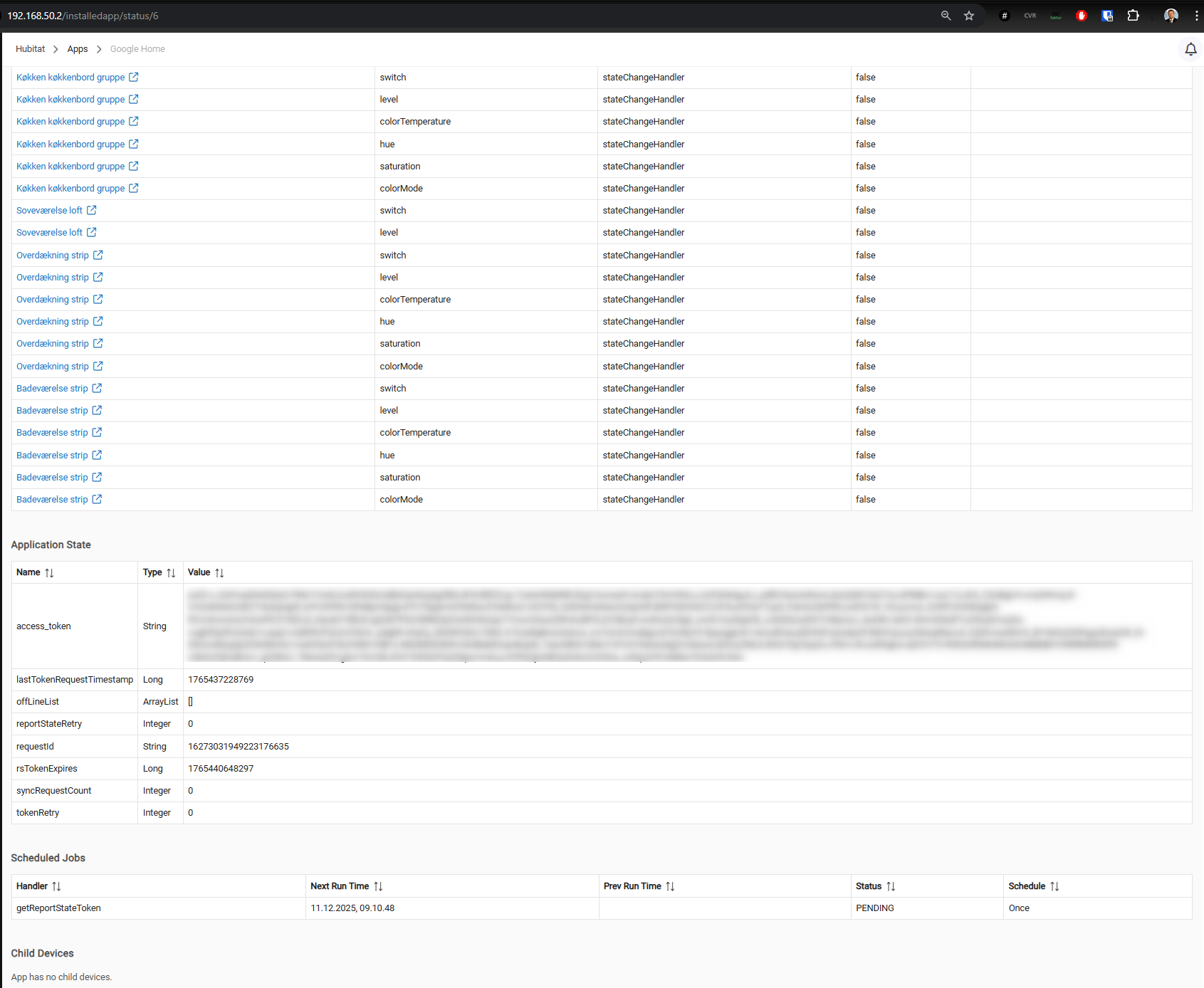

The image I posted 5 days ago, doesn't that show (at the bottom) that the scheduler was active?
Sorry, I guess I missed that screenshot. If it is working, I wouldn't worry about the error it gave.
