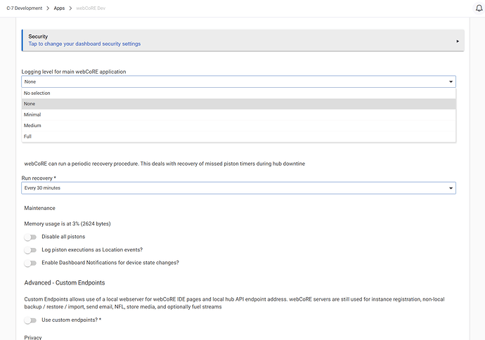

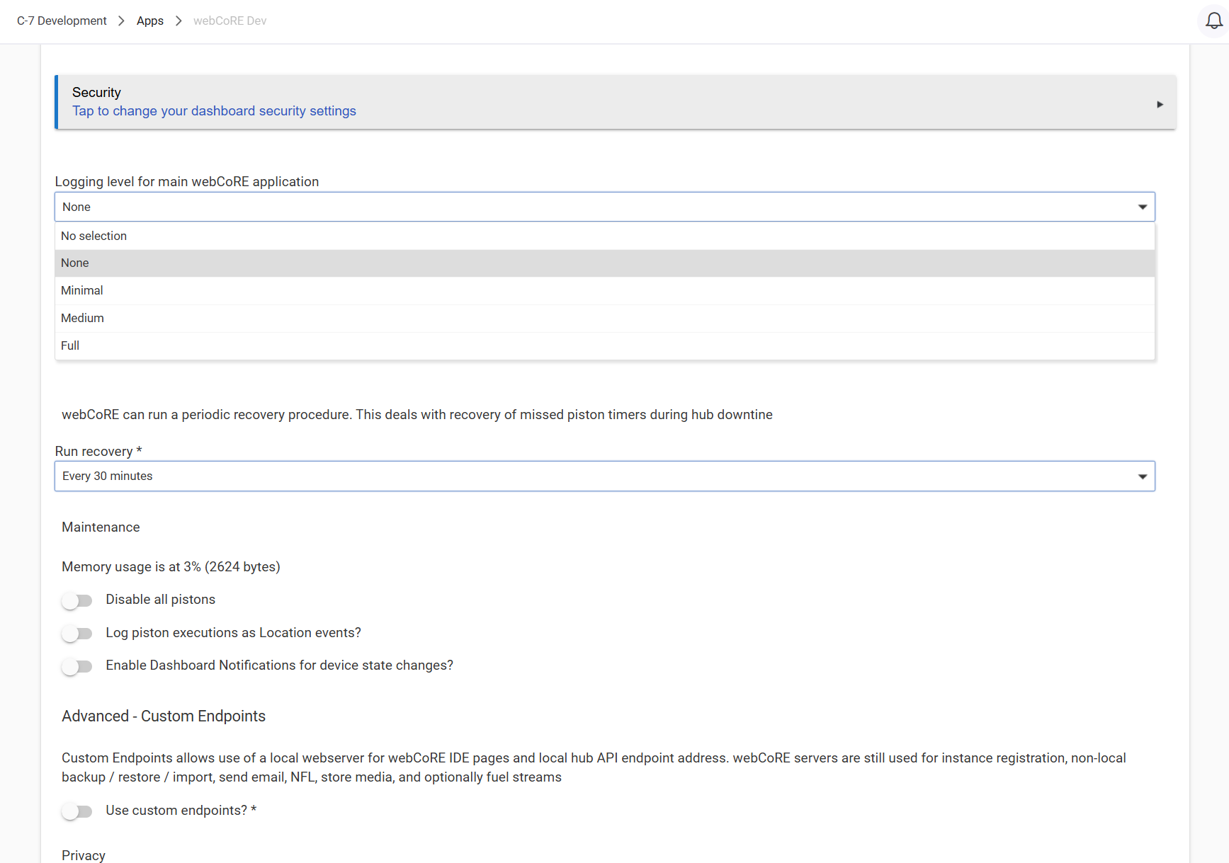

I'd turn on Full Logging in webCoRE and see if that gives you anything to work with
