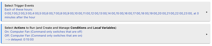

Why not just do it through rule machine?
Use a periodic trigger, in a rule that looks something like this:

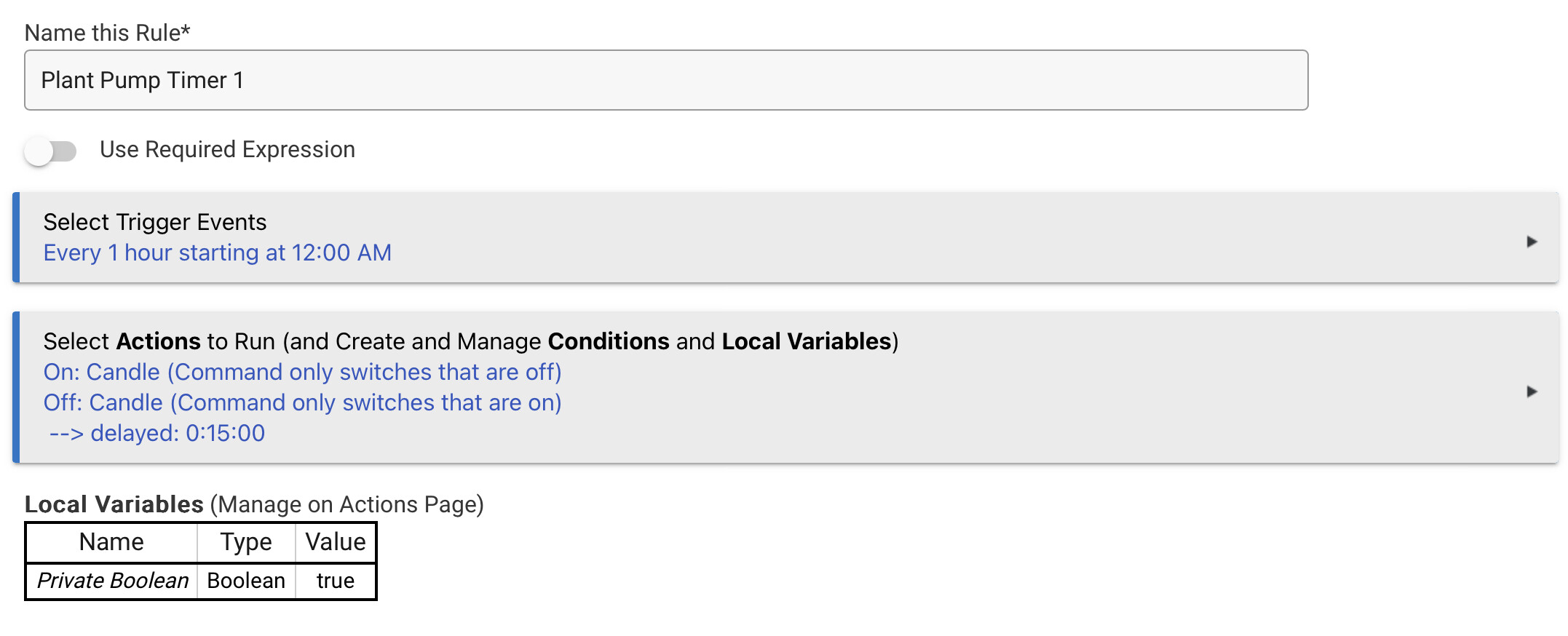

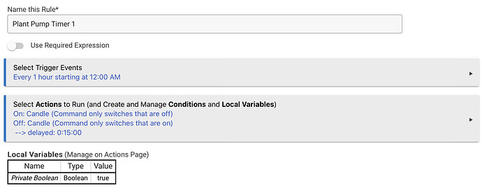

Okay so this should probably work right? Please ignore “candle” as that plug needs to be renamed.
Admittedly, I’m confused by the “command only switches that are off/on” and why this would even be needed?
Also, why is the “off” action delayed by 15 minutes? Does this mean the pump runs “on” for 45 minutes?
