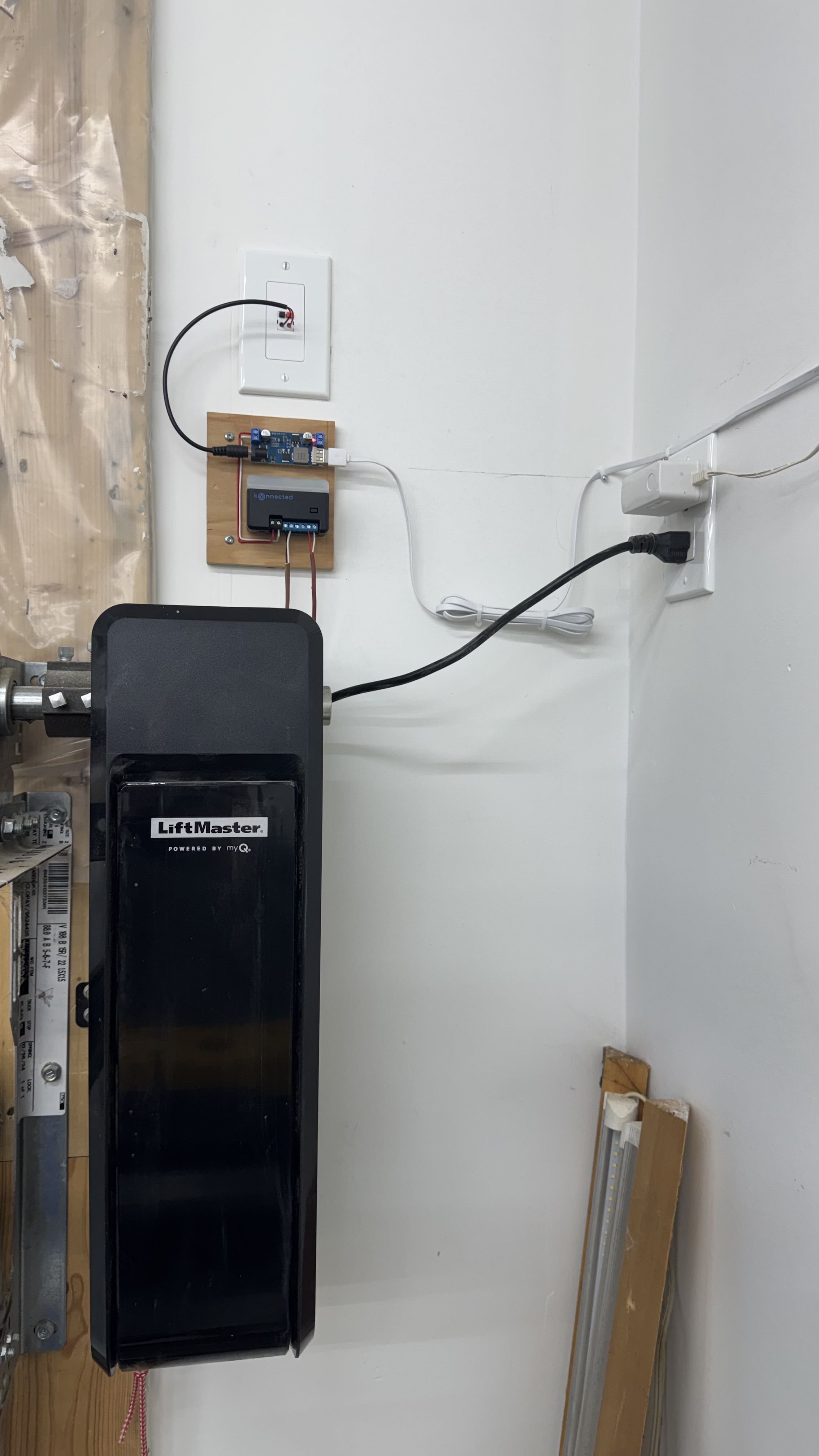

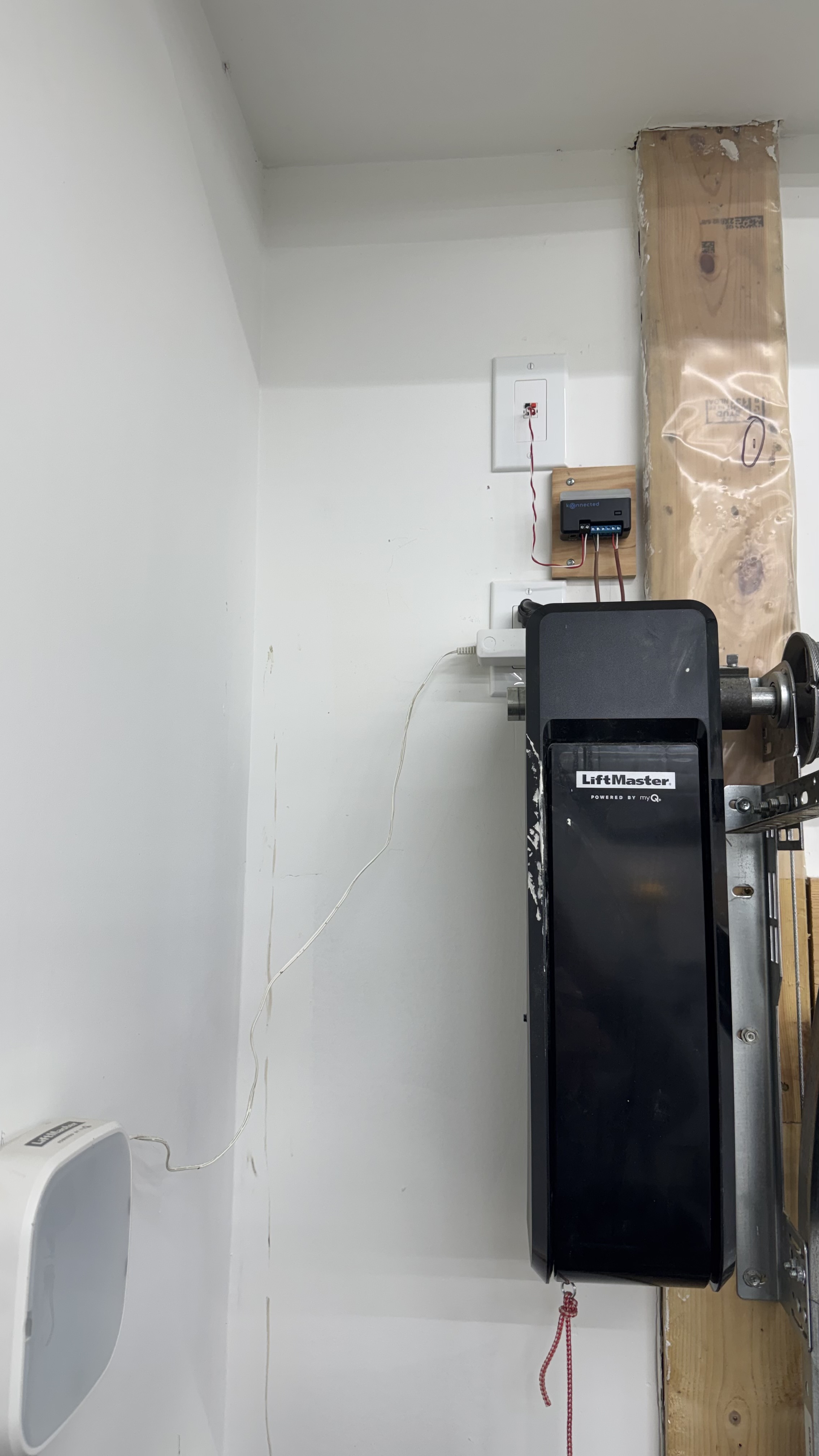

There is another thread that I can’t find right now talking about how to install them - in parallel or inline with the switch. Somebody mentioned that inline caused issues with their button functionality. I installed both of mine inline and I have no issues.
I will add some pics of my install. I should have time later today.

BlaQ install pics with Liftmaster model 98022
