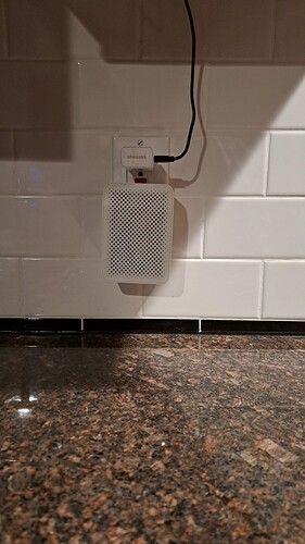

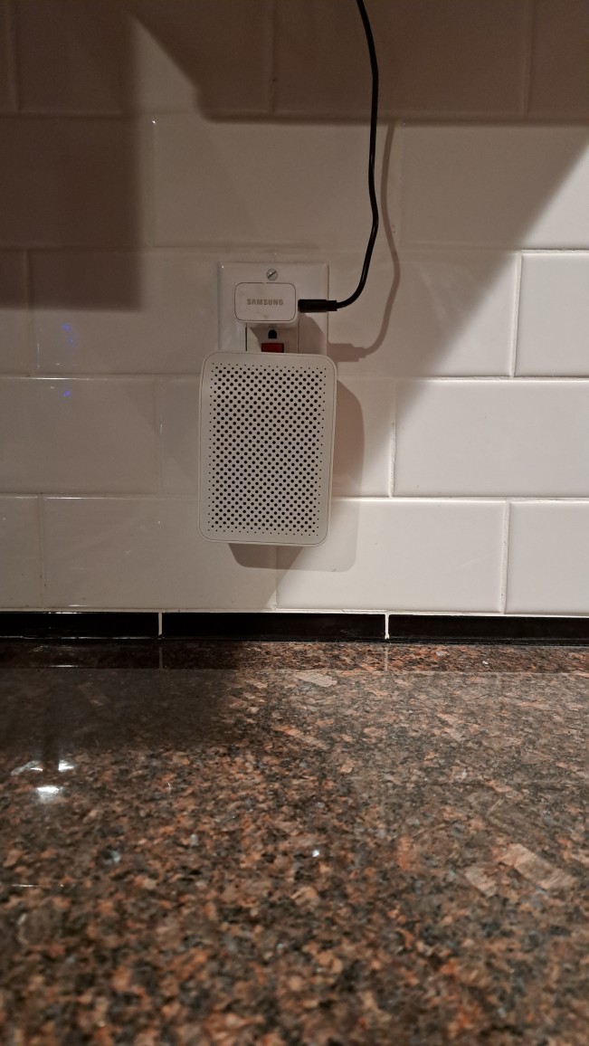

I have a Zcombo out in the garage. I wouldn't really be able to hear it in the house. I installed an Ecolink chime siren. It has the alarm sounds for both smoke and CO and is quite loud. If I really wanted to make sure I'd hear it, I'd put another one upstairs. But, I'm also using it for voice announcements, which don't have the volume of the alarm sounds, but still, I've slept through a couple "Hub CPU Usage Is High" warnings, lol, which is fine by me.
It might not be a bad setup: the siren would go off as well as the detector affected. At least you would know which detector was going off. My wired interconnected units have little flashing leds that you have to study.
The Ecolink chime/siren plugs into the wall but also has a backup battery.
