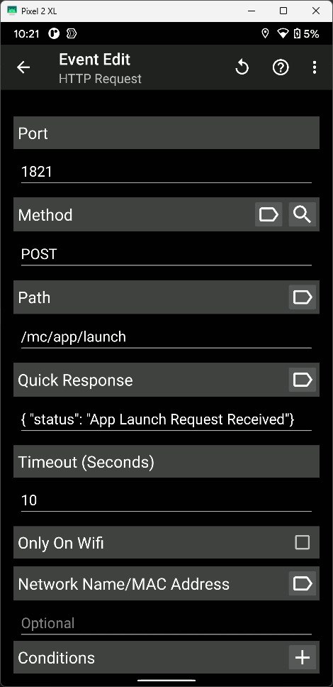

Let me give you (and others) some screenshots of what I have been describing...

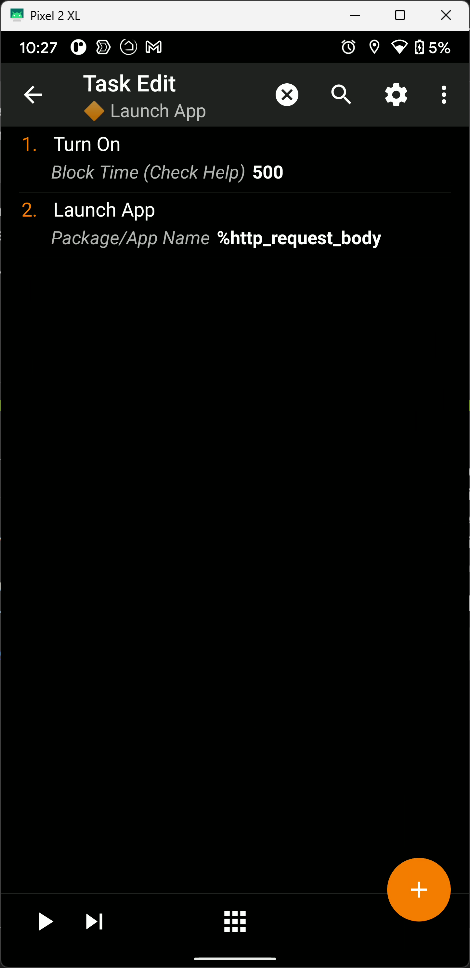

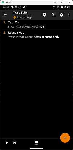

Here's the setup of a "App Launch" profile I have in my project that is based on a HTTP Request... The name / context, i.e. the App Launch part, is not something to get too worried about... The important parts are that I have a profile setup to use a HTTP Request as the trigger, nominating a port and path, which are completely up to you to choose. The response is also not necessary, particularly if you choose to go the RM route.
From there I chose to turn the screen on and then launch the app based on the body of the request received, which is more to do with my "Mobile Controller" app and what I want to achieve.... not necessarily something to be concerned about for the use case in this topic...
