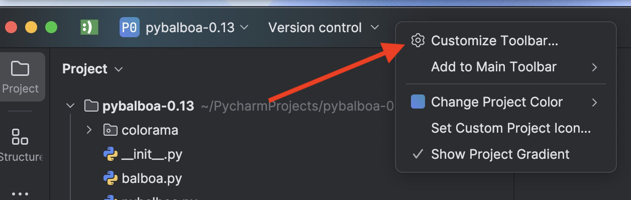

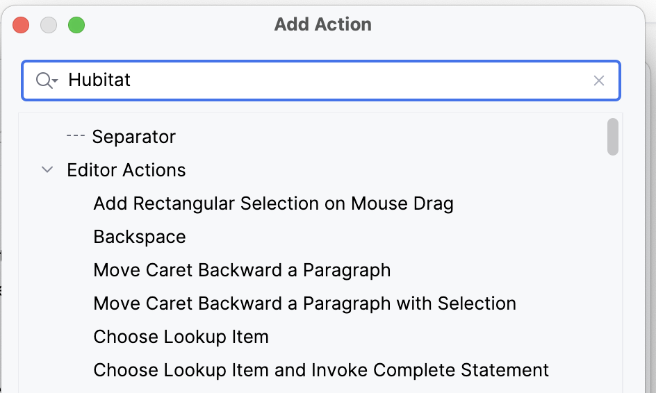

  • Right click on the toolbar and select Customize Toolbar... from the menu.

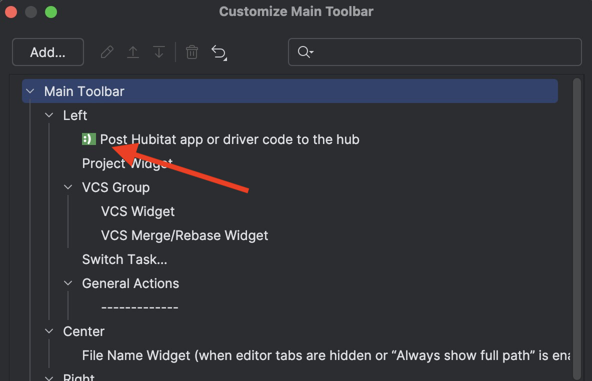

  • Click (+) icon and select Add Action.

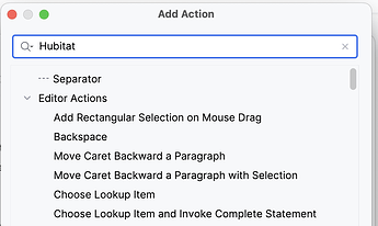

  • Enter "Hubitat" in the search bar and select Post Hubitat app or driver code to the hub.
  • Assign an icon of your choice and click Ok.

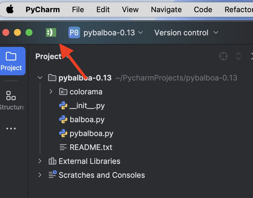

  • Double check that the icon appears on the toolbar.

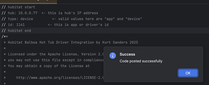

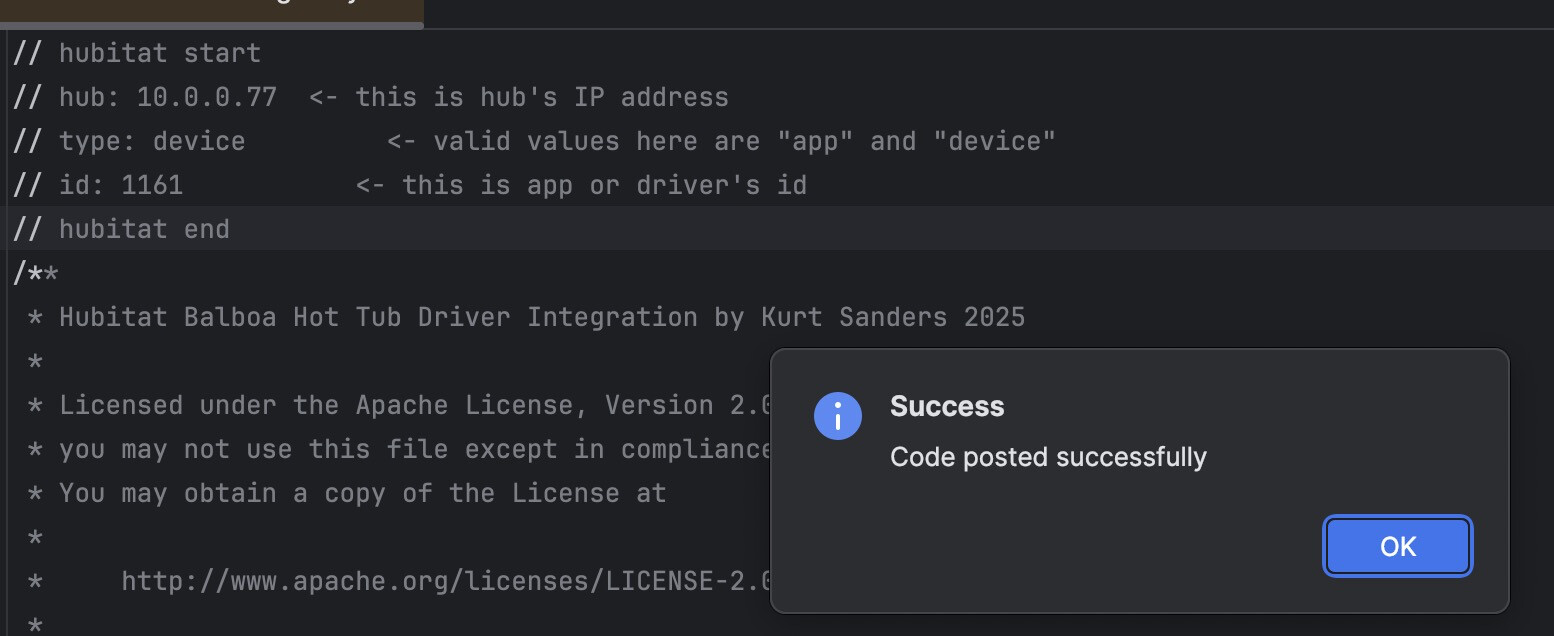

The plugin looks for a set of comments with hub/app/driver information at the very beginning of the file. Copy/paste the sample code below as the first 5 lines of the app/driver groovy file and modify information as needed.
// hubitat start
// hub: 192.168.4.86  <- this is hub's IP address
// type: app          <- valid values here are "app" and "device"
// id: 2551           <- this is app or driver's id
// hubitat end
Make sure that the information is correct, then click the button created in the first step to upload the code. That's it! A confirmation will pop up to indicate either success or failure of code upload. If there's a compilation error, more information will be provided.

I can't get this to work.. the plugin looks enabled but I can't find the action when trying to add it to the toolbar. I used the same syntax you did too -- until-build="342.*". Any pointers?
I right clicked on the top Toolbar to show 'Customize Toolbar'
I added the new option, selected a green icon and dragged it to the top of the list.
Now it shows up with a smile!
thanks.. I had it setup on an earlier version of IntelliJ but for some reason I can't find the action anymore.. nothing comes up when searching for "Hubitat" or Post

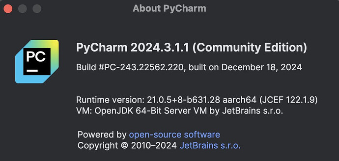

Can I ask what version of IntelliJ you have?
Build #IU-243.23654.117, built on January 16, 2025
PyCharm 2024.3.1.1 (Community Edition)
Build #PC-243.22562.220, built on December 18, 2024
Runtime version: 21.0.5+8-b631.28 aarch64 (JCEF 122.1.9)
VM: OpenJDK 64-Bit Server VM by JetBrains s.r.o.
Toolkit: sun.lwawt.macosx.LWCToolkit
macOS 15.3
GC: G1 Young Generation, G1 Concurrent GC, G1 Old Generation
Memory: 2048M
Cores: 14
Metal Rendering is ON
Registry:
debugger.new.tool.window.layout=true
ide.experimental.ui=true
i18n.locale=
llm.show.ai.promotion.window.on.start=false
Non-Bundled Plugins:
com.hubitat.intellij.plugin.HubitatIntelliJPlugin (1.0-SNAPSHOT)
com.redhat.devtools.lsp4ij (0.9.0)
izhangzhihao.rainbow.brackets (2024.2.8-241)
pro.bashsupport (4.5.0.243)
com.bash.cmd (1.0.0)
