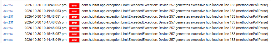

I found the log FILLED with errors and warnings. I can only go back to about 2:45 this afternoon, as Hubitat apparently hit the limit of how many log messages it will store and is purging old ones as new errors and warnings hit the logs. Thus, I can't figure out what started this.
The only thing I could think of to do is to reboot the hub from the hub settings, which seems to have solved the issue, for now. However, I would love to know what started this so I can avoid it in the future. Does anyone have any ideas?
After every log entry for a device, the logs showed either a warning or error of "Excessive Hub Load"
  • One device to monitor humidity shows repeated instances of this:
  • Another device to monitor humidity shows repeated instances of this:
Every outside connection Hubitat was trying to make was failed, as did completely local connections, such as below

What exactly are those three devices in your log screenshots, and what driver(s) are they using?
That's the hub's "excessive hub load" throttle. Several unrelated devices tripping together points away from one bad device.

Those are just examples. Almost every single device generated those types of log entries when it did any sort of update on temp, humidity, open/close status, battery level, lux level, etc.
