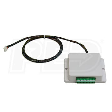

You should check if the Mitsubishi PAC-US444CN-1 Thermostat Adapter is compatible with your new system. It permits regular HVAC thermostats to control mini-split systems. If it compatible, you can use a compatible z-wave or zigbee thermostat.
aaiyar's solution seems expensive, you would need to buy a thermostat & thermostat adapter for each blower. This is the cheapest thermostat I can find Radio-Thermostat-Z-Wave-Module-RTZW-02 at Amazon, with id: B07GWBLD83
~ $200 per blower seems really high.
