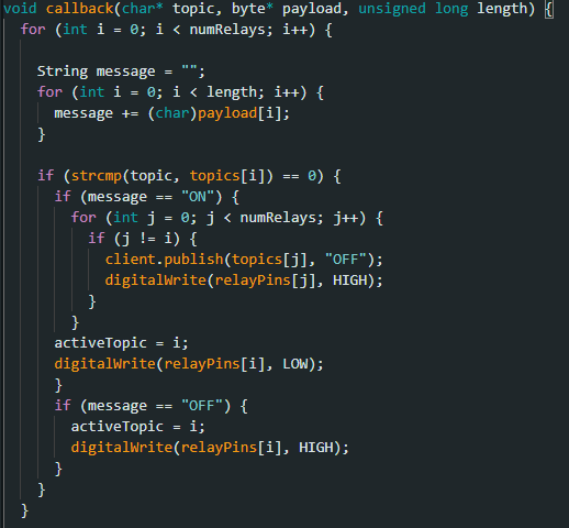

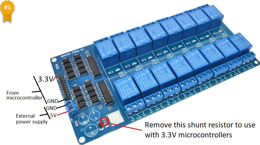

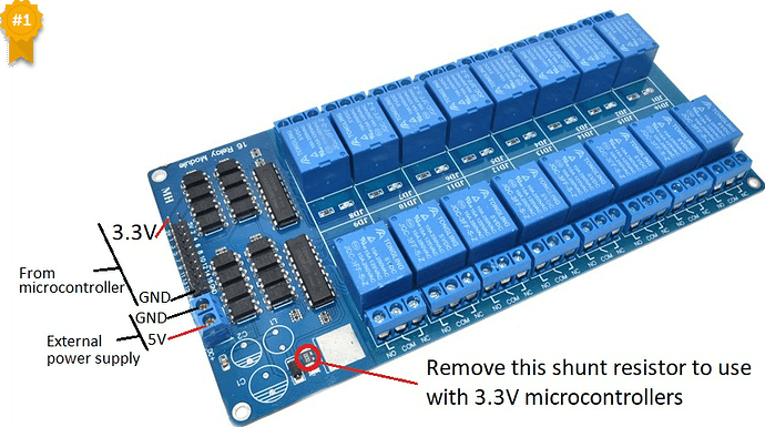

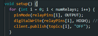

Finally got around to getting this setup. Had to switch to powering everything from Solar. So building that setup took so much time. Everything from battery cabinets to enclosures for the models etc. Its been a long road and now will tinker with this. Just installed Hubduino and have a few different types of ESP32's. My main hope is to follow a diagram and post on the arduino forum that has been closed but some of the code was posted on an image. Just need to sort out the spacing for the code to be written correctly and to figure out if one stacks on top of the other and vice versa.
16xrelay
16xrelay2
