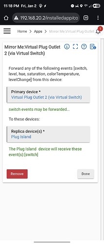

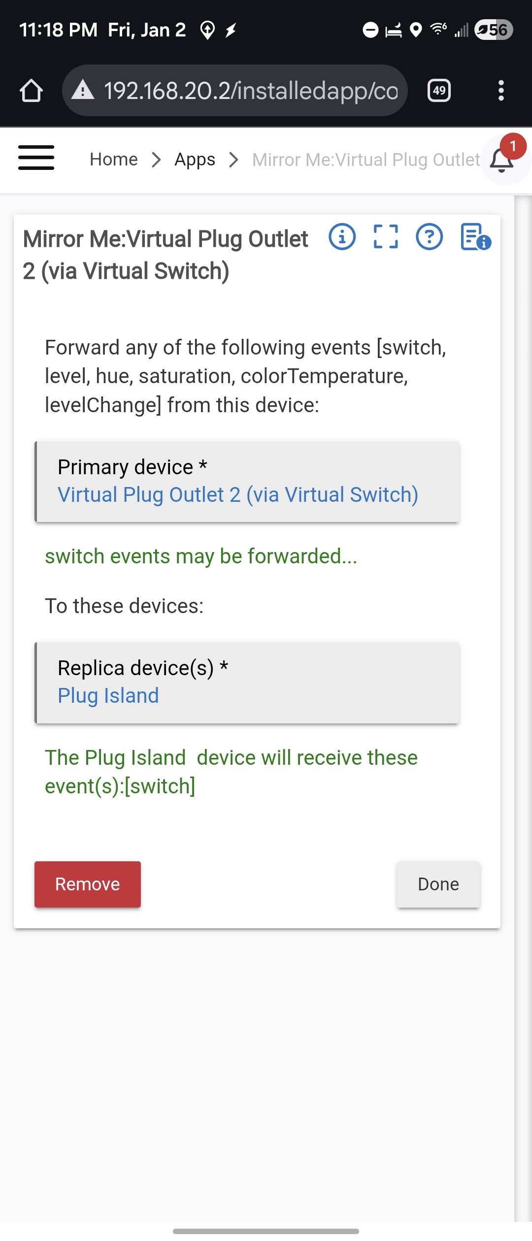

You can create virtual devices that mirror the real ones and then use the virtual devices in automations. I think you'll want to mirror in both directions. Virtual light changed by automation, actual light changed by manual action.
Then you can use swap device on the virtual devices since they aren't children.

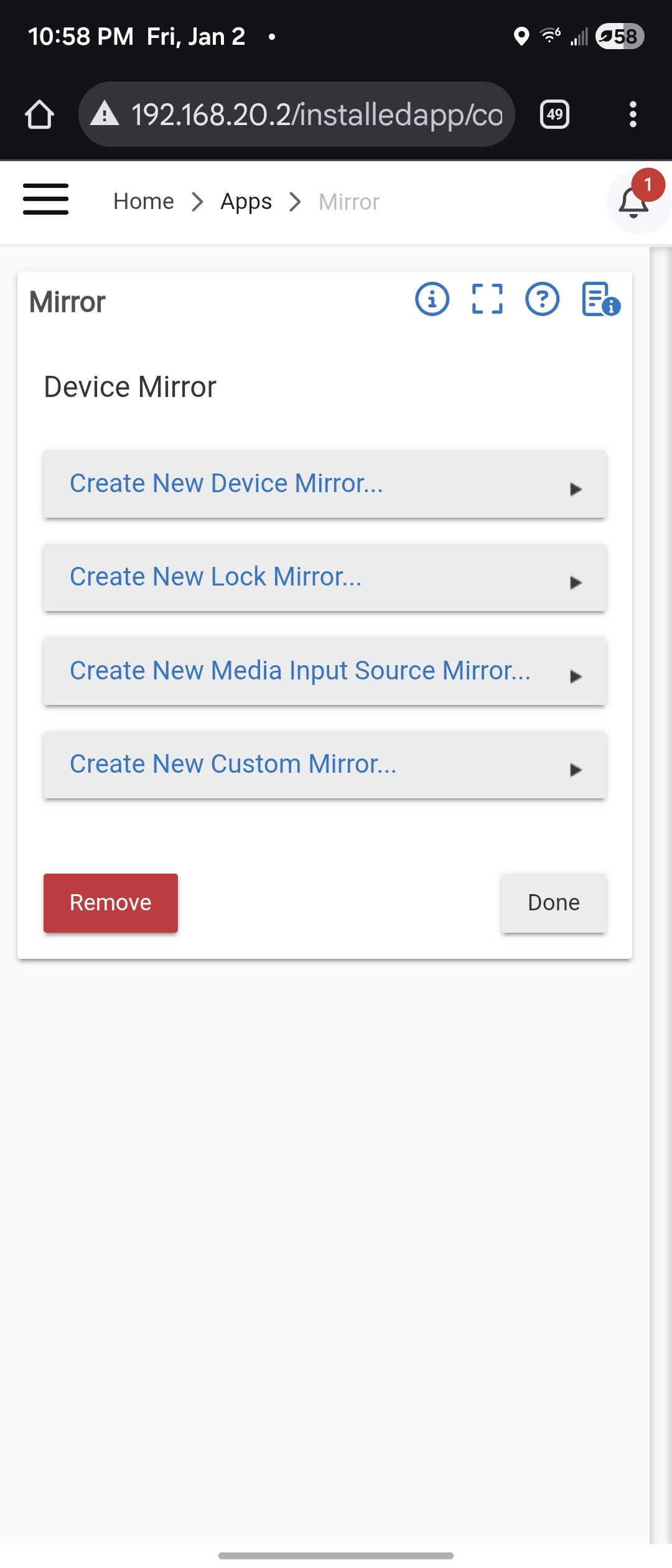

The built-in Mirror app can be used for this.
