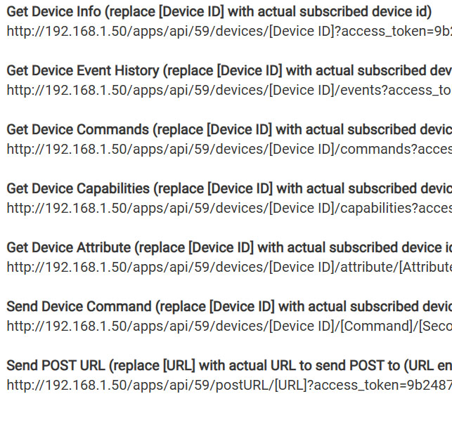

Create a Maker API and add the devices you want BI to be able to control, then use the URLs under that as your POST.

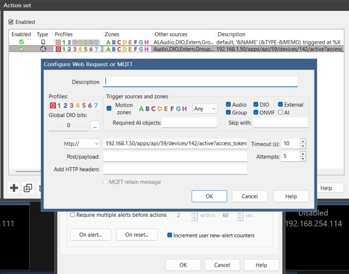

I created a Virtual Motion Sensor for each camera and added them to the Maker API App I created for BI. You will see the POSTs similar to mine.
Then in BI, go into the camera settings, -> Alerts -> On alert...
Create your new POST alert and enter...
<Hubitat IP Address>/apps/api/<App ID of the Maker API App>/devices/<Device ID of that camera motion sensor>/active?access_token=<access key>
When the alert hits, it'll call that URL which should trigger the motion sensor.
Then just a normal RM rule to do whatever you want when the motion sensor is triggered.
You will need the virtual motion sensor to go inactive, so that you can do other things on inactive state change.

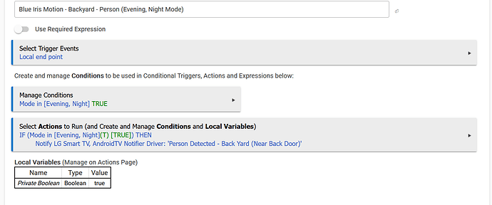

BI Control is one way, Hubitat to Blue Iris. BUT... there is a way to receive alerts from Blue Iris just using Rule Machine!
Note: This was written for BI4. If using BI5 results may vary.
  • In Rule Machine:
    • 'Create New Rule', 'Define a Trigger', 'Name the Trigger'
    • 'Select Trigger Events', 'Select capability' = 'Local End Point'
    • Note: you will need the 'Local End Point URL' in Blue Iris
    • 'Select Actions' to do whatever you like!
  • In Blue Iris
    • Select the Camera to use as a Trigger then 'Right Click' and select 'Camera Properties'.
    • Select 'Alerts' and then check-off 'Post to a web address...' and then click 'Configure'
    • Under the heading 'When Triggered', make sure that "Http://" is selected
    • Then next to that box, put in the 'Local End Point' URL from Hubitat. Note: do not include the Http:// ... just start with the ip address. (ie. 192.168.1.123/apps/api/....)
    • Click 'OK' and your done!

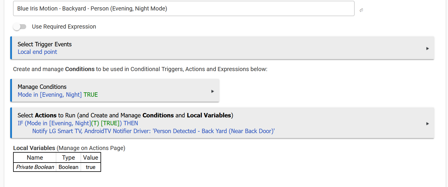

I did a Local End Point for the trigger.
