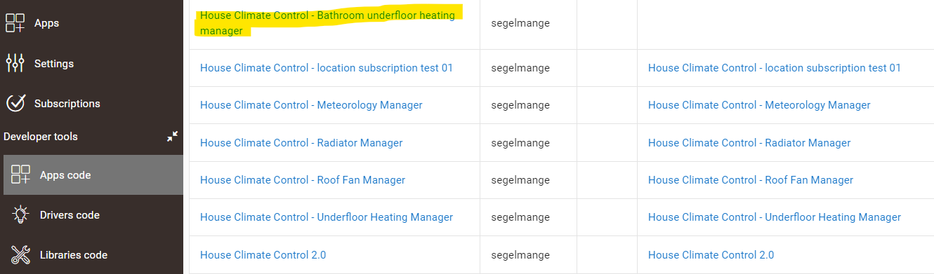

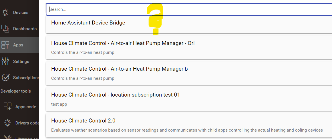

I created and installed an app from VSCode. The app code appears under the app code section in Hubitat which usually means it will be available to add as a user app in the app section of Hubitat. But for some reason my app is not showing upp in the LOV when I open 'Add user app'. Anyone come accross that before?

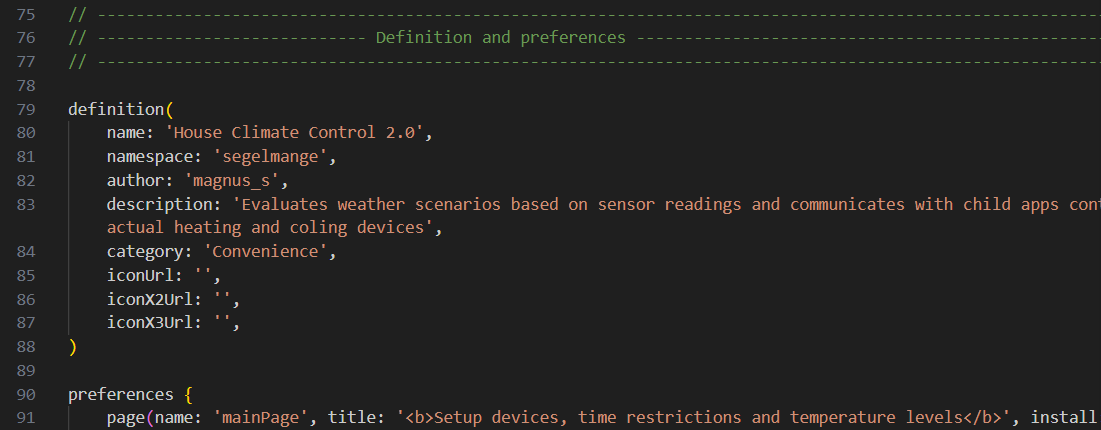

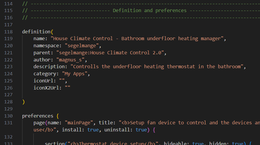

can you post a screen shot of the app's definition section?
Sorry, of course.
and for the parent app
The parent app is installed and working.
I don't think "child" apps should show in the "Add User App" menu, they are supposed to be added by the parent app itself.
For Example, Rule machine or Button controller you only see the main app in the list. The child apps are created by the parent app through its menus.
Correct, child apps can only be added via the parent app's creation, they cannot be installed directly.
Yes of course! I left it out from the preference section in the parent app. Thanks. Sorry.
