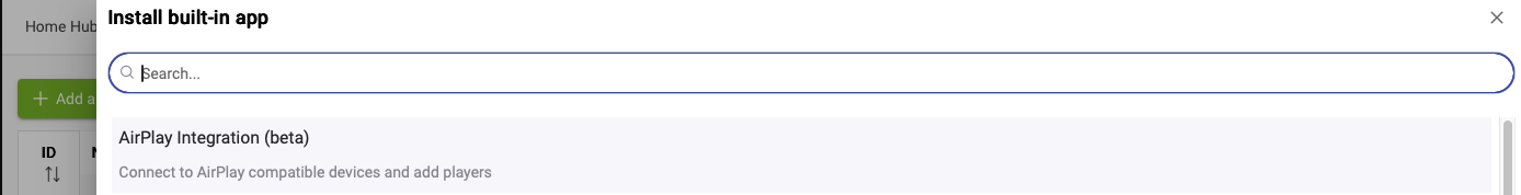

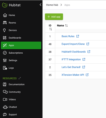

If you're saying there should be a selection named "Apps code" I cannot find it. I have "Apps" and "+ Add App".
"+ Add App" has no triple dot menu.

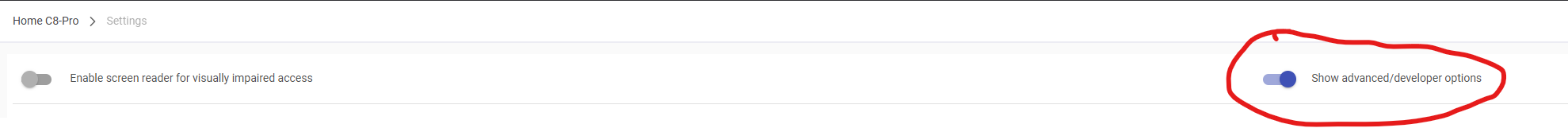

Go to your Hub Settings page and toggle this on.
That was it! Thanks!
