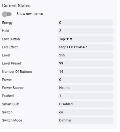

I have two Red series VZW31-SN (v. 1.04) switches running in dimmer mode on Hubitat (C8-pro).
Hubitat is running the latest ZwaveJS (not Zwave legacy)
Driver: Inovelli Dimmer 2-in-1 Red Series VZW31-SN (2024-10-22)
The issue is that the devices are reporting a brightness of 255 whenever the switch is triggered ON.

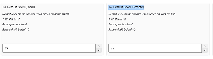

I've tried changing the "14. Default Level (Remote)" parameter, but this does not resolve the issue. Currently, it is set to '99'.
Any suggestions?

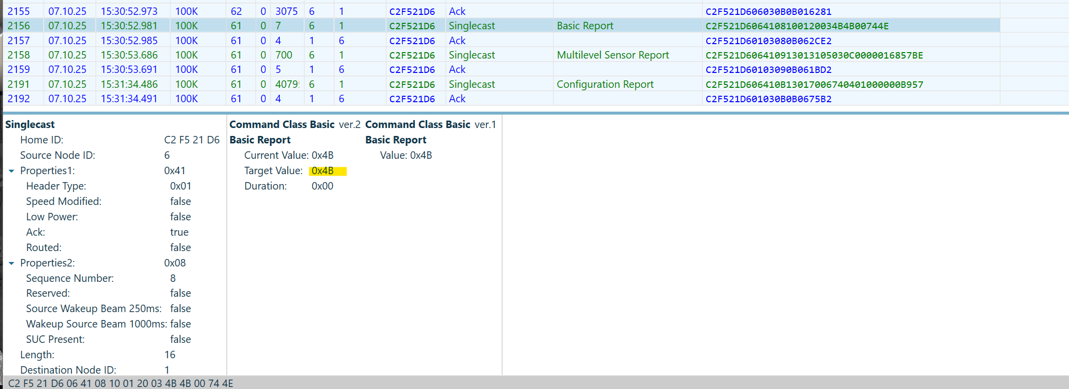

But in the zniffer packet I see this:
Checking
I know what it is.. Will get a fix out
Fix will be in the next build .134 or higher.. 133 was already built and about to be public.

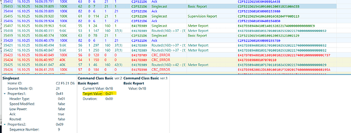

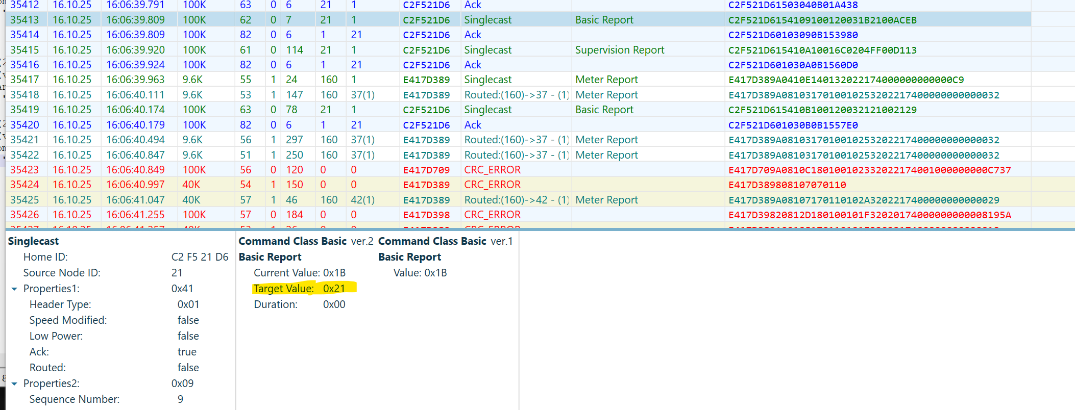

I am still seeing some BasicReport "targetValue" being read as 0. It seems when the switch is turning on from a BasicSet command and two BasicReports come in around the same time. The first one has a targetValue of 33, but the logging shows it as 0.
dev:102025-10-16 04:06:40.162 PMdebugBASIC TARGET VALUE --------------------------------------> 0
dev:102025-10-16 04:06:40.160 PMinfoInovelli Dimmer 2-in-1 Red Series VZW31-SN Basic Report: value on (27)
dev:102025-10-16 04:06:40.158 PMtraceInovelli Dimmer 2-in-1 Red Series VZW31-SN zwaveEvent(BasicReport(value:27, targetValue:0, duration:0))
dev:102025-10-16 04:06:40.156 PMdebugParsed {"cc":32,"cmd":3,"ep":0,"values":[{"commandClass":32,"commandClassName":"Basic","endpoint":0,"newValue":27,"prevValue":7,"property":"currentValue","propertyName":"currentValue","value":27}]} to BasicReport(value:27, targetValue:0, duration:0)
