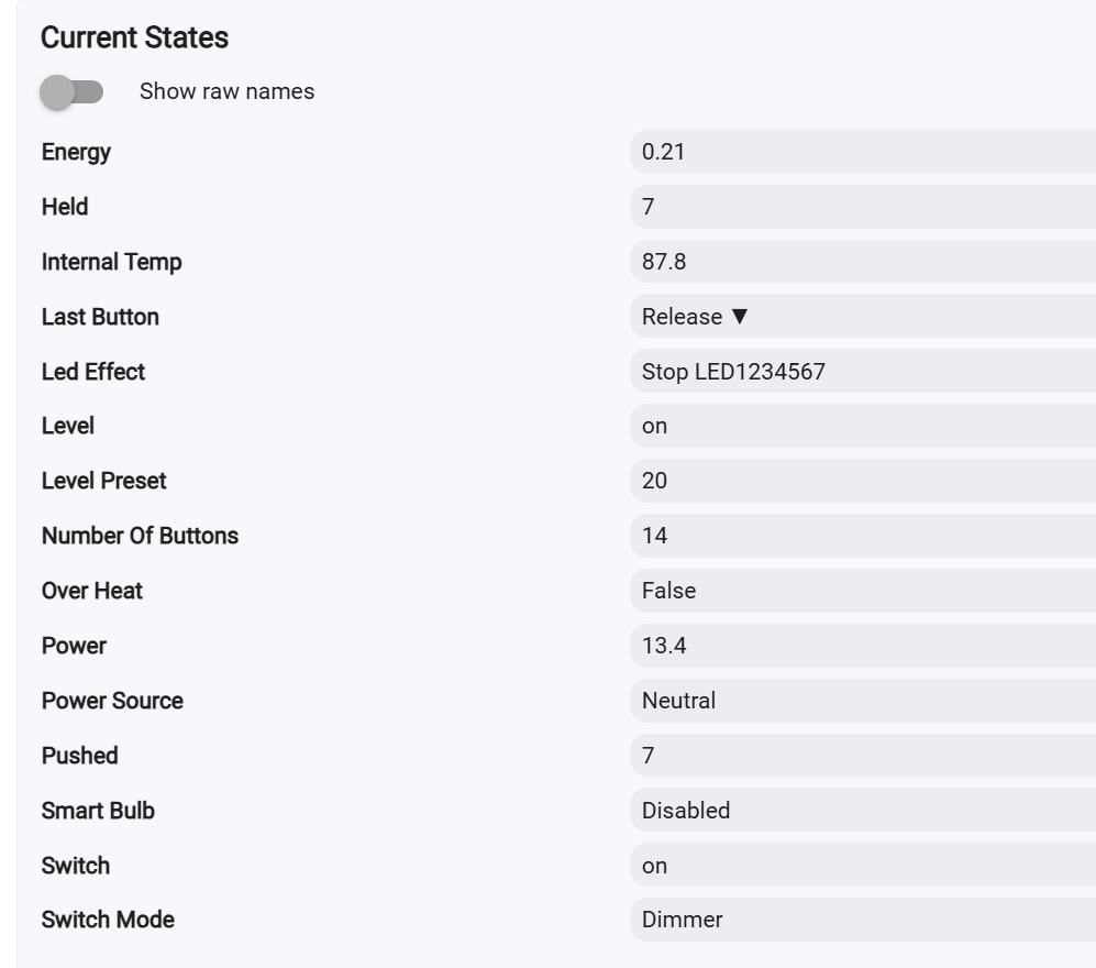

on C8 pro. I have an Inovelli red VZW31-SN. Its wired up with a neutral and looks fine on my zwave and set up as LR. Works fine on a couple tule machine where it sets to a certain dimming level when another button is pushed, physical switch works fine as well. Oddly cannot adjust the dimming level on the hub though. I cannot override the NaN. Set it temporarily as an on/off switch, then back to a dimmer but no luck.

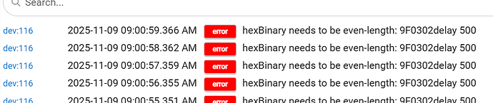

Any thoughts? see an error on the logs, have no idea what that means though.

i just changed to the Inovelli Z-Wave Red Scene Dimmer driver, can dim from the hub but lose all the cool paramaters.
I would ask Inovelli about the problem with their driver, as it appears to be reporting "on" for the level instead of a Z-Wave value 1-99. That's causing "NaN" to appear in the UI (meaning "not a number"), and it should let you overwrite that, so I'd be curious if a different browser or device helps, but I don't have a bad driver/device handy now to test that recollection for sure...
When does the error in Logs happen? That looks like a malformed command in the driver, but knowing where it's coming from would give them (assuming it's a driver problem -- this is unlikely to be a platform issue) an idea of where it could be in their driver code.

i played around a bit more this morning, I can override the level on Hubitat and set the value and switch adjusts accordingly, however the UI reverts back to NaN. Guess it doesn't really matter just kind of odd. I think this issue came up when I upgraded to newest driver version.
FWIW- i excluded the device and repaired, still same results.
That would be expected as long as this problem with the driver persists:
But glad setting it from the UI is working! I'm guessing they just have an easy typo or swap somewhere in their driver causing the above.
