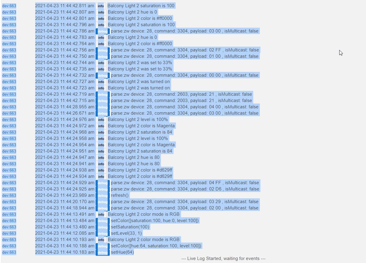

On a different bulb I used the device page to set hue 64, level 33 and saturation 100. It took several attempts but finally set. Then I went to another bulb but when I looked to check that bulb the one I just set was now red and I never told it to be red. Here is the log from all of that:
