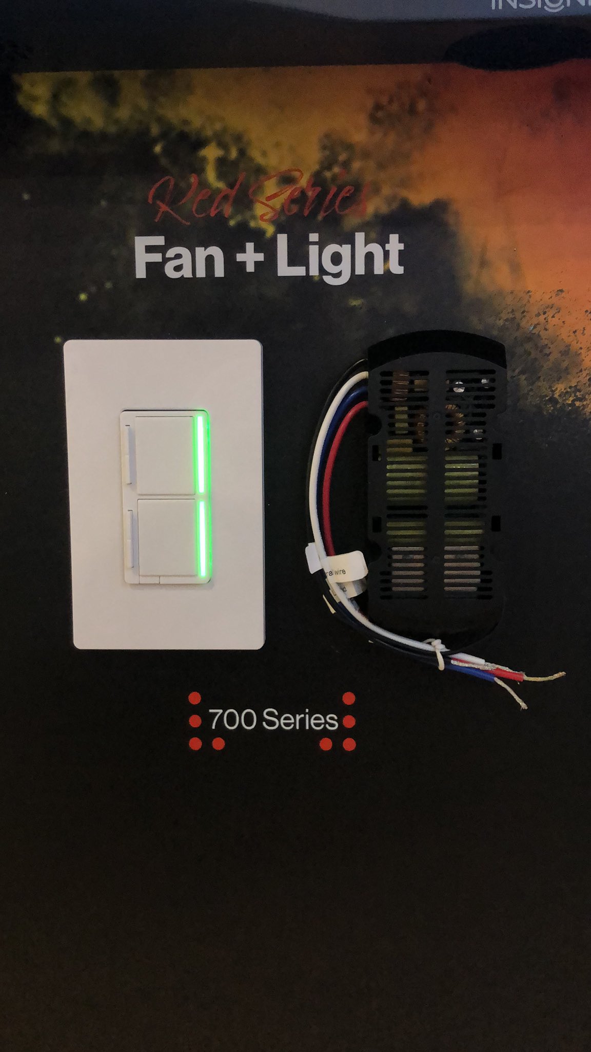

Inovelli Fan + Light Switch at CES2020
This looks promising and similar to the Lutron Maestro switches I used years ago:
Yeah, I'm looking forward to those, I have 3 of the Wink King of Fans modules (2 installed) but they have never been reliable 1 is still working now the other isn't and the last one I never installed because the first two where never reliable. These should work much better as the Z-Wave 700 module is in the switch rather than the fan canopy and the switch talks to the canopy via RF.
Not quite, unless you just mean in appearance. I never used the Maestro Light/Fan switch, but my understanding is that it needed a separate load wire for the fan and light. The Inovelli needs only one, which connects to the required canopy module, which then connects itself to the fan and light loads.
Speaking of appearance, it looks like the light and fan engraving they said the wanted are absent on the actual buttons. :slight_smile: I'm guessing that will be added later. Still doesn't look bad! I wonder if both LED bars are controllable separately for notifications and whatnot, and it's also not clear to me whether the scene events are generated by the large buttons (that would be my guess?) or the small buttons on the side (in which case there could be dozens total, haha).
