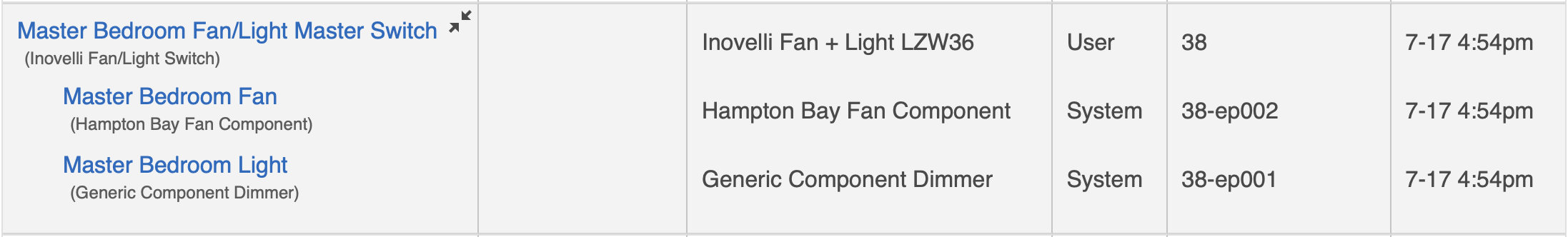

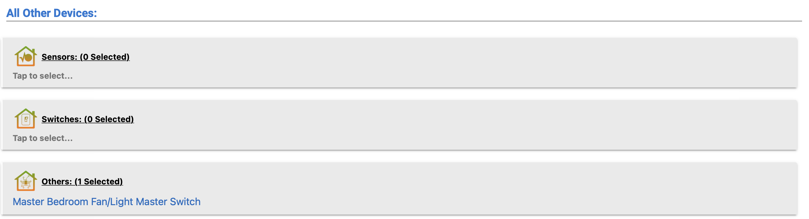

Here is my device configuration in Hubitat

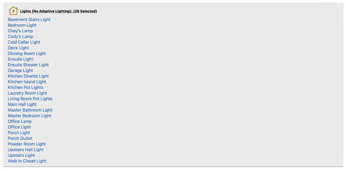

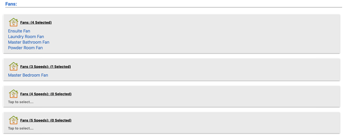

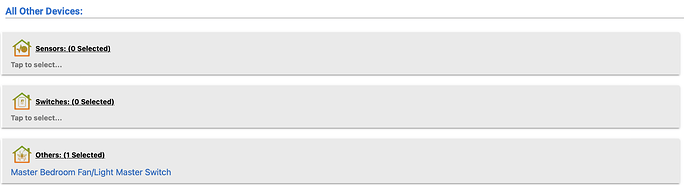

Here is my Homebridge v2
Master Bedroom Light = Inovelli Fan/Light Child Device - Generic Dimmer Component
Master Bedroom Fan = Inovelli Fan/Light Child Device - Hampton Bay Fan Component
Master Bedroom Light/Fan Master = Inovelli Fan/Light Parent Device - GitHub Driver

I have the bridge configured to 3 modes, and it looks like the child device driver "Hampton Bay Fan Component"

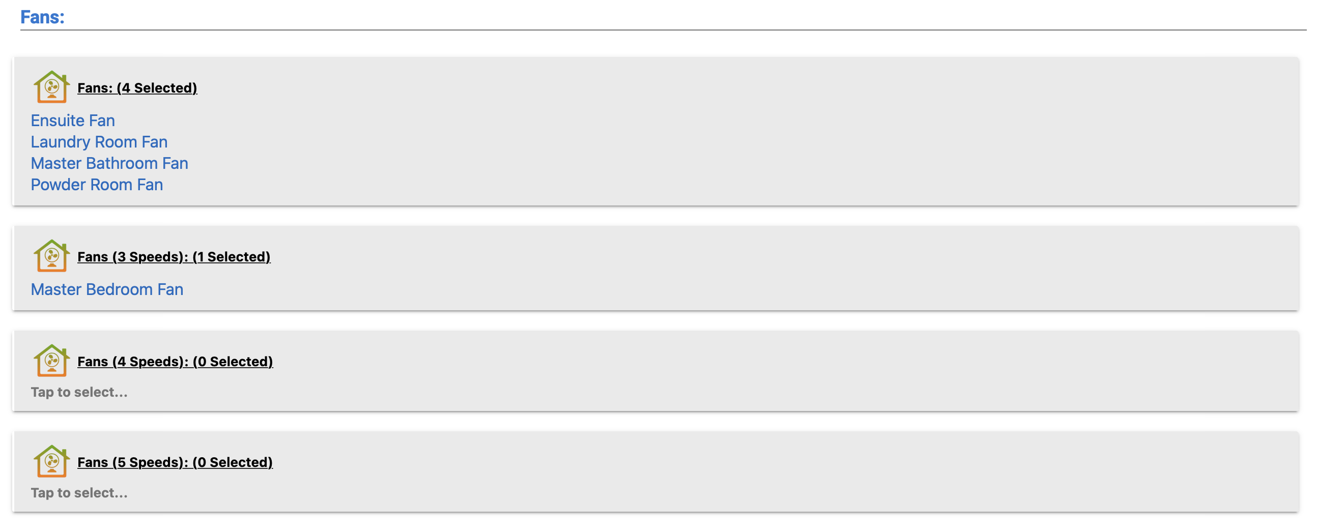

So the setSpeed function in that driver, medium-low, medium and medium-high all map to medium. The odd thing is that you have your fan specified as a 3-speed, but it seems to be using more than 3 speeds. Did you by chance have it setup as a 5 speed originally and then switch it? Try removing the fan from the homebridge app, wait for it to disappear from homebridge/homekit, then add it back as the 3 speed fan.

Ok so I tested this out, looks like the driver they are using the fan supports 5 speeds, and when you send it to homkit as a 3-speed it is not getting the correct 3 speeds as an option. It is getting medium-low, medium-high, and high. Not sure if this is an issue with the homebridge app or the plugin.
Found a workaround though, remove it from the 3-speed fan option, hit done until you get out the app. Wait for it to go away on homekit. Then go back and select it as either 5 speed fan, or under "others" at the bottom. It seems to work the same either way.

image|543x500
Sorry having issues doing images, I keep getting the error unable to embed media. Some times it works other times it doesn't.
