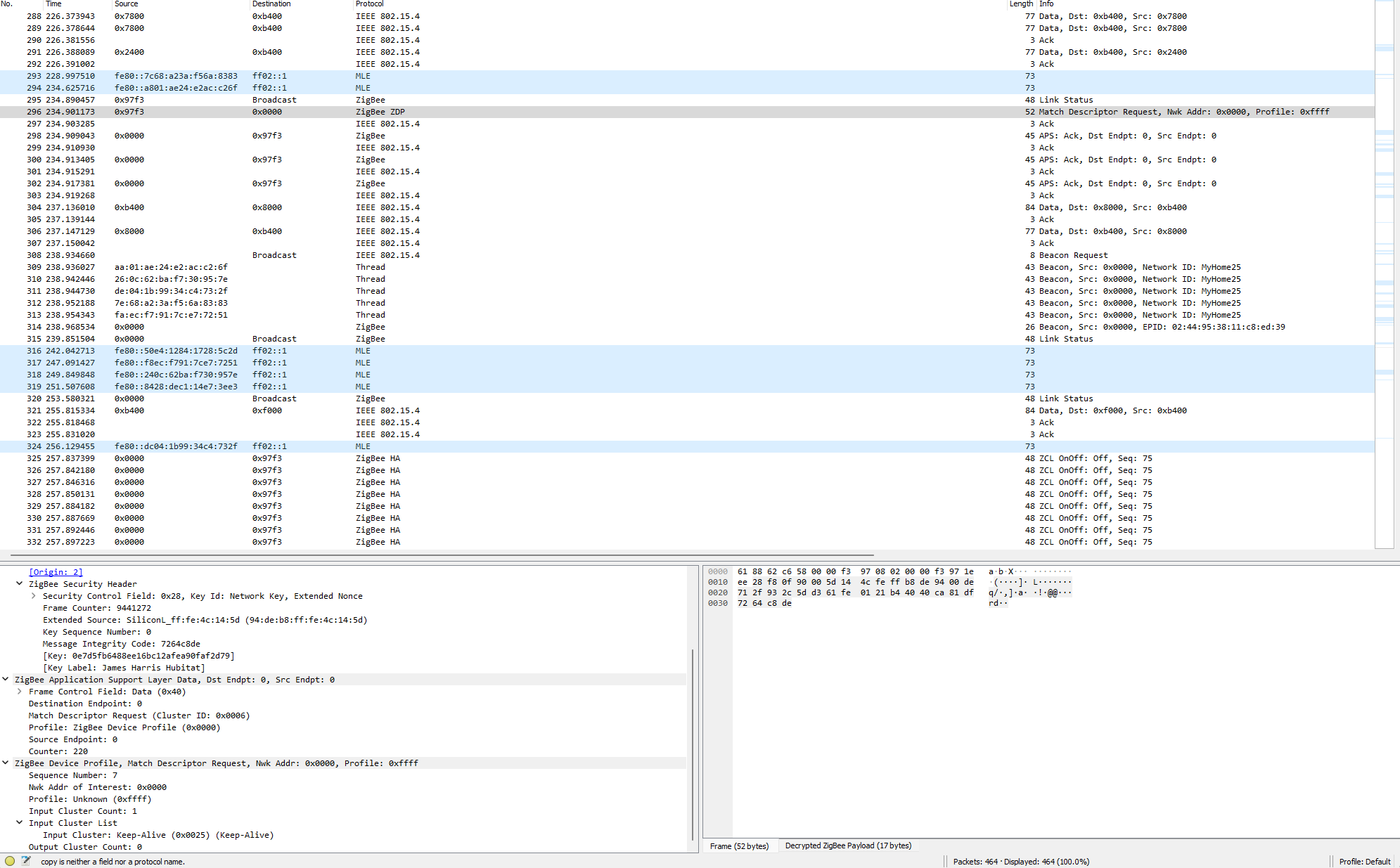

After 12 hours it seems that the switch is sending a keep-alive packet, but the process isn't quite working like it should for some users. Not sure if it is the hub or whether it is the switch. Haven't been able to find a common denominator yet but it is a small sample of users.
We have been testing a firmware that disables the keep-alive function when it is detected that the hub doesn't support it and that has looked promising.

Can confirm after sniffing packets the hub is not responding to the switches keep alive packet. The switches drop off the hub network and have to be airgapped to restore connectivity. Thanks to Inovelli’s @ericm for troubleshooting this issue and getting a solution resolved in a timely manner. Issues go away after the latest switch firmware.
