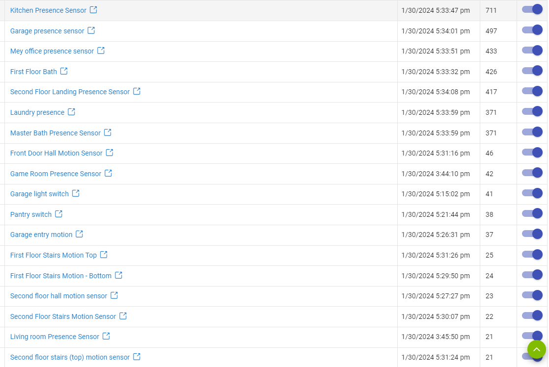

Reset the network, and disconnected 4 of the 13 presence sensors I have. Note i had no issues with these sensors being connected for about a month, and other devices are working fine. But I'm willing to try anything. This is the data after 2 hours.
So yeah most active sensor is the kitchen and its sending about 1 message every 10ish seconds. Others are sending about 1 message every 20sh seconds. Also air gaped all switches to see if i can see how long before disconnect

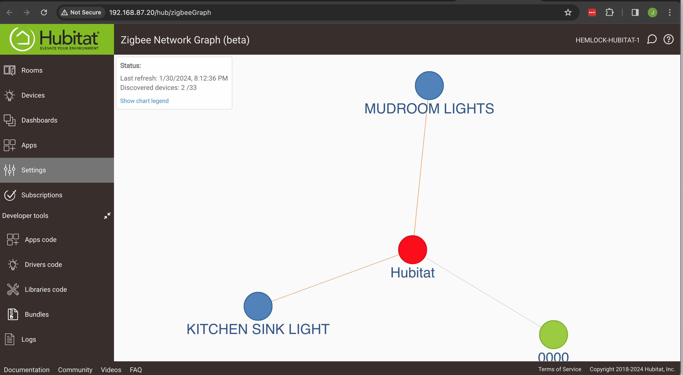

Does anyone know what the 0000 node appearing for? Other (working) hub does not have a 0000.

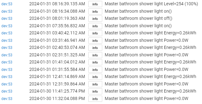

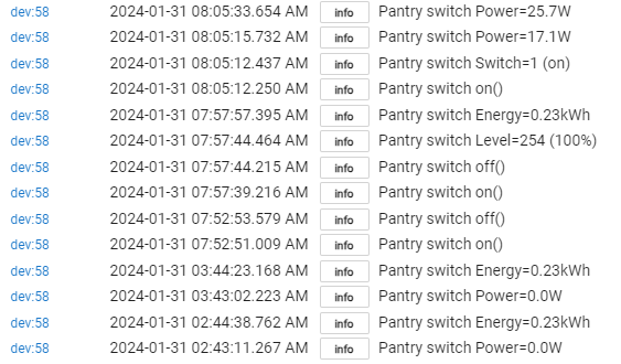

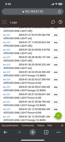

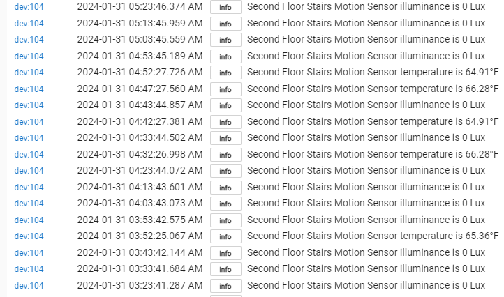

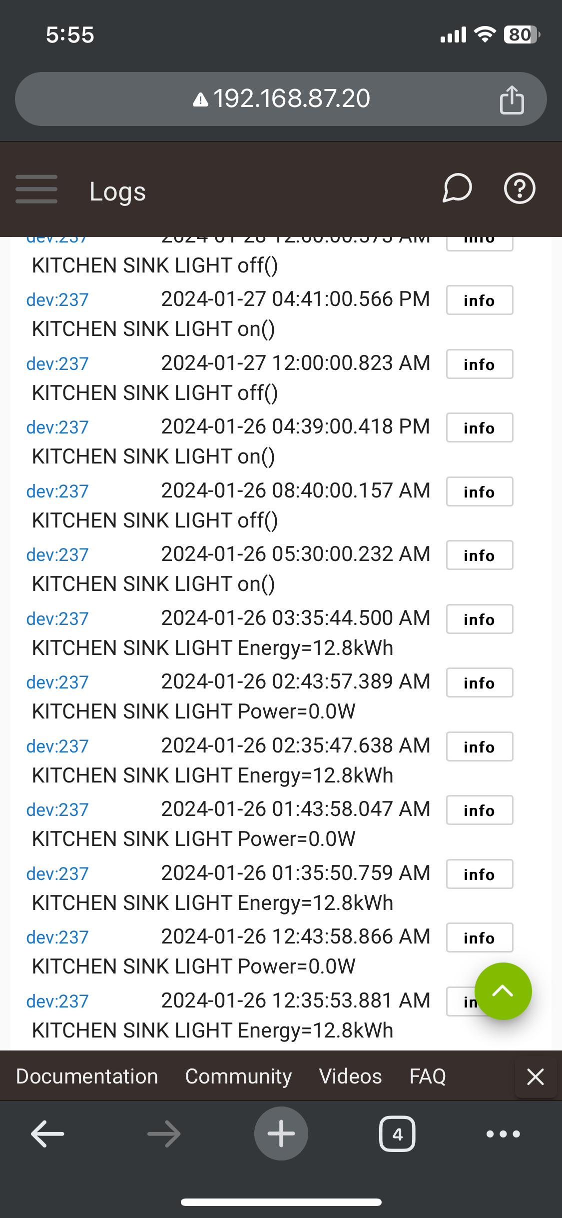

So looking I found the following from last night. Looks like the blues are reporting their power level every hour. I see in the logs for two devices that they check in at 3:43 am, then do not check in again until i woke up and started testing to see if events would trigger. Looks like all the devices died at this time. Also looks like ikea blinds stopped reporting around the same time. I feel like around 4am something is happening with the zigbee network, like it reboots/refreshes something and the invoelli devices are not reconnecting when ever that happens, while all the other devices are.
Device on First Floor:
Device on Second Floor:
Hue motion sensor:

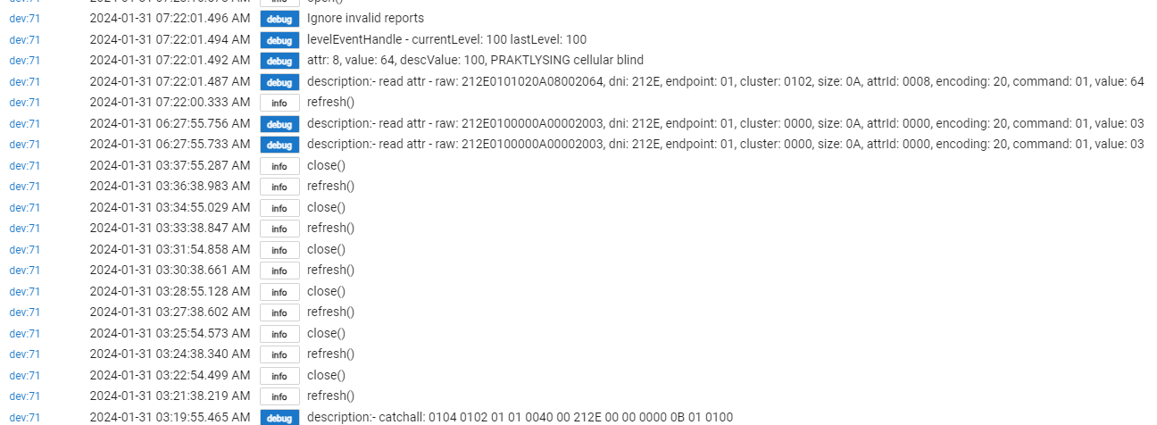

I did find this just now which is interesting. I'm also having trouble with my ikea blinds, but they have been an ongoing hassle. I have a rule that is set to repeat until they all report as closed (they are closing just not reporting correctly). Apparently my catch failed last night and kept sending the commands to close from basically sunset until 4am then stopped... which happens to be same time that the inovelli switches stopped reporting, then started reporting again when my open command started initiating.
