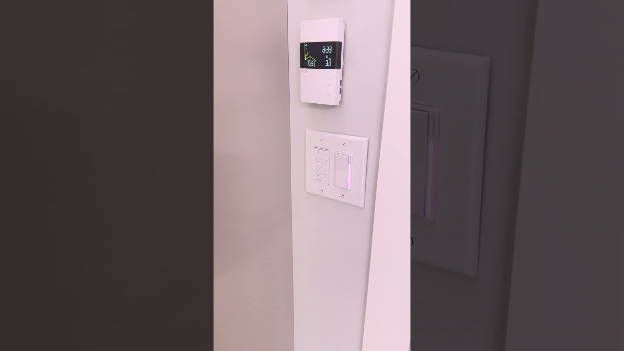

When I've been able to catch an OFF-ON event, I've seen the LED bar briefly turn yellow (a color I don't use for indicators), and it may have been flashing as well.
In my case, one of my on/off switches was crashing and bringing down the whole zigbee mesh with it. So when that switch crashed, all others did as well. I was able to trigger the crash by initiating a Zigbee pairing on any of my hubs.
To uncover the culprit, I first pulled the air gap tab from all of them, then initiated pairing. I then pushed the tab from one of the switches, re-started a few pairing actions, then repeated…
What I found though is that the problematic switch didn’t always crash at first… I usually had to do a few pairing start actions, and wait a bit before it got triggered. Since I found the problematic switch, none of them have rebooted.
Here’s what it looked like when the crash happened:
