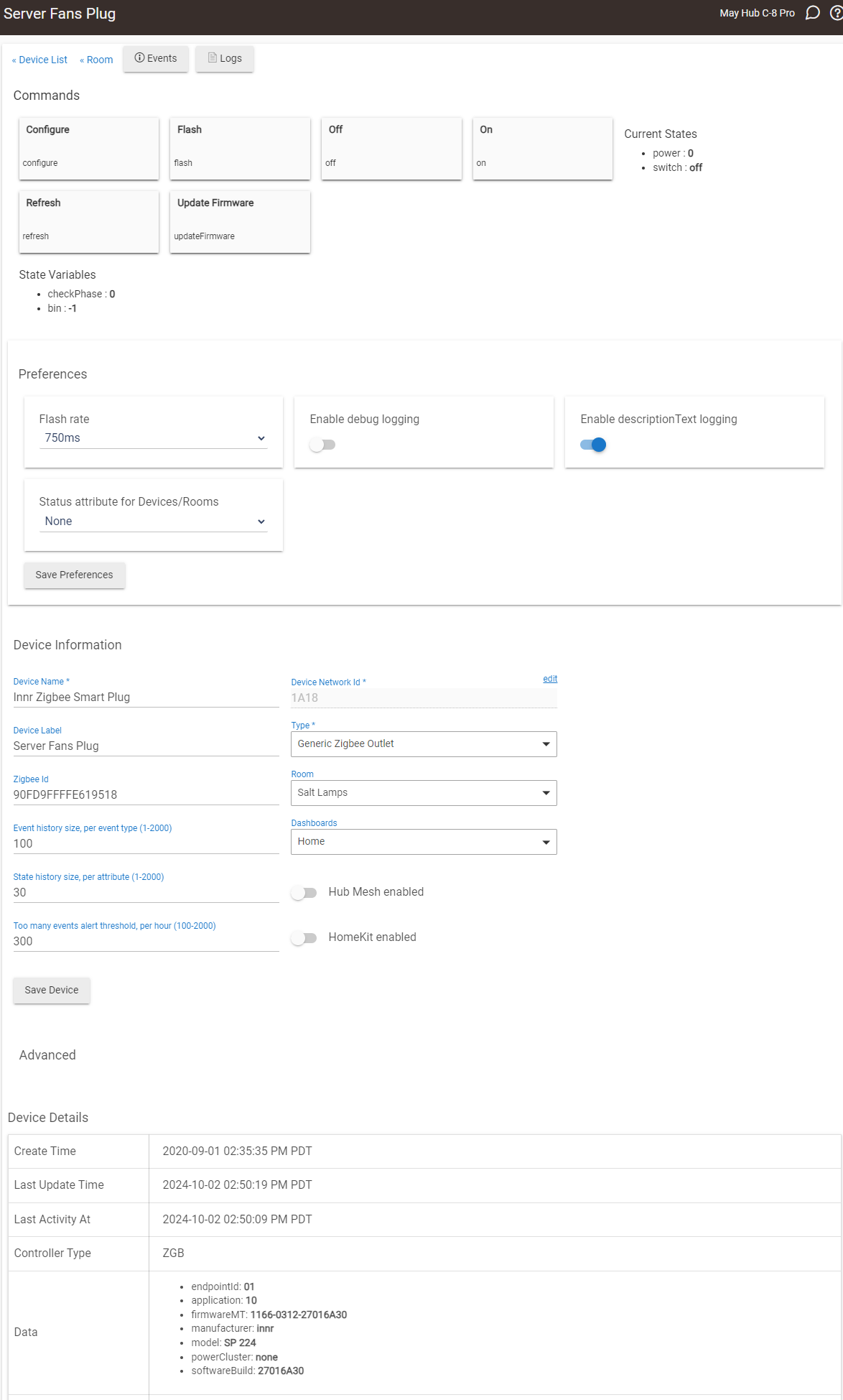

Having an issue getting the ability to monitor the power with my smart plug. I had just updated my SP224 smart plugs to the latest firmware about an hour ago.
The firmware was sitting at:
  • endpointId: 01
  • application: 10
  • firmwareMT: 1166-0312-10046500
  • manufacturer: innr
  • model: SP 224
  • powerCluster: none
  • softwareBuild: 10046500
But with the new firmware, it's now at:
  • endpointId: 01
  • application: 10
  • firmwareMT: 1166-0312-27016A30
  • model: SP 224
  • softwareBuild: 27016A30
I noticed that the details page for these smart plugs doesn't show any power monitoring, unlike others I've seen. I'm using the Generic Zigbee Outlet model. Is this feature supported?
Here's a full page screenshot of what the smart plug page looks like:
Please note that toggling ON the switch does not change the power value.
Hi, the SP 224 does not have power monitoring.
I saw your post yesterday, but I totally mis-read it as "244"... But Gerry's right -- the 224 has no power reporting -- just the (now older) 234 and (latest model) 244 models have it.
I have a bunch of 224s and a couple 234s -- I use the "Generic Zigbee Outlet" driver for all them, and it works great.
All of my 224s have that same latest firmware you posted, and the Current States section looks the same too (all show "power: 0").
