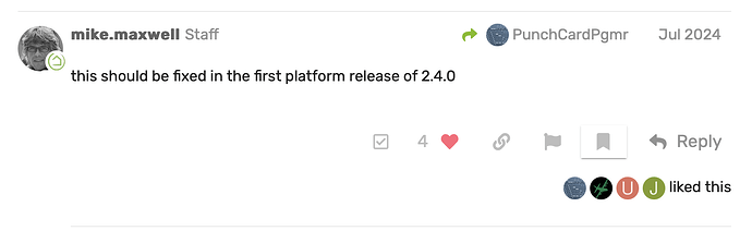

Reporting on power reporting in this plug: it's working but is off by a factor of x10. It reports 1 for 10W+ load, 2 for 20W+ load, etc. Which means it's always 0 for under 10W devices. There is an Amazon review saying Innr has confirmed a divisor parameter is incorrectly set to 10, presumably somewhere in the firmware.

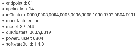

EDIT ADD: For those coming here late, the 1.4.3 firmware is NOT the most recent version. I screen captured a plug I had not updated. Sorry.
Hi @virtu789 not sure what FW version your plugs have, but like @PunchCardPgmr wrote, please make sure you're on the latest version published on Hubitat (or zigbee2mqtt). There have been multiple improvements including in the Zigbee stack.

Here is my data - the software build is the same as what @PunchCardPgmr posted above - does it mean I'm on the latest firmware? In fact everything is the same expect the PowerCluster value for me is "none":
If Hubitat actually has that latest firmware available (I don't know if that's true or not), then yes.

I'm just gonna mention that I updated to 2.4.0 last night and yes, 2.4.0 - with my legrand outlets - DOES fix the "off-by-10x's" issue. What it does NOT FIX is off-by-10x's in my INNR 244's! I have one reporting 6w (on a fridge! I KNOW the fridge is NOT using 6w's)!
So, umm... I don't know what to think.
