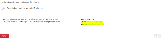

Open the app page, and scroll down towards the bottom.
You should see an area that shows if the necessary javascript and stylesheet are loaded correctly. What does yours say?
I used HPM, and there are no JS and CSS (file not found)...
UPDATE: I removed and reinstalled RMM. The installer specifically called out downloading the JS and CSS files... But it still says "not found"!

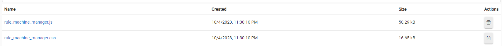

If you browse to your file manager on your hub (settings -> file manager), do you see something like this?
No, neither file is there...
Not sure what the installer is doing, but it's clearly NOT installing the JS and CSS files, despite claiming it is doing just that!
Copied them manually, and now it works...

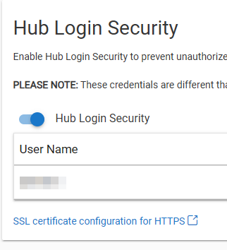

Quick question... you mentioned hub security is enabled.
Do you also have the option to use SSL enabled (just below hub security in settings)?
You mean this?
(I haven't enabled SSL, because my traffic is limited to the LAN only, so I have no urgent need for encrypted traffic towards my hub)
That's what I needed to know.
Thank you!

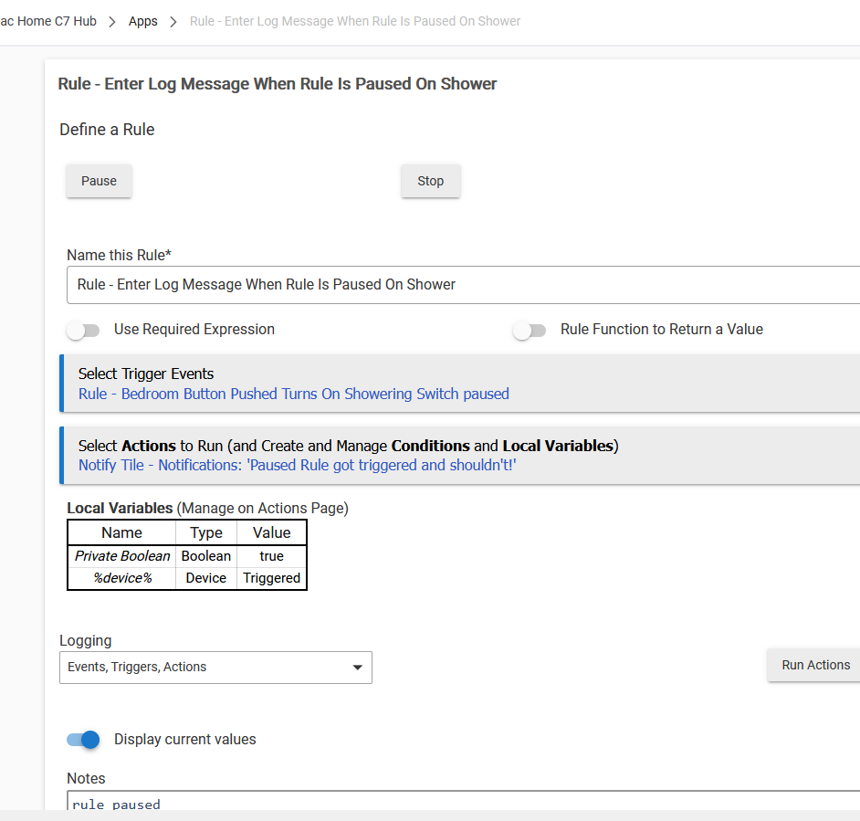

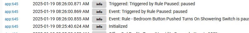

I have a rule that generates log event for paused rules - likely not helpful but I offer it as a way to verify the pause is exposed somehow...
What does your rule look like?
