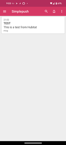

Myself and @bptworld have worked on an Initial Release of our Simplepush App/device handler.
What is Simplepush? - It's Pushover but has the option of actionable replies, the only difference is Simplepush is £/$12.49 per year for unlimited messages, there is a free tier but it's so limited with only 10 messages per month it's useless. Custom ringtones and alert levels are handled by event IDs which you make in the simplepush app.

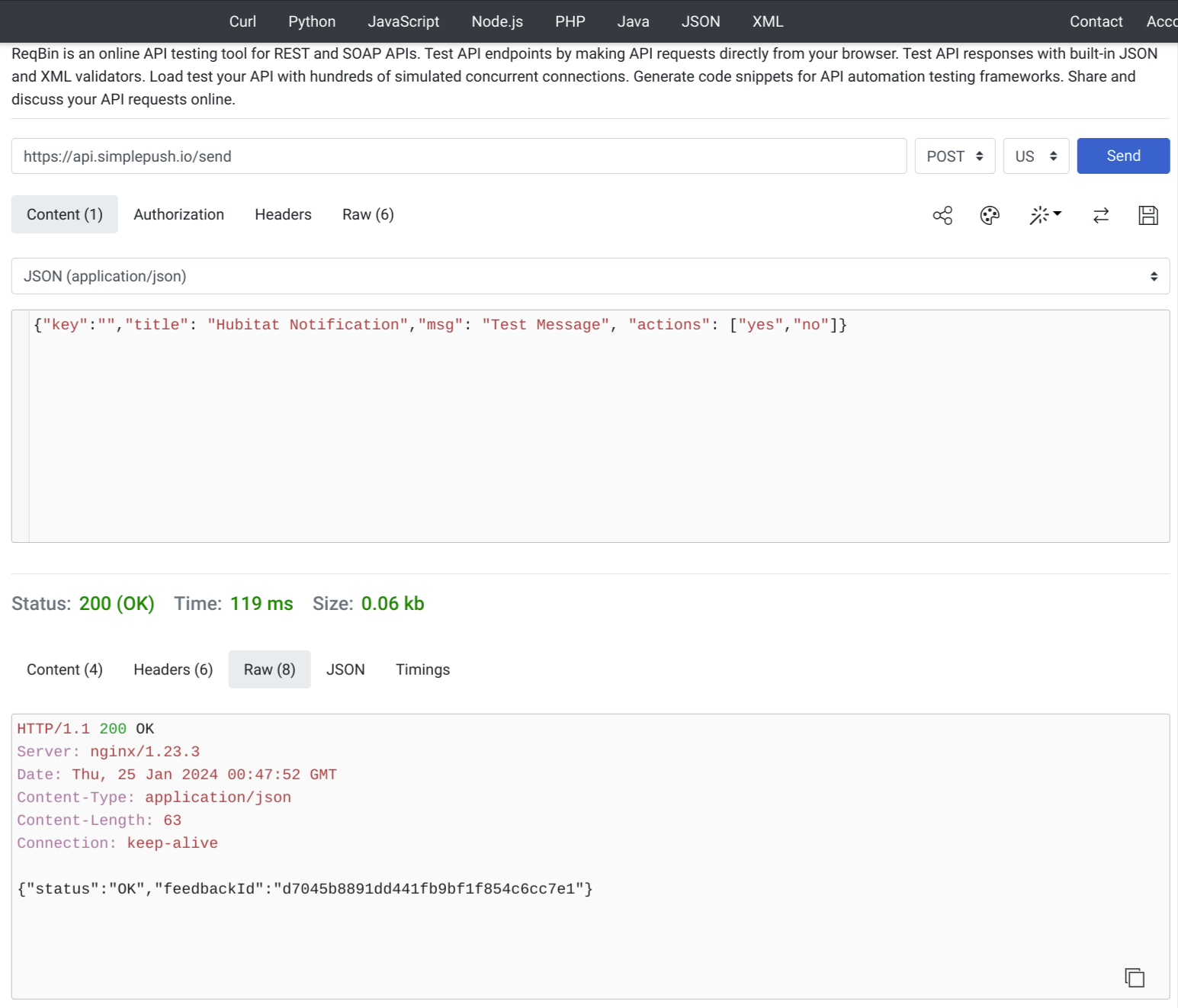

To install it requires an app and a driver to be installed due to needing OAuth to handle the replies, you have the option of creating virtual devices for each question you need to set up which can be used in RM using the deviceNotification command
Use with RM
Use syntax 'Title:Message:Actions:Event'.
ie. 'My Title:This is a Test:yes-no:silent'.
If a field isn't needed use 'na', do not leave a field blank or missing.
or create one device that can be used with multiple WebCoRE pistons.

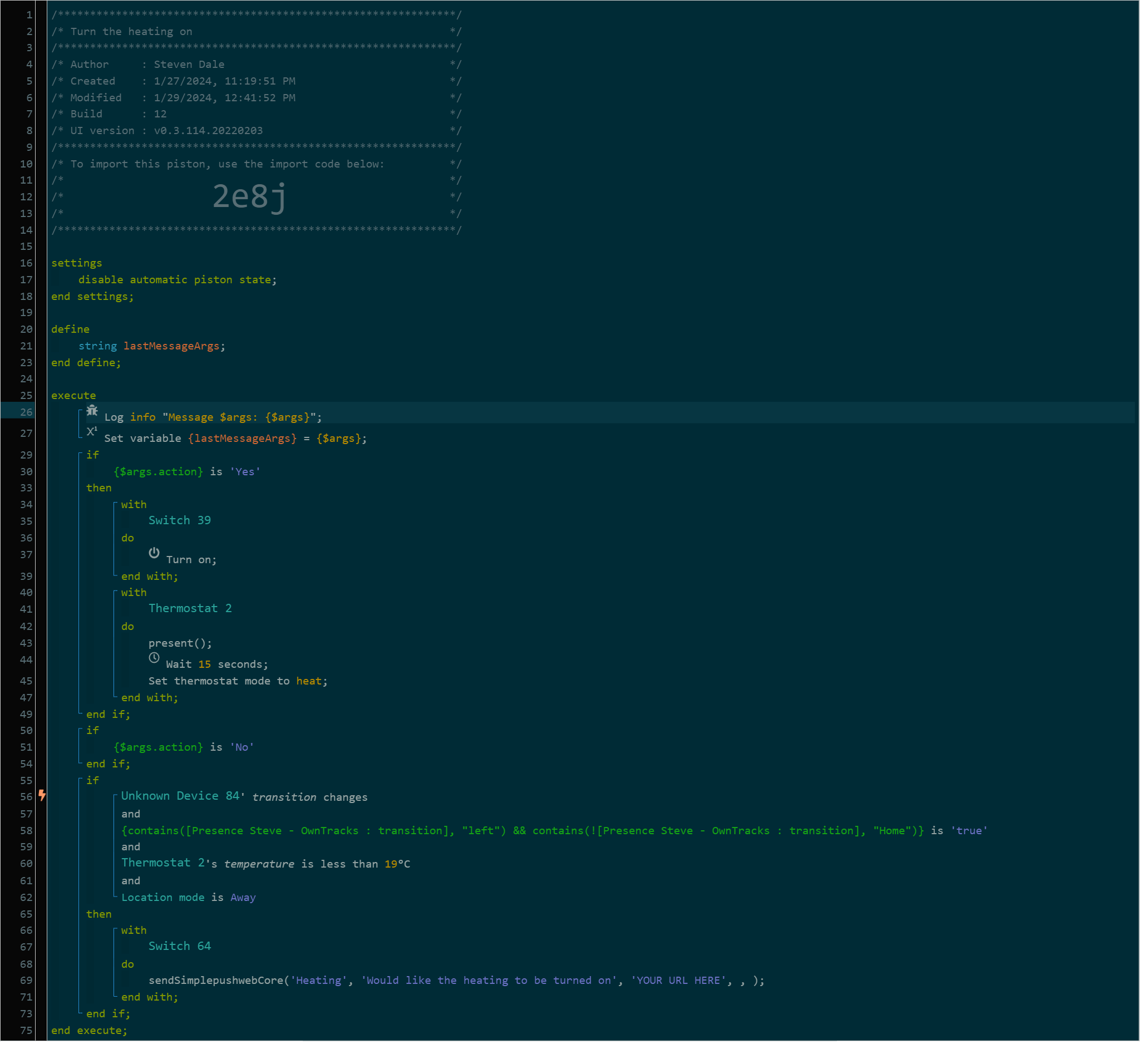

An example WebCoRE Piston asks if I want to put the heating on if I leave any of my regions in owntracks.

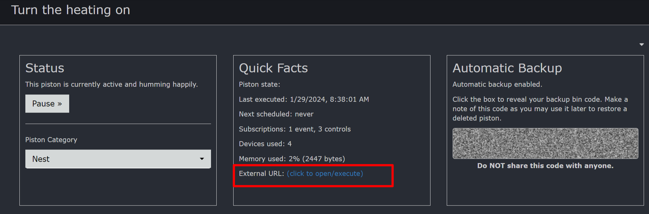

Copy the URL for the piston from here
And just add under yes and no what you want to happen
