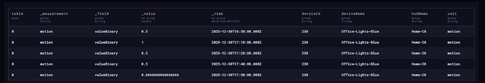

Happy to see my events in the db.

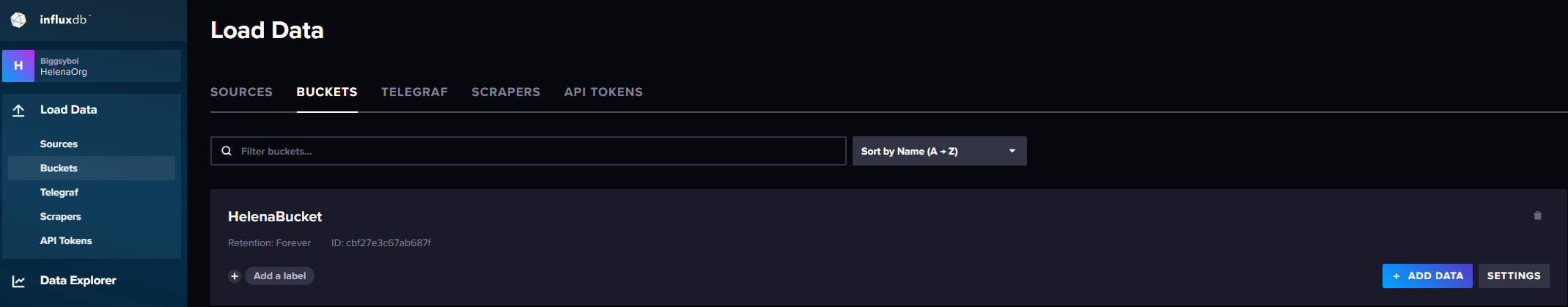

I'm really struggling with this and I'm wondering if someone could lead me in the right direction.
Hubitat Hub and the QNAP NAS InfluxDB is running on (via Docker / Container) are on the same network.

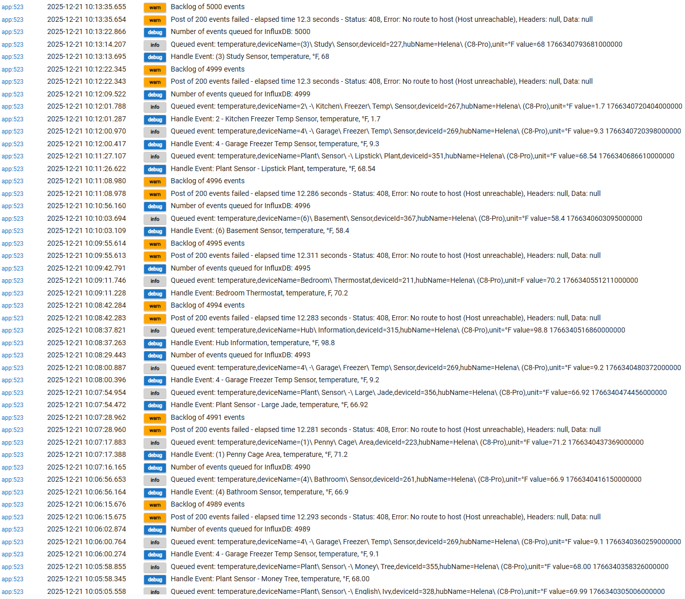

I'm always getting:
Post of 200 events failed - elapsed time 12.284 seconds - Status: 408, Error: No route to host (Host unreachable), Headers: null, Data: null

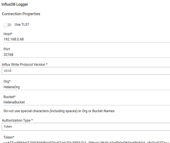

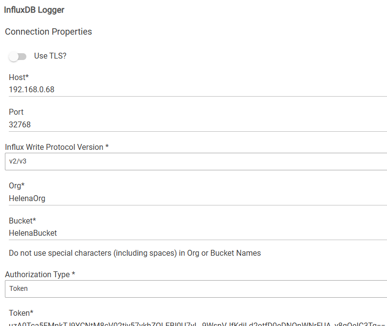

Showing configuration for the app would be the first step in seeking connectivity help...
FWIW, your URL is likely wrong, but I can't say for sure without seeing your configuration or your log entry.
Yes I should have posted the configuration :rofl:
But the log entry was already posted (I think there is only one relevent line, looking at it, and it's the error saying the host is unreachable)
Assuming the logging setting allows it, the URL is logged when you save the app. I recommend you keep it at Info or Debug until you have everything it working.
I don't see the immediate problem in your config. I suggest you set app logging to Debug, and post the actual log entries both from the save and from post attempts.

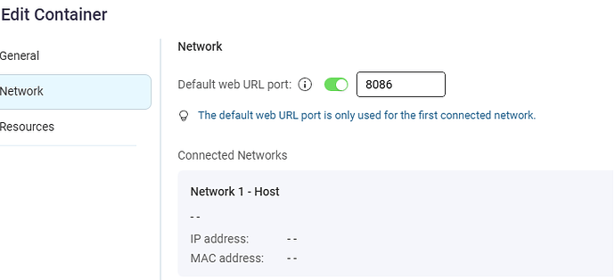

One item of note: Although this should not be your problem, I do not recommend using port 32768. You should use 32767 or below for static ports. FWIW, I would use the recommended 8086:8086, or use host native (which will also be 8086).
Earlier you said
What do you mean "set up a routine"? Is this on the same hub as InfluxDB Logger? Is this code you wrote?
I haven't run InfluxDB in docker for a couple of years, but I'm sure someone else in the forum does...
Thanks for your help! I can try changing the port to 32767 and then 8086 and see if that changes anything and report back soon
Sorry I called it Routine, I meant Rule, on Hubitat, to check if the Hubitat could communicate with the relevant IP address / Port.
I have the InfluxDB Logger app set to Debug logging, but I don't see any information in the logs that are of use:

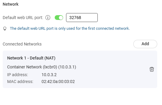

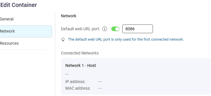

There's not much you can change on a container in the QNAP UI seemingly:
Above are the only editable settings, you can do a bit more if you delete the container and start from scratch.

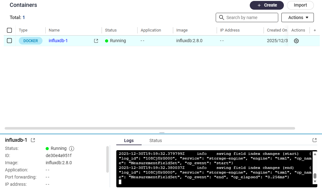

Container Logs from Container Station / Docker

Did you create the database on the InfluxDB side of things?
I have only used InfluxDB v1, and I know I have to manually issue InfluxDB commands to create the properly named database. It sure if that is the same on v2 or v3 of InfluxDB.
[IMPORTANT: Until you get this working, I would highly recommend setting Backlog size limit to a small value like 100. A backlog size of 5000 will have a significant impact on your hub.]
You can/should set it back to info.
When you save the app, it generates a log entry that looks like this:
app:17 2025-12-21 08:50:08.385 info InfluxDB URI: http://influxdb.mynet.com:8086/write?db=hubitat
That's what I was looking to see.
I don't have a QNAP, but one thing that I would be concerned about is the phrasing "Default web URL port" which might imply that the QNAP container system is doing some sort of validation on the http connections. InfluxDB uses POST rather than GET, which the QNAP firewall may not allow.
I have an 'Organization' and a 'Bucket' created in the InfluxDB side, this is my first time using InfluxDB but it gives you the option to make these on first log in
I previously created an allow-all rule on the QNAP firewall for the Hubitat's IP address, it still didn't work but since you mentioned it, I tried disabling the firewall completely and it's still had no effect.
I've now reduced the backlog size as advised, thanks :slight_smile:
Have you tried host native networking for the docker container?
Perhaps you should set aside Hubitat for the moment, and use curl or some such to test remote posting of data.
Hmm... reading here, it suggests that the port is wrong, and should be 8086:
Setting Action
Default web URL port Enable this setting and specify a port number.
This should be the container port and not the published host port. For example, entering 80 for an NGINX container or 8080 for a Jenkins container.

Thanks so much for your help so far, I've been hosting family for Christmas so still working on it.
I gave up with the using alternative port, and tried it using port 8086 as suggested, and I still was getting the same error.
The web UI would be reachable at 192.168.0.86:8086, but still getting the 'Error 408: host unreachable' message in Hubitat.
So I deleted it all and started again using the 'host' / native network setting, so IP address of the NAS and port 8086 - again, the web UI is reachable, I can create an organization and bucket, and I copy the API token over into Hubitat, but still get the same error!
I'm guessing the command line suggestions are from people using SSH or something? (There isn't a command line interface in Container Station on QNAP)
Can you verify the IP address configured i the Smartapp on the Hub. Scanning through the information you posted above i see where it looks like the hub software is set to 192.168.0.68 and the every other reference is 192.168.0.86. Looks ike you swapped the numbers in the last octet.

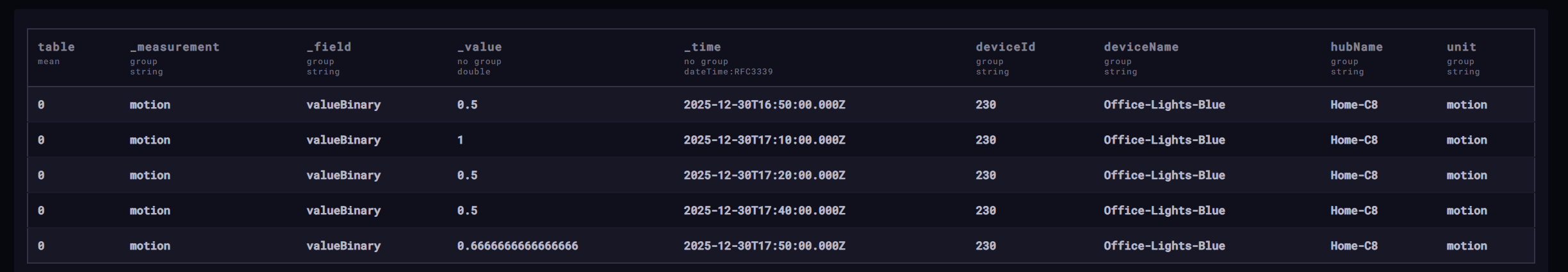

I have found something interesting. I have the Inovelli Blue mmWave switches and started to log the motion attribute to my InfluxDB instance to track. It shows up a as a Binary value but I am getting more than just 1's and 0's. This is the first time logging a motion device and wonder if others have seen this:
