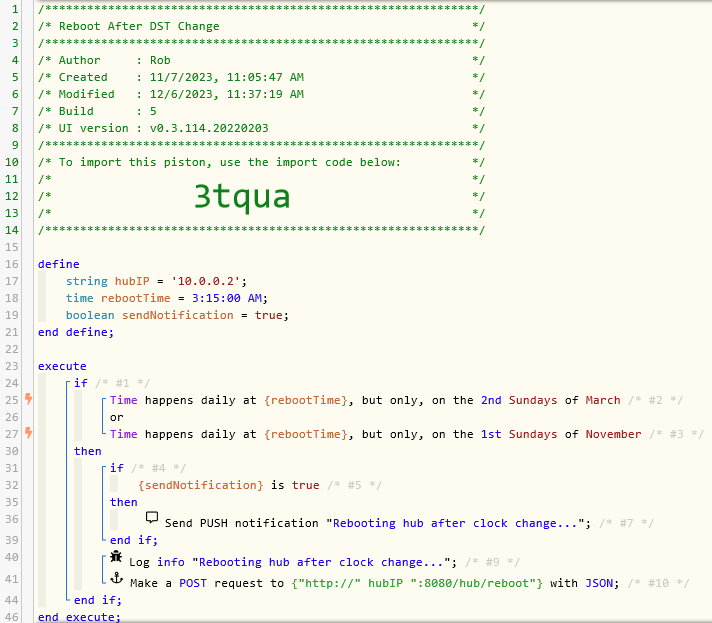

If anyone is interested, I made a small piston to reboot the hub after Daylight Saving Time changes. Just modify the variables at the top to your liking. When I saved it, the scheduling appears to be correct. ![]()
Next scheduled: 3/10/2024, 3:15:00 AM
(Edited to update piston snapshot. Forgot the hub port in URL.)

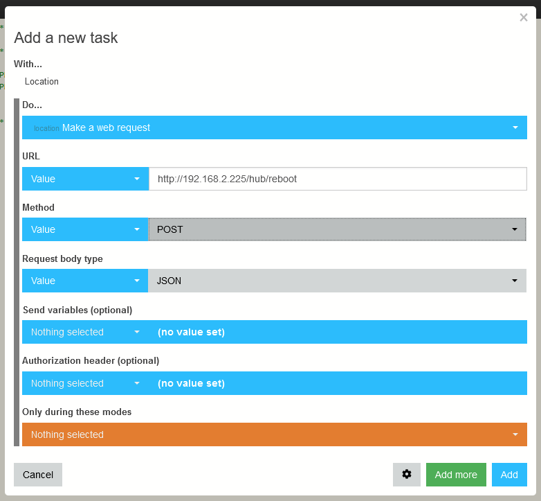

Thanks for this idea. I updated with my hub IP address. But I tried this piston, i am getting an error message in the logs:
http error Response Status: 408 error Message: Connect to 192.168.2.225:80 [/192.168.2.225] failed: Connection refused (Connection refused)
Is there something I need to do to allow the hub to accept this Post command?

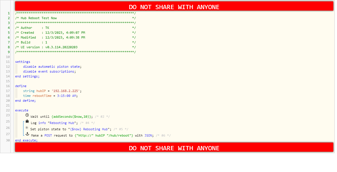

BTW, I tried to import your piston using the Import code, but that did not work. Any issues with that that you know about?
Here's my piston:
Not a webCoRe user here, but in RM I have always sent my reboot POST commands to port 8080.
I think you're right. I'll update my piston example above... after my hub is done rebooting. ![]()
Port 8080 worked. Thanks for the help.
