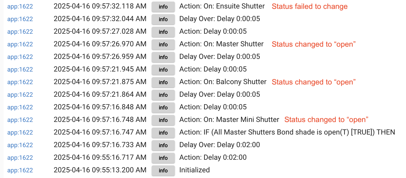

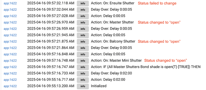

Rule Log:

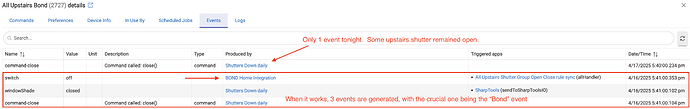

Here is a scenario from tonight. The All Upstairs Bond shade is a single channel that closes all the upstairs shades. The command to close was issued by the RM action and a single event generated on the Events tab of the "All Upstairs Bond" device. There should be 3 events always, with the critical event being the "Bond Home Integration" event proving the command was sent to the Bond Hub. The end result was the All Upstairs group status changed to "closed" on my Sharptools dashboard but shades didn't close.
Another variation of the issue - The All Downstairs Bond ran successfully and produced the 3 events:

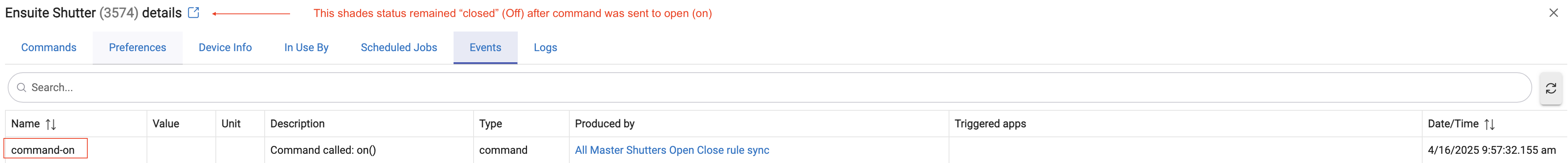

I have another rule that closes each individual shade (after a delay) once the "All downstairs" group closes, to ensure the open/close status is kept in sync. That RM rule ran, but again it only generated the 1 event for the Theater Shade:

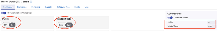

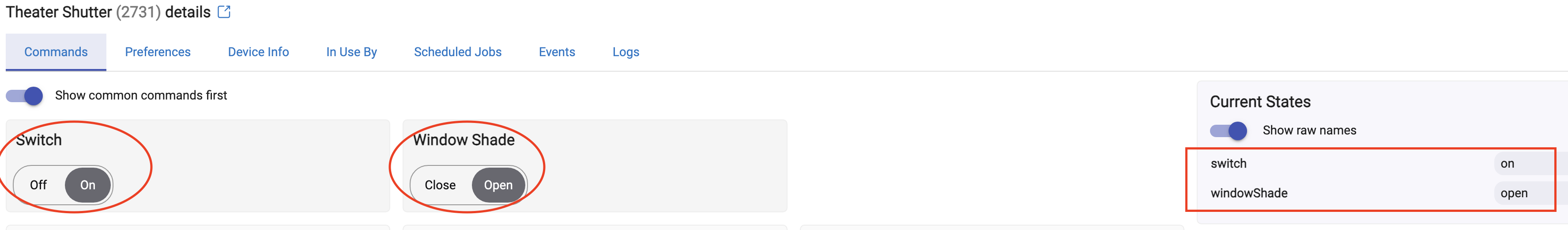

The end result was a shade that was closed by the ALL Downstairs Bond group device, but the actual device page for the individual Theater shade showed otherwise:

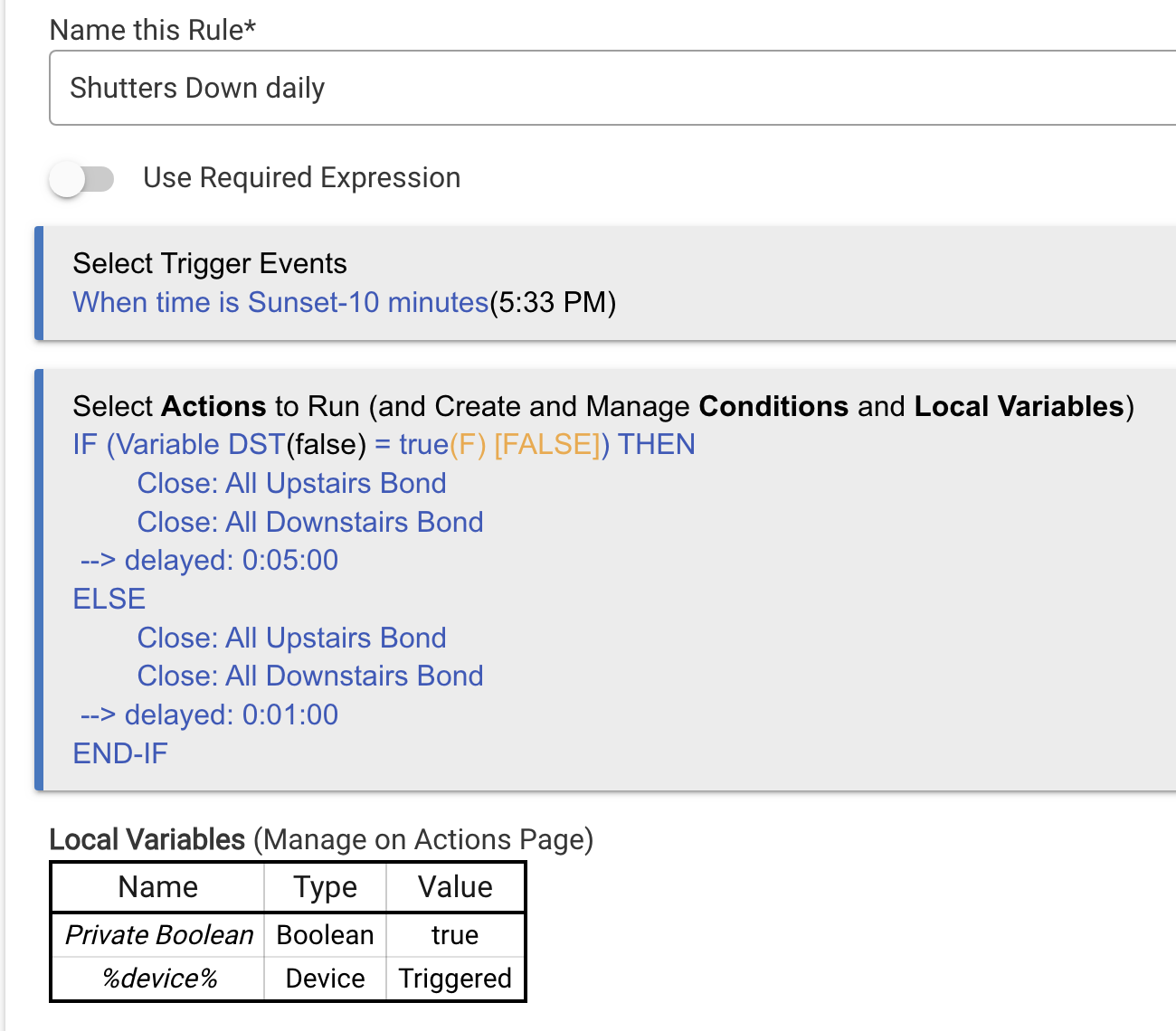

There was a few changes to Rule Machine. If that app is involved maybe post some screenshots of the impacted rules.
It does look like your rules are running though, according to your event logs. So very strange issue indeed.

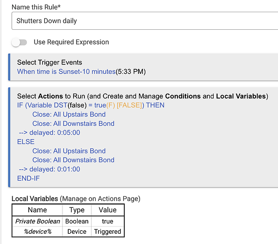

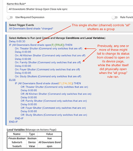

Here are 2 screenshots from 2 separate RM rules to illustrate what typically happens each day. First this rule runs to close all shutters as a group:

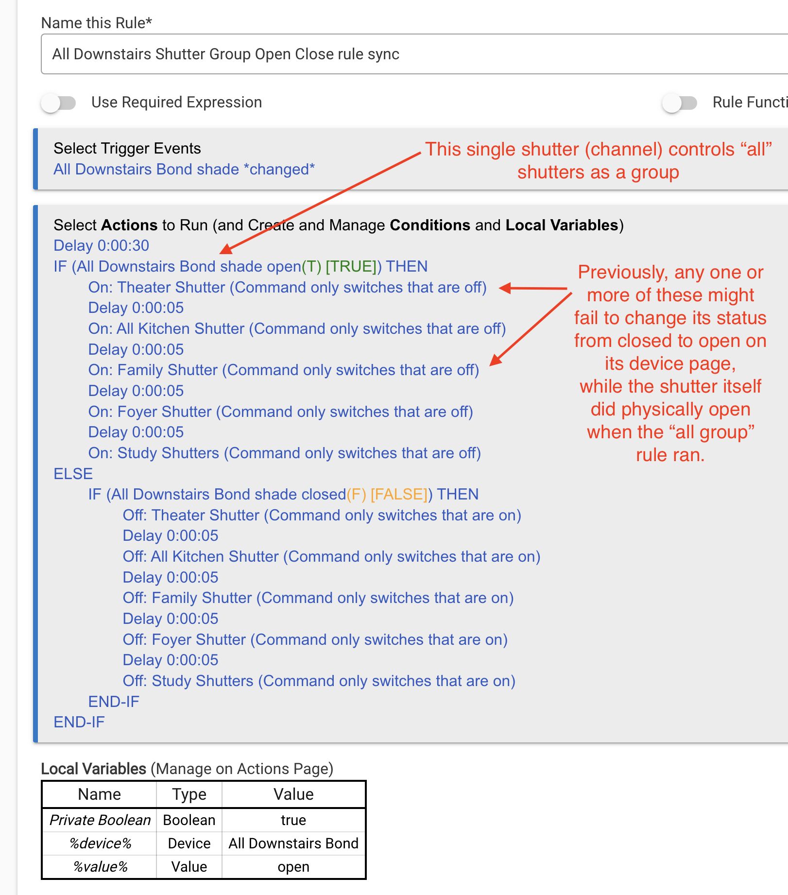

The "all group" device status changes to "closed" as expected, but you are left with the individual shutters in Hubitat as devices which are now out of sync on their open/close status (due to the fact that RF shutters do not provide 2-way feedback to advise of their status). So this 2nd rule is then triggered which effectively sends a second "open/close" command to each shutter and therefore changes its status to "closed":
So the 2nd rule is the one that has issues when on 2.4.1.x
If that second rule runs and you see the 'command-close' event on the device events tab then the rule worked as expected.

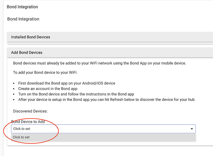

Its always been the user Bond app from 2020 (Dominick Meglio) for the last 3-5 years for the Somfy RTS roller shutters and 2 RF fans. I may have started with it if it existed before any built in app and just stuck with it. I'm also using the original Bond Hub v2.56.1 (the one without the ability to do schedules) and when testing to try add it using the built-in app, it can't find it:

The built in integration uses a newer API for the bond hub which eliminate the polling. You can have both integrations running at the same time, so you could test switching one rule over to the new devices to see how it works.
Not sure why it wont find it. Is there no way you can update the firmware on your bond hub? The system integration might also rely on mDNS or some other discovery method to find it, may be getting blocked in your LAN or something.

I thought it couldn't list it because it was already part of the user integration...
